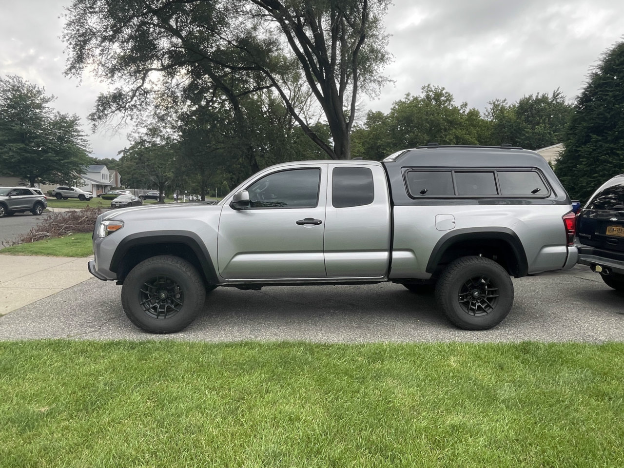

    Sure is ARE MX with windoors makes the truck a heavier brick in the wind but its the best thing i got for the truck. I will never own a truck without a topper changes how you can use the truck completely
