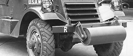

    Ignore that these are not 235/85R16.
    But check out the tread design. I'm very curious how well these performed in ALL conditions.
    (the White Scout Car hit inventory in '41, by '43 it had lost appeal due to many factors, including the open top design and "poor offroad performance". would imagine weight & size had more to do with that than tire traction.)
