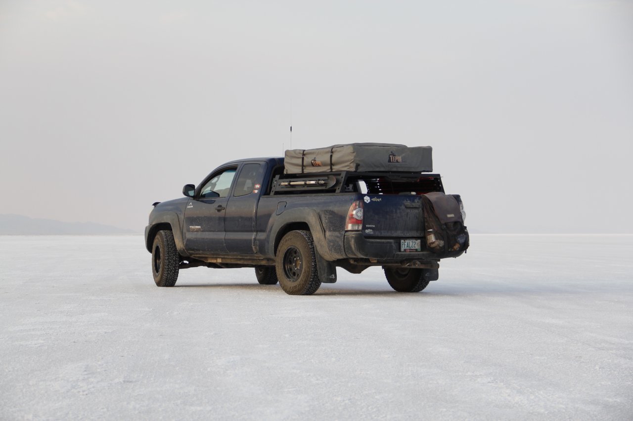

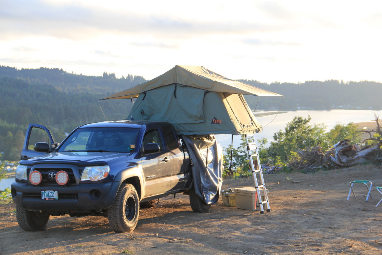

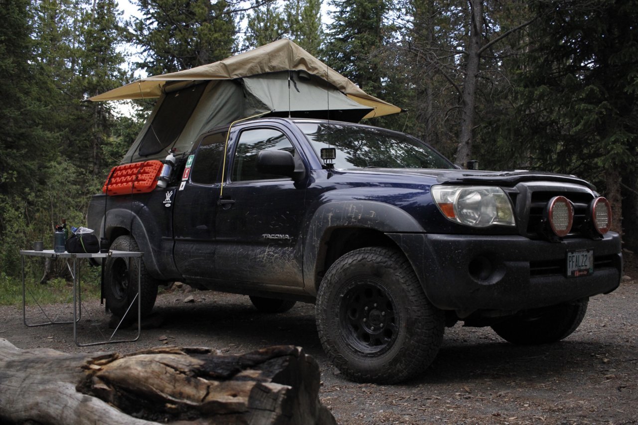

    Best tire size ever. 512678BD-4C7A-45EF-9D77-FBC054424A52.jpgB790D183-E0C0-4699-9ACD-66884A0F0CCD.jpg912F8650-7245-4B74-8993-04841CF0C12C.jpg

    What wheels are you running? Any lift? Any rub?

    If you are running a 4cyl and weight is an issue run a light wheel...in my case a KMC enduro alloy (don't make those anymore I think). Gas milage was a huge concern for me and im very happy with the setup. 235s are generally LT tires so they are heavier (some would argue too serious of a tire for our light trucks) but they are tough...I run logging roads up in Maine and they get nasty so I wanted a LT tire. The wildpeaks are "cheap" compared to other brands and almost everyone that has them loves them. myself included. I just took them cross country on a 10k rd trip and they still look new. I ran them at 30psi when I got them but have bumped up to 45-47 now...slightly firmer ride, but the truck turns easier, the tires wear better, and I get great mpg...With the full expeditions setup (tent, rack, two big totes full of gear in bed, two people, and a bunch of gear in the cab I still average 20-21mpg every tank. Without all that I get 21-23. Powerloss was negligible.
    If you ever have questions fire away

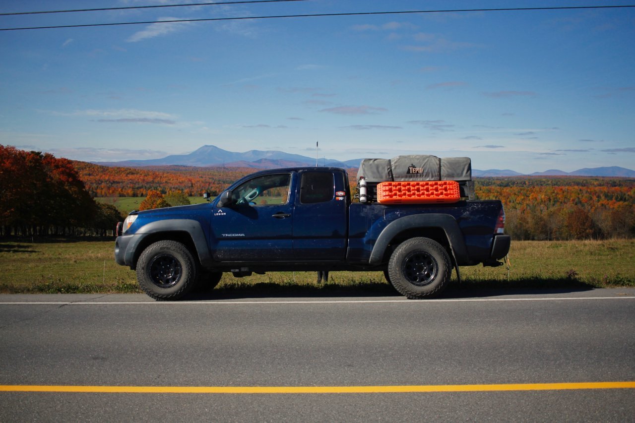

    here are two pics that kinda show the skinniness

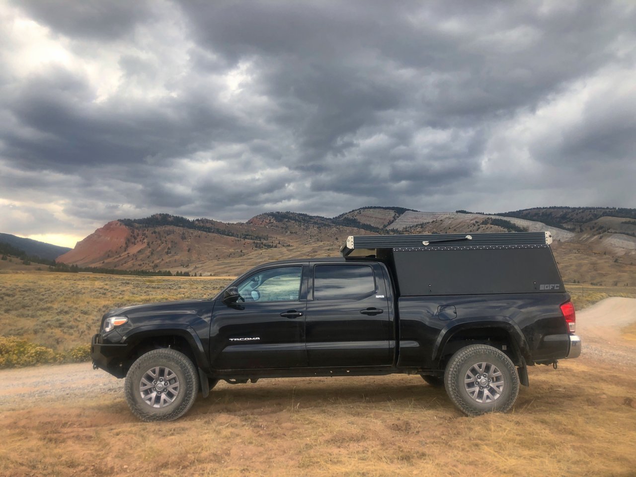

    I answered my own question. I think this tire size is perfect on a DCLB with a modest lift.

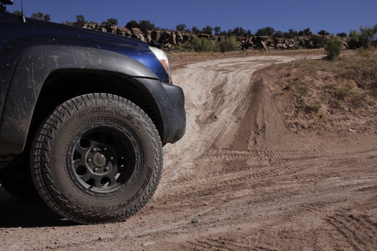

    Falkens?
  16. Oct 6, 2018 at 4:41 PM
    #96
    henryrose
    henryrose Well-Known Member
    Dec 26, 2016
    #205730
    97
    2016 SR5 DCLB Black
    Yes

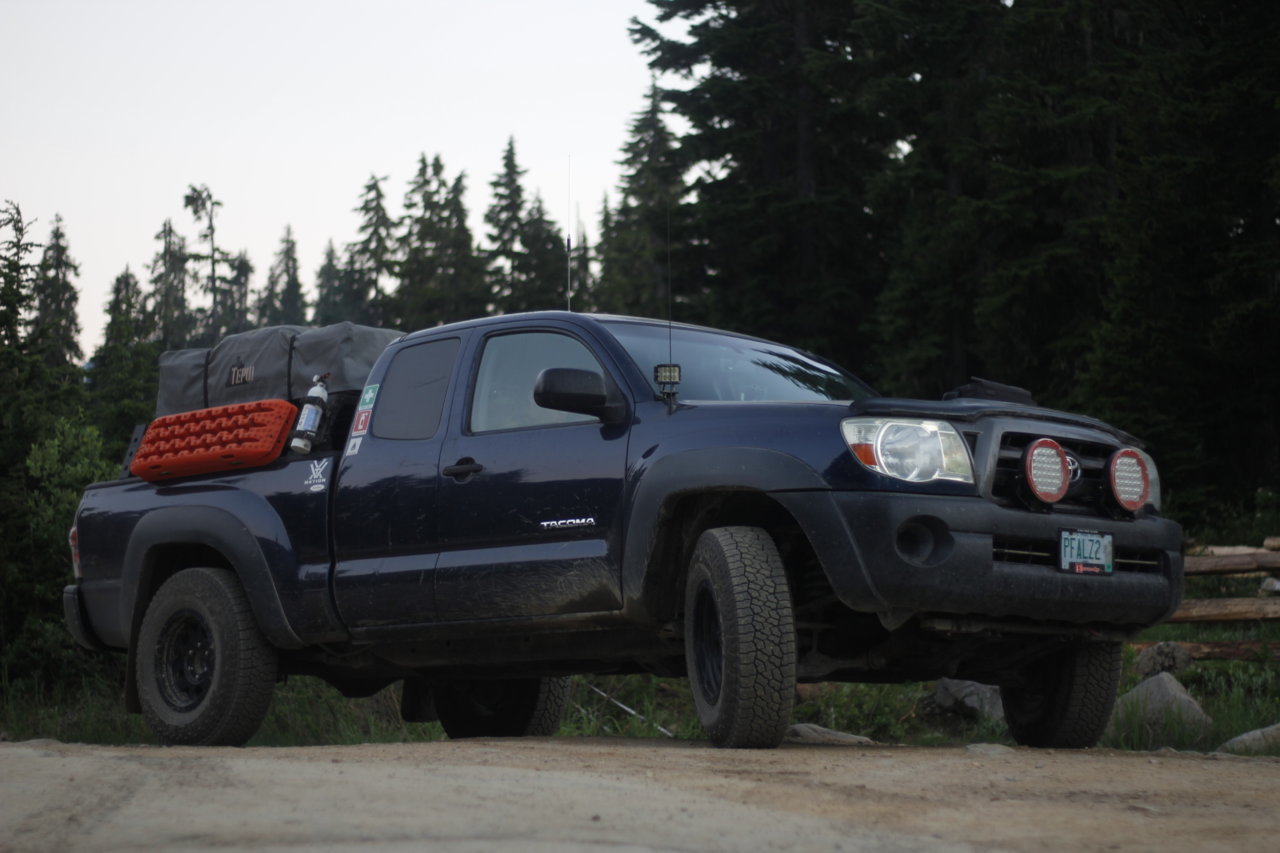

    06 access cab. no lift (3rd gen TRD OR to be installed) 235s on KMC enduros
