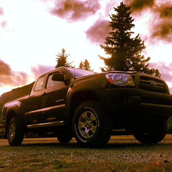

    Mountaincanuck
    Mountaincanuck Member
    Jan 16, 2012
    #70797
    13
    Brodie
    Canmore, Alberta, Canada
    09 Access Cab 2.7 4x4
    235/85/16 are really awesome on my 09 Access 2.7 4x4, fuel economy is very much the same if not better at some speeds.
    No rubbing.
    The ride is a bit stiffer. (mine are also at 50 psi right now)
    Winter traction should be an improvement.
    I went with BFG A/T KO, love these tires!!!!!

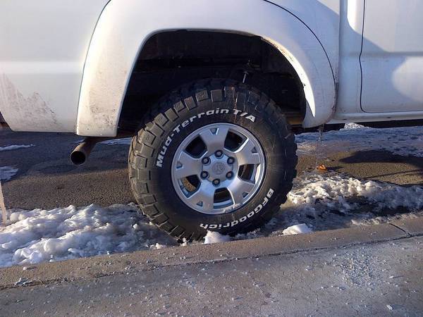

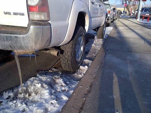

    baldy77
    baldy77 Well-Known Member
    Nov 26, 2008
    #11041
    65
    Albuquerque, NM
    05 TRD Offroad Doublecab Speedway Blue
    3" Toytec Adj Coilovers w/Bilstein 5100's front and rear, Toytec TSB AAL, LR UCA, Avid Weld-on Sliders, A.R.E. CX Topper.

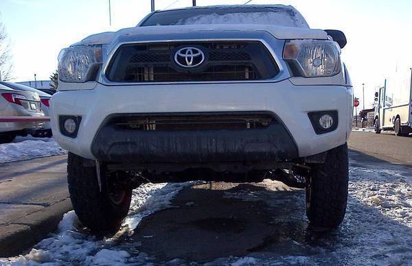

    Here are a few pictures of a truck I saw back in December running 235's. I'm debating whether I want 255's or 235's. If only there was a 255/85 option for the bfg at.
    This truck was in Santa Fe near the Toyota dealership. If anyone knows who the owner is and if he's on here, ask them to give us some input on how they like the tire size.
