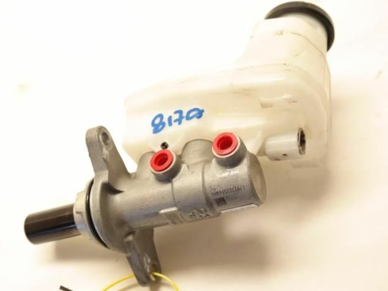

    Update: verified as fitting
    It appears as though 2018+ Camry, 2019+ Avalon, and 2019+ ES 350 have a 23.81 mm master cylinder. Part number is # 47201-06510. While a bit premature with the info, it does look as though it will be a bolt in for the Tacoma. OEM is a bit pricey, so a used unit is enroute to verify measurements... if it's a go, then a new unit will be ordered.
    Additional info... this is for rear disc conversions and calipers that require a higher volume of fluid. It may be a much cleaner solution to the often utilized 2007 Sequoia master cylinder, which requires an adapter plate and line extensions.

    Itchyfeet
    Itchyfeet Well-Known Member
    Apr 1, 2016
    #183054
    9,138
    What problem are we trying to solve?

    Larger MC piston bore means less pedal travel and harder pedal.
    (more effort)
    Trying to move more volume will not increase pressure... only fluid volume.
    A smaller bore will require more pedal stroke but will apply more pressure, but less volume. (disc + drum combo or manual brakes)
    With front and rear discs, the caliper pistons require more volume to fill the bores... hence the bigger master cylinder bore diameter.
    Power assist is key because of the increased pedal effort needed to stop,

    Jowett
    Jowett [OP] Well-Known Member
    May 5, 2016
    #186182
    1,616
    Brian
    North Adams, MA
    This adds fluid capacity for rear discs.
    I have read the threads where folks have installed the 23 mm Sequoia master and had issues. This should be a much cleaner/OEM install.
    If one is content with the drums, then stay with them.
