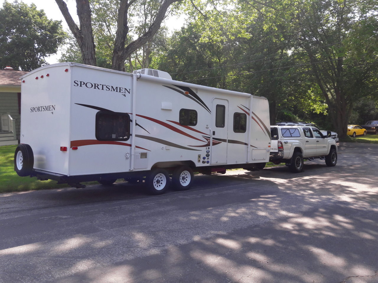

    Not a super good pic, but here's how she looked last year:
    Which reminds me - You'll probably want to add some towing mirrors. You can see mine in the pic above.

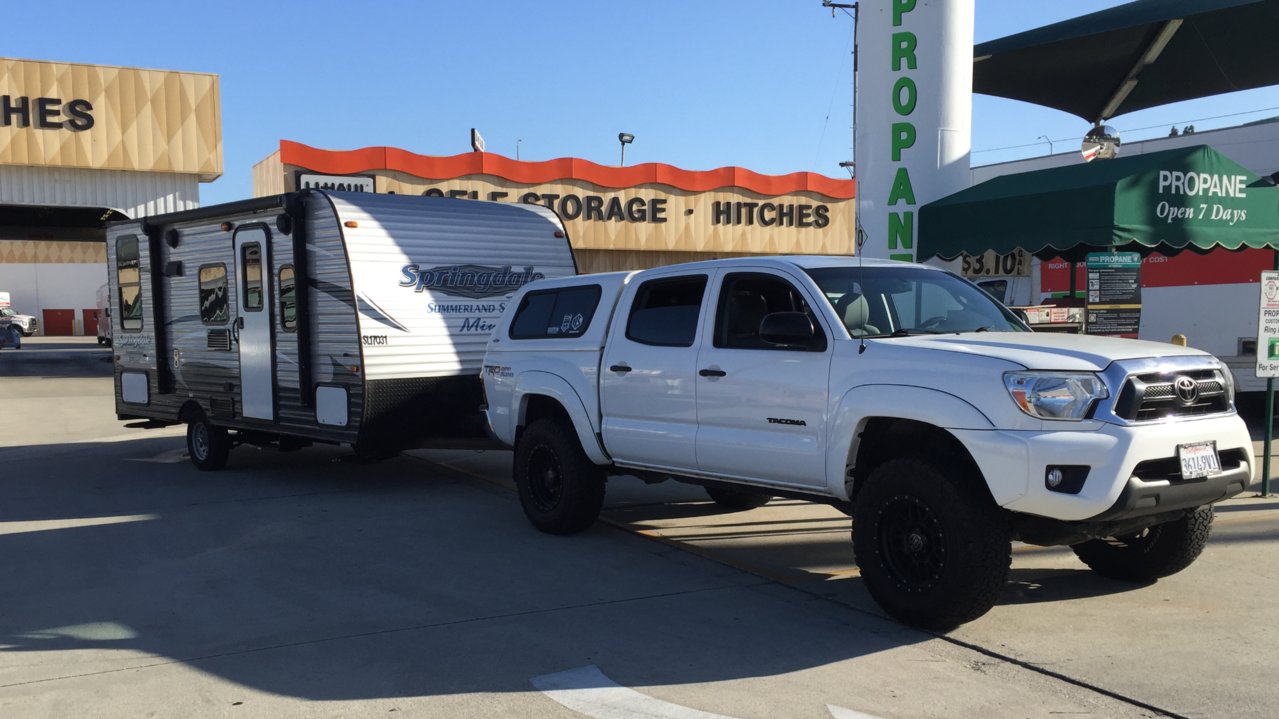

    Hey Guys, I have a Keystone Summer land mini, 21 feet total 3195 dry weight. I have towed in 4th gear a couple times from the dealer 20 miles and around town to practice.
    I am moving from So Cal to Lacey, Washington in 3 weeks. I will be towing the trailer Just over 1000 miles. I re
    Question:I believe it is best when towing to tow in 4th gear or below in other circumstances.
    Absolutely not in D overdrive. Does everyone agree?
    Here's my rig:

    4th will do you well at that weight. the truck will kick down a gear when it needs to. I just finished an 1100 mile trip and it worked great in 4th.
