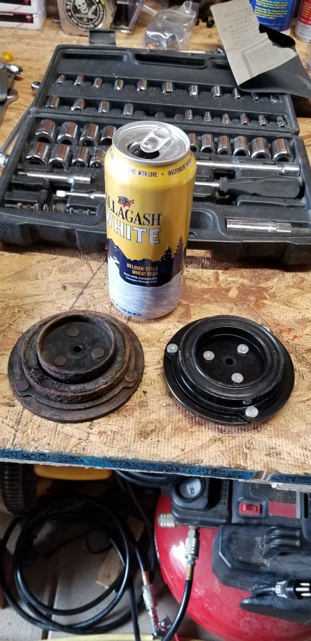

    So yeah - bought a 2006 Tacoma SR5 V6 with 169,000 miles on it.New factory frame - no body rust but some under the hood,front shocks and control arms.24 hours after driving and owning it i stopped by a friends place and the dog was in the car so i left it idling with the dog in it and the a/c on.10 minutes later heard the squeal.Got in the truck,blinking a/c light,smell of burnt rubber.FML!Got under the truck - pulley still spinning - clutch not moving after a few times of on off on off.Nothing.Got on the forum - found the fried clutch postings.Ordered a $20 clutch after reading extensively the symptoms and catastrophic fail of the A/C dieing.My $20 clutch from Amazon arrived in 2 days.I went to put the vicegrip on the clutch and it was disintegrating from rust - had the balled up burnt rubber like many posters mentioned.Got it off with some pb blaster and patience.Installed the new one with the 3 shims,same size as the old ones - cranked her over and turned on the A/C and man back to ice cold air.This saves me from the stealership ripoff that usually can be in the thousands.THANK YOU TACOMA WORLD MEMBERS!!!!!
    See attached pix of the old and new clutch .Look how crusty the old one is!!!20210611_161747.jpg

    Nice job… clutches are known to go after awhile on these… my son has the same tool kit you have in your picture he got it from his late pop and he uses it a lot when we work on lawn mowers :fistbump: oh and welcome!! I also would like that beer :D

    Husky tool set - i like the husky kits - seem better than craftsman in quality and lifetime warranty as well.I have broken craftsman ratchets and their replacements.Not what it used to be!
