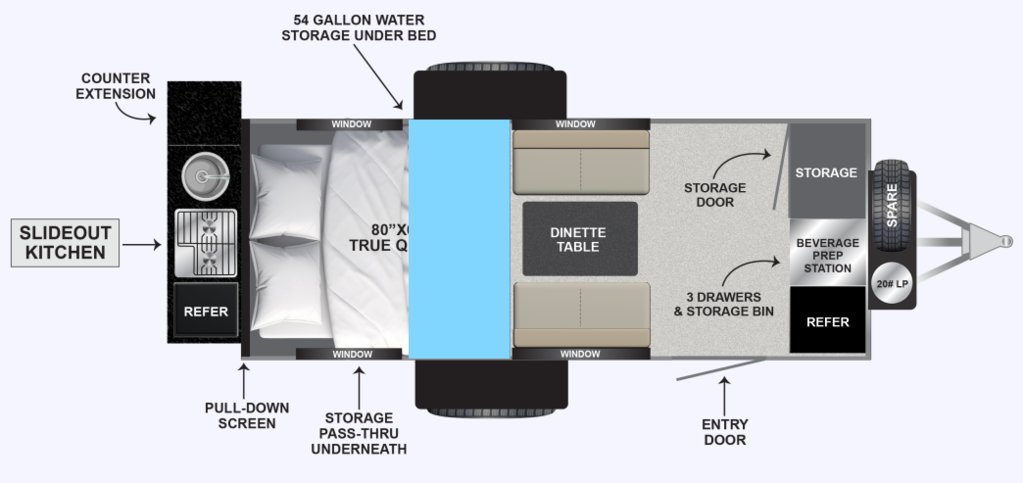

    Searching for the ROG 16rb brought up a floorplan where the water tank appears to be behind the axle under the bed which would lighten the tongue.
    .. and it holds 432 lbs of water (54 gallons.)
    Is your floorplan different?

    Based on the video i just watched, it must be RIGHT here, so while still somewhat behind the axle, at least it's not WAY behind.

    This is about right. It's really two tanks with space in the middle, but that would be about the right footprint. It might not extend back quite as far as that sketch, but pretty close.

    Yeah, i just knew it had to be in front of the pass through, since the kitchen was in the very back. Neat trailer for sure. It's fun seeing manufacturers finally trying to think outside the box a bit and not just have the same floor plans as everyone else.
