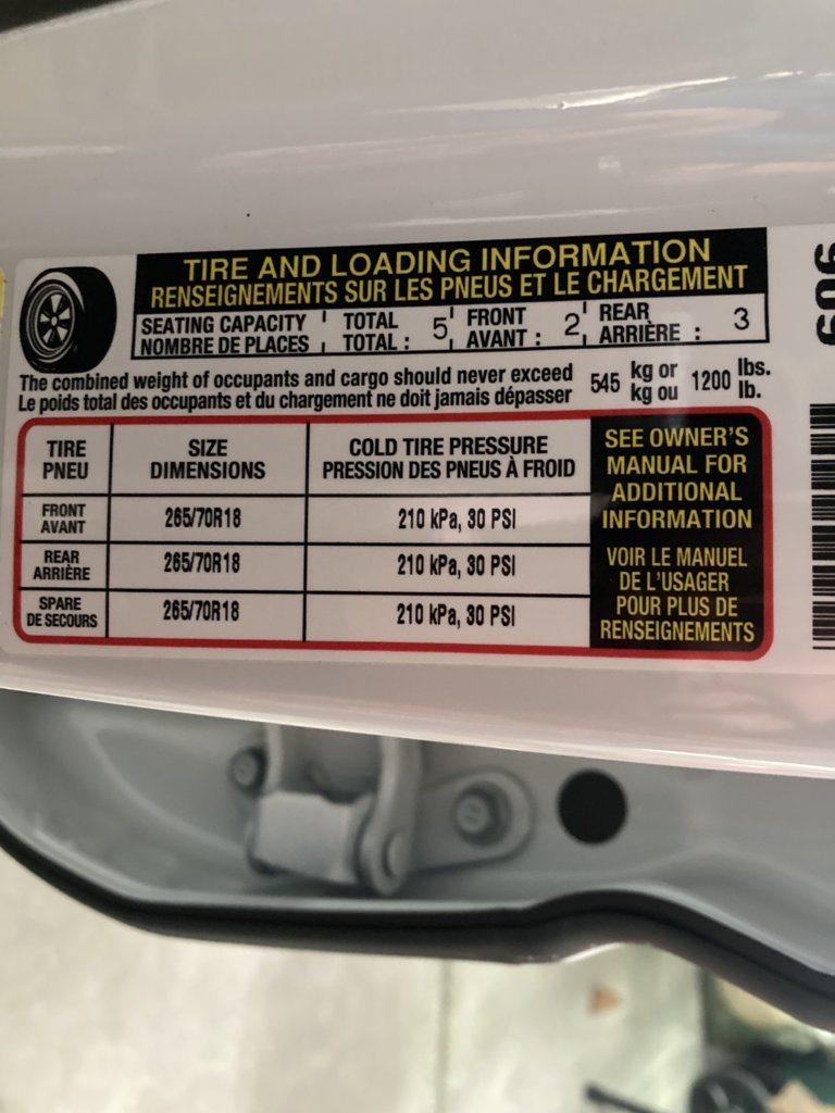

    Tire pressure will be posted on a sticker inside the driver's door, and in the manual. Just confirm the listed tire size is what's actually on the truck. This will have the greatest impact on ride quality, and 35 is going to be too high.
    This is how you know he's not an expert; there is an exact number the pressure is supposed to be, no one has to guess, lol.

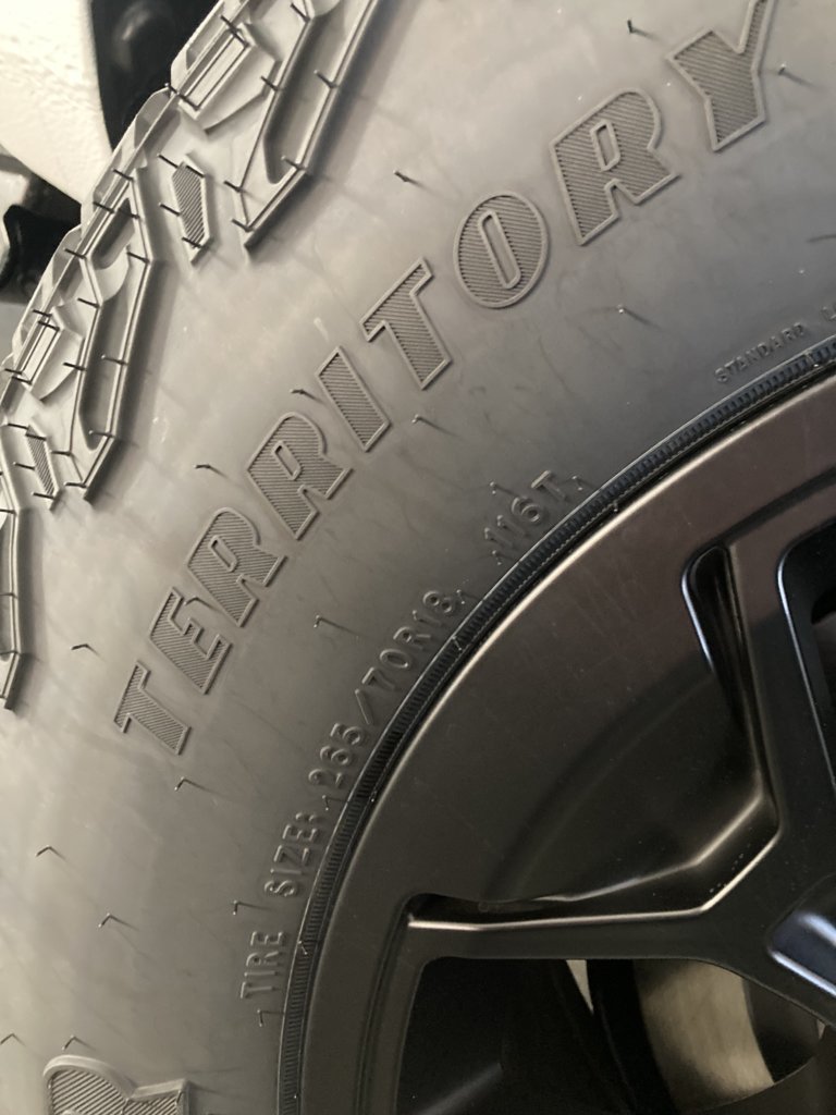

    Great points here. I did just go out and confirm the door panel says 30PSI for all four tires. But I do wonder if this is the right PSI for these Wrangler Territory tires or if that’s more for all-season tires.

    Get the tire pressure set to what the door sticker says if the tire size matches. There are some sites where you can convert pressures if it does not. Then go into the gauge settings and set the TPMS pressure. Warning should trigger if pressure drops by 25%.

    Anytime somebody touches the tires you need to fix the air pressure. On my first service, the checklist said 30psi was the correct pressure, but they aired up to 36 anyway.

    30 is correct for your tires. Any passenger vehicle tire in that size should be run at that pressure on that truck. 5 psi should make a big difference in comfort and handling, so you may be in luck.
    Things only get tricky when you go to different sizes, or use heavier duty tires with a higher load rating (LT, or light truck tires, vs. yours are most likely P-rated). Although "light truck" actually means a relatively big truck compared to the Taco. I'd go ahead and say stay away from LT tires for the foreseeable future, those make the ride much worse. Get some miles under your belt and go down the tire rabbit hole when these wear out.

    Great advice here. I just checked the tires specs and they do match the exact tire size as the door sticker indicates, so I need to drop them back to 30PSI. I also did notice you can adjust the TPMS settings to match your requirement so I’m going to make that change (although I will say they were at 30 before and still rode unfavorably, but I’d rather match Toyota’s design spec in this case).
