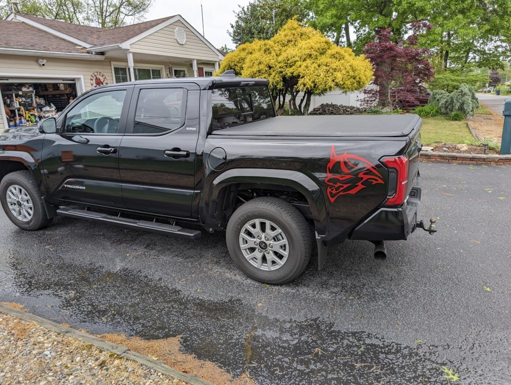

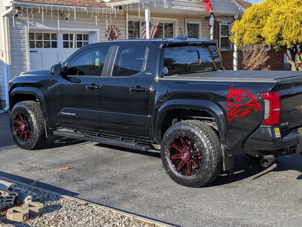

    Taco wheels.jpg I am looking for some 18" wheels and tires too replace my stock 17's on my 24' SR5. Anyone looking for a set of 17's with tires, 6600 miles let me know.Truck Pic.jpg
    I just installed some XF-220 18"x8 0mm offset with Toyo Open Country A/T lll
    265/70R18 116T. Look great but due allow about 2" of tire to stick past fender but if I do a neg. offset the tire will rub on full turns. Went from 29" to 32" height.
    Big negative is that XF Offroad does not cut lug holes big enough to allow a sleeved lug nut to be installed, which is needed to get more than half a lugs threads on the lug bolt. Toyota thing with short lug bolts and sleeved nuts. Spec says half the nuts threads is enough for regular driving, maybe not for rock and trail though.

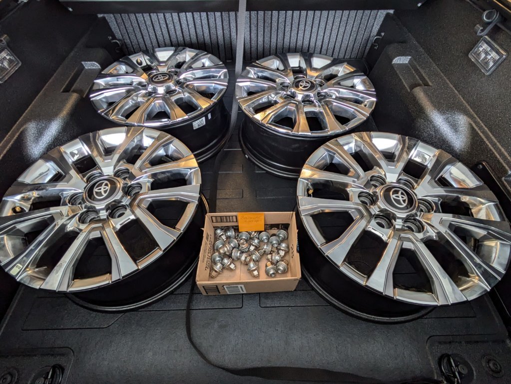

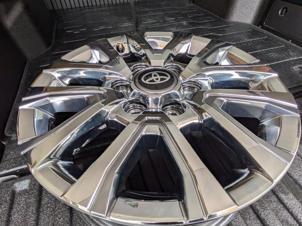

    I have a set of the Limited chrome wheels, caps, and lugs sitting in my shed from my take-off if that tickles your fancy

    18x7.5, -55mm offset.
    If you fancy the chrome look, I have the mirror backs (with factor ppf & turn signal cuts), as well as the chrome grille and soon enough the upper bumper.

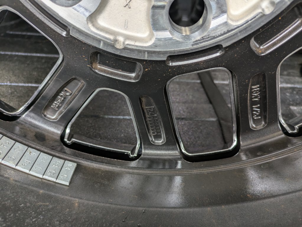

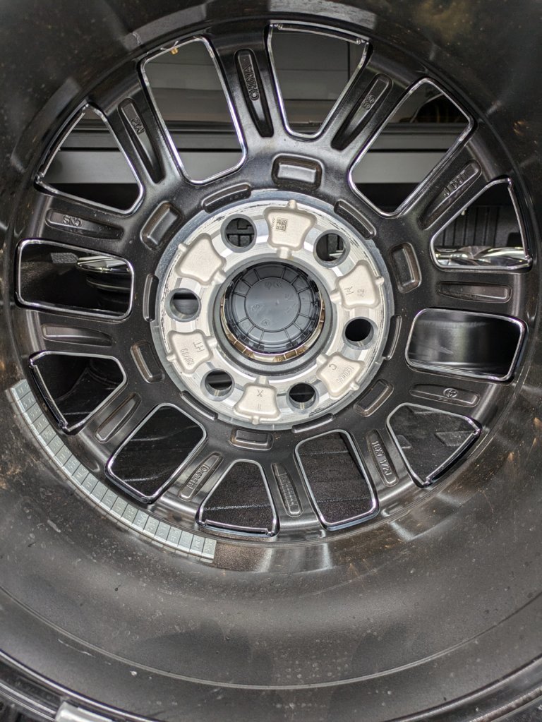

    Yeah. Assuming that was done for two reasons: to ensure tone/reflection match with other chrome vehicle parts, and to minimize the god awful look of partially delaminated chrome on alloy wheels abundant on the roads today. It's epoxied to the alloy hard as can be. Here's what it looks like from the backside.

    You would think they would have used black weights on a black wheel. Make them look a little less obvious.
