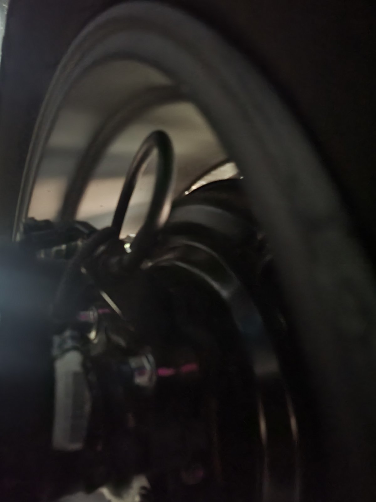

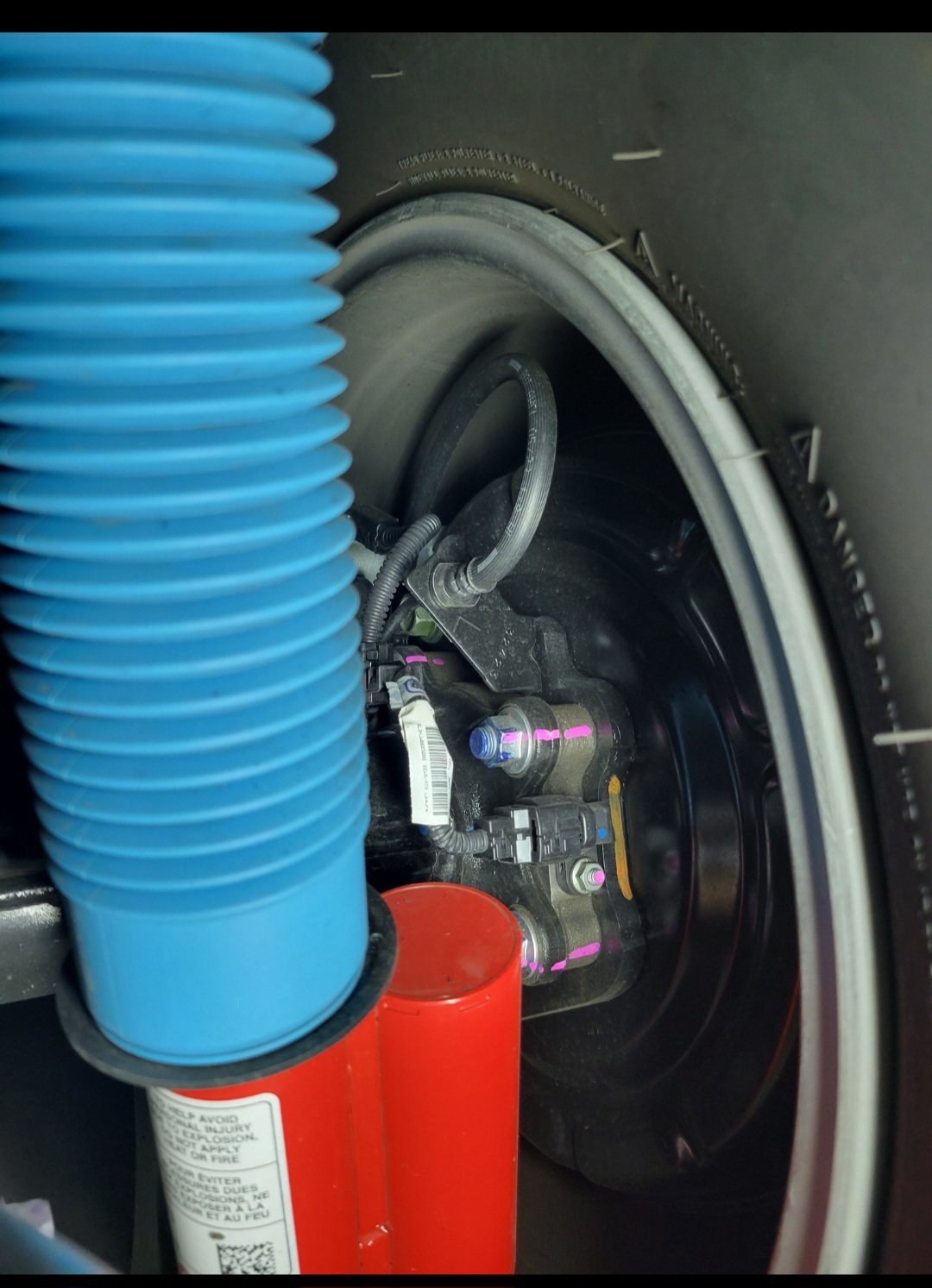

    2024 Bronze Tacoma TRD Off-Road
    Just checked the rear brake line my OR - not a good design. The brake line is routed inside the wheel and has approximately 3/4" clearance. Recipe for some bad mojo. The front is design different. Now it's bit clearer how the mud damaged the line.

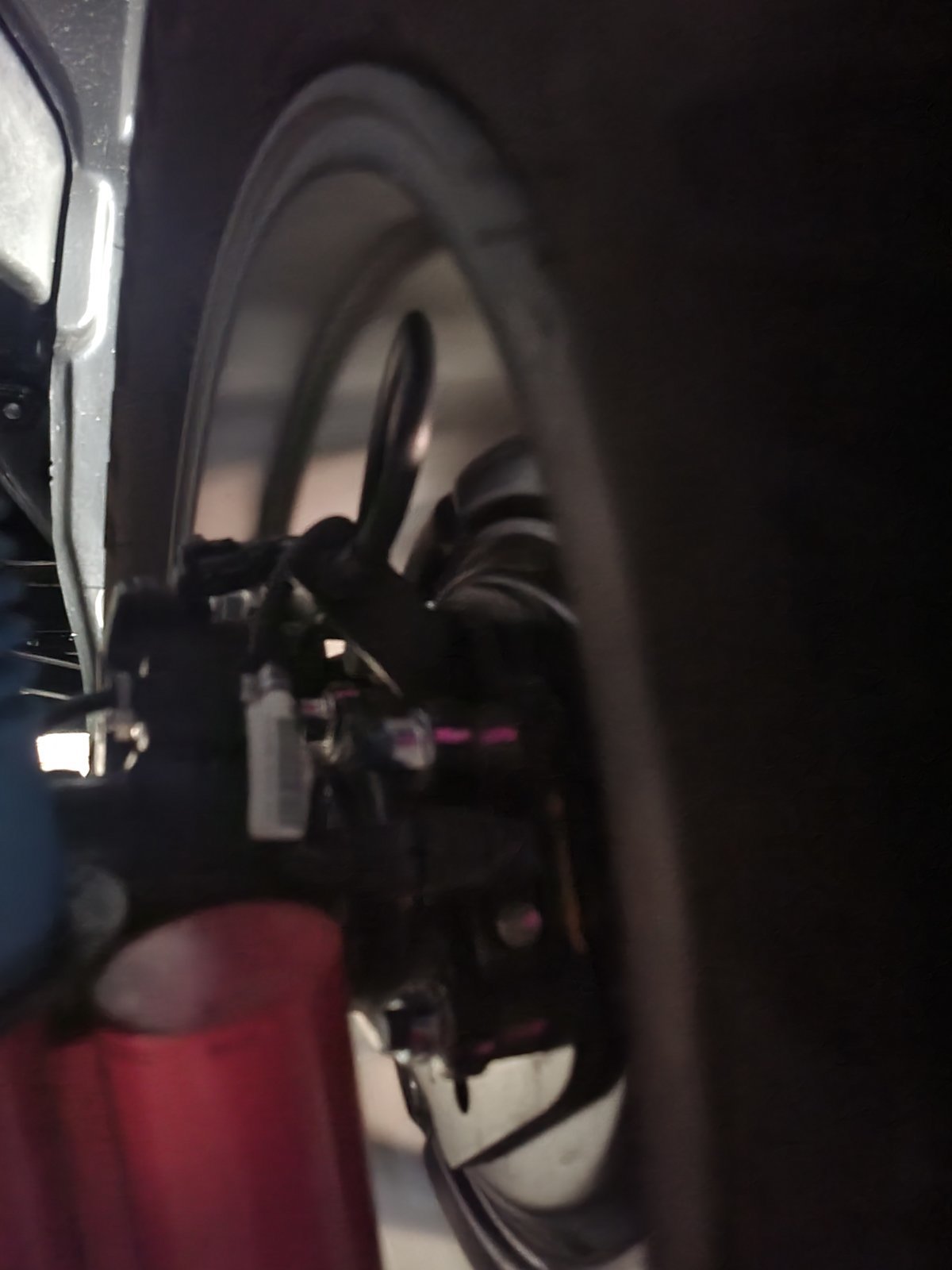

    Couple of pics...

    Another concern - when servicing the brakes or rotating tires, sometime you miss the wheel studs trying to install the wheel and it lands on the dust shield or caliber. Imagine crushing the brake line... Be careful.

    I think you need a better camera or phone..

    Unfortunately, I took the photo with my cell in a dark garage... Easy for anyone to check, if you own a 24.

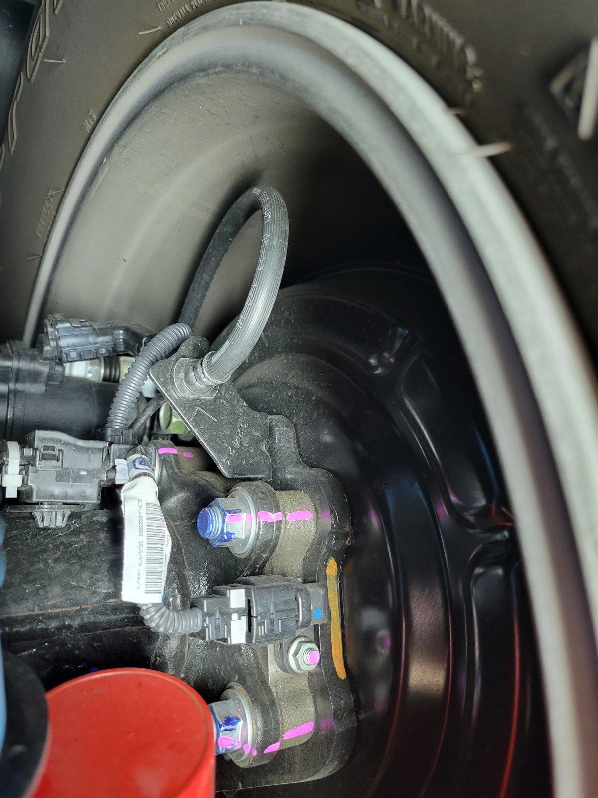

    Here's a couple of better pics...

    Well, that's a shitty design :annoyed:

    My drum brakes don’t look so bad now JK looks like a piss poor design. I could see it potentially failing driving in deep snow as well.

    On second thought, I'm keeping my drums forever. This is horrendous.
