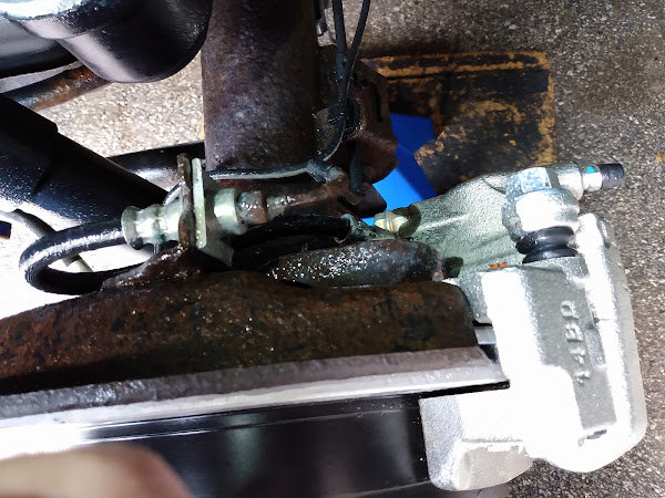

    I don’t disagree. That cable looks really close to the inner wheel surface. I’d like to see the 18” wheels for comparison.

    On the 5th gen 4Runner (2 million built over 14 years), the brake hose is routed under the hard line flare nut bracket and doesn't protrude beyond the dust shield. Unfortunately, on the 2024 Taco, the parking brake actuator is in the way, so Toyota opted to route the hose differently.
    AP1GczMsDnvMe0z79mA91M7kGR5rlcctapXybM9d_80be2de7a7c2f1411ccea44dccc5fe6d0c7d56d7.jpg [​IMG]
    On the other hand, the mechanical parking brake on the 4Runner is a piece of shit. Damn if you do, damn if you don't.

    This will be recalled. The service rep said that the Toyota engineer has seen multiple cases of failure.
