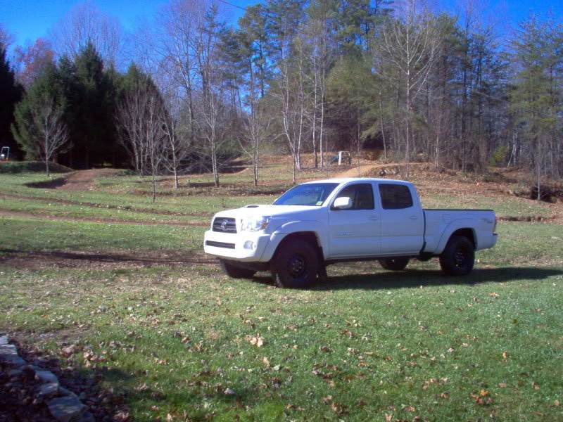

    Mounted up today,pic sucks,lol
  13. Nov 19, 2008 at 7:27 PM

    Just so you know the type A rims wheelers has is mostly for the 4runners.......not really made for the tacoma.........make sure you order the TYPE B rim and you'll be fine.

    very nice!!!! i love black wheels!!
