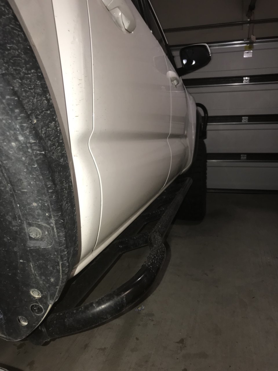

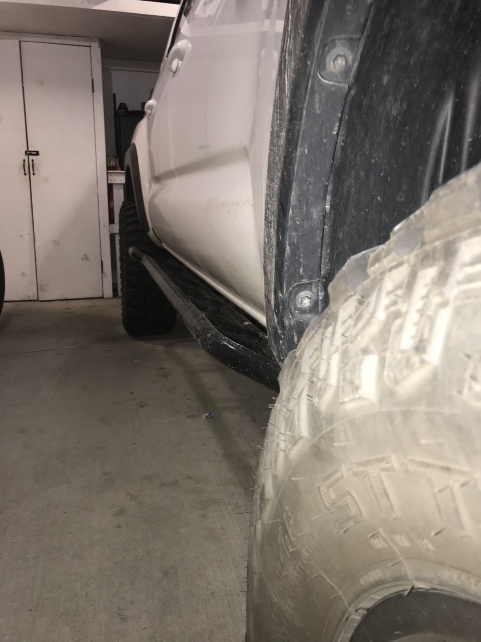

    I welded mine on at 20°. It doesn’t really look like it in the pics, but they stick out 2” further than the door.
