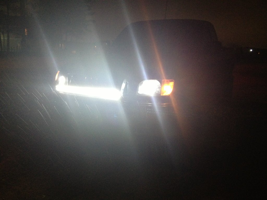

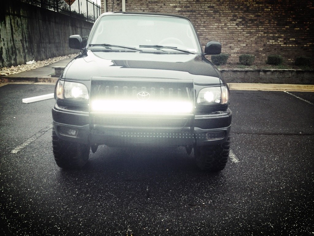

    Finally got my Hanma 30" LED bar installed. Took a while, but I waited for their latest version to come out that has CREEs in it. I don't think they have them actually listed on their website right now, but feel free to browse their site. I got this bar for $250.
    Videos I took:
    http://www.youtube.com/watch?v=cQPFWtd51jY&feature=youtu.be
    http://www.youtube.com/watch?v=bMkMAJ8nSX8&feature=youtu.be
    www.hanma-auto.com
    More new pics down below.

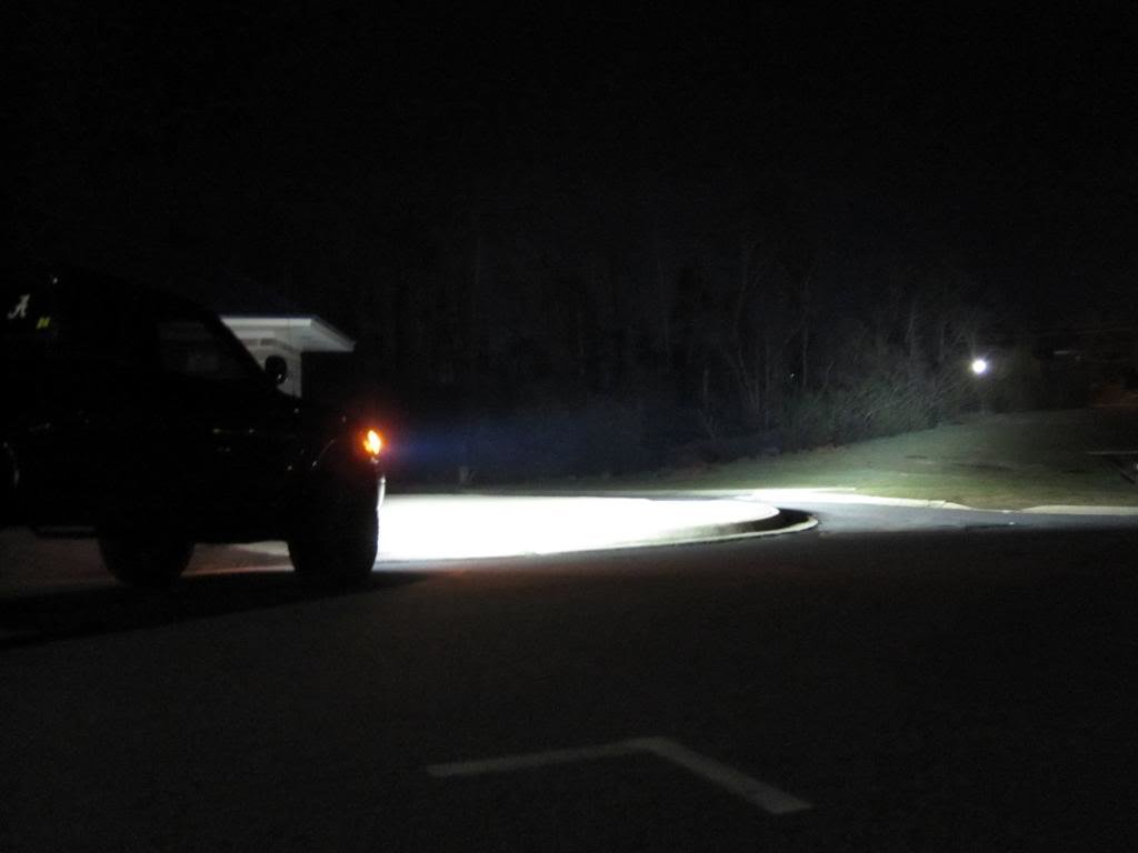

    LED bar and low beams (need to point the light down a little):
    The image above was the trees where I was standing about 400 yards away. The ISO settings are a little high, but this is fairly accurate as to how well I could still see that far out.

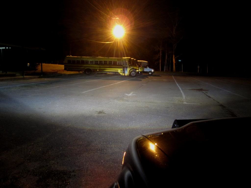

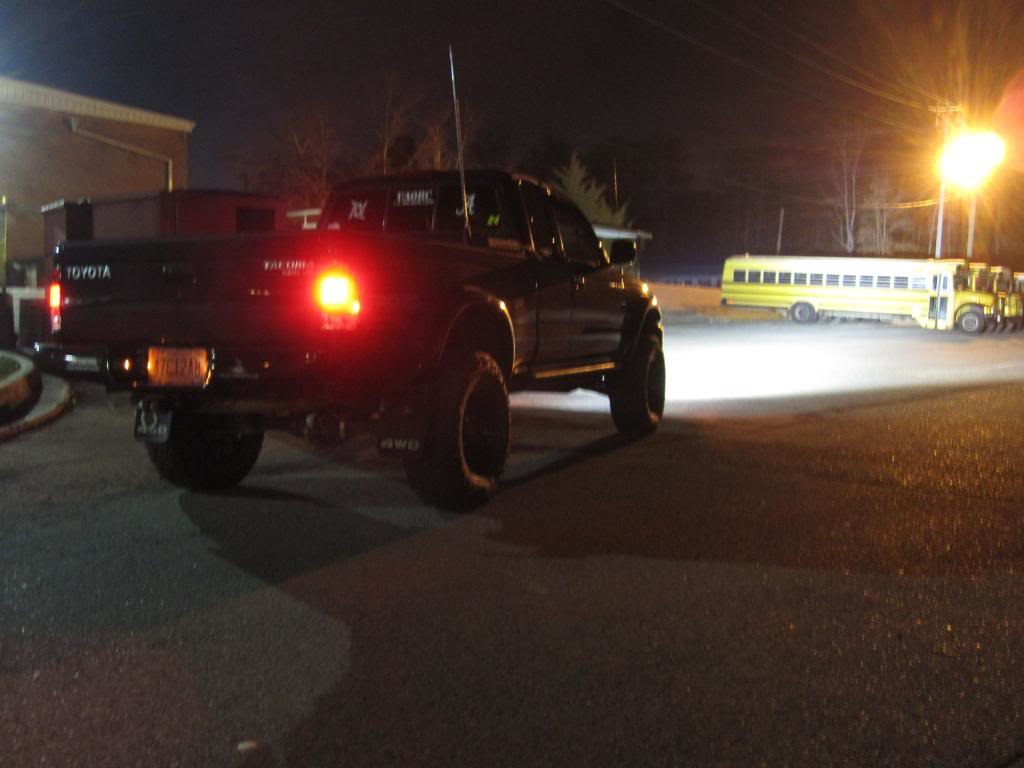

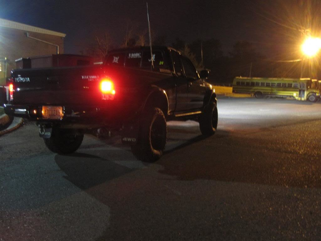

    School bus comparison:

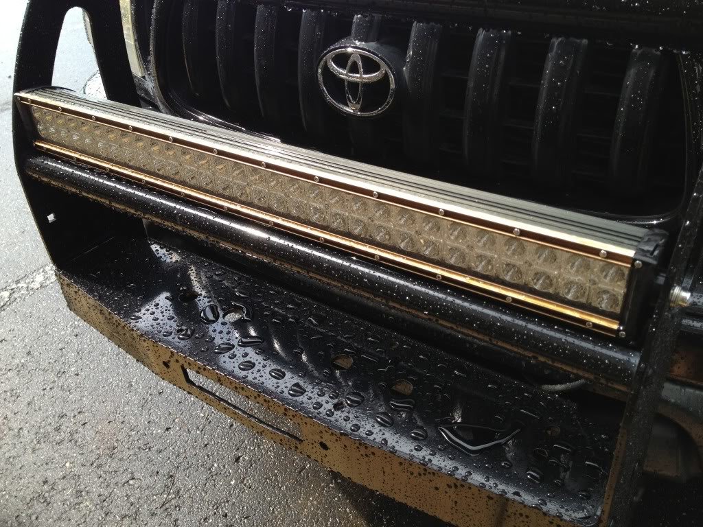

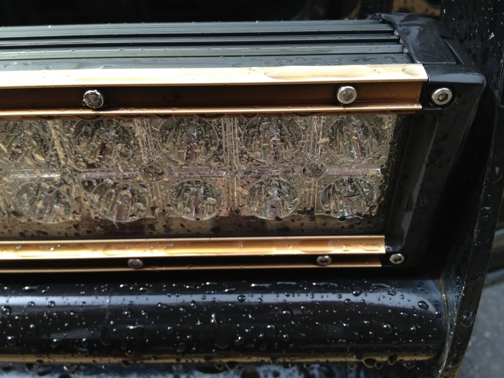

    Longevity report (4 months of use):
    The light still is functioning perfectly. However there are some issues with the light's housing finish. I noticed it on a friend's single row as well (also made by Hanma).
    A few of the metal pieces on the housing of the light appear to be anodized. The anodization doesn't last long either, revealing a brass/gold color of metal underneath. I sent an email to Hanma directly in order to alert them of this. They told me that their new bars are simply going to be painted/coated instead of having some of the parts anodized. They also told me not to try to remove the screws that go around the light in order to take off the gold pieces, as there are small nuts located behind them and it would be virtually impossible to reinstall the trim pieces. So essentially, I'm going to have to mask off around the area and spray paint the anodized areas.
    Here are a couple of pics showing what I'm talking about:
    ECD81CCF-218D-4E8F-824E-8C513E7938AD-378_3a48e4ec34ccc685d39c943644638a1b68336a46.jpg
    39404CB1-B871-4754-87A3-41CC659D77A7-378_38c0f5bf4c5e50e5640bb20aaa71777cebae14a9.jpg
    As noted before, I cannot simply remove the screws to remove the gold pieces and paint them. Masking off and painting is the only option.
    Other than that, this light bar has been worth every penny. Hope this helps some folks who are LED bar shopping but are having a hard time justifying cost.

    I kind of like the gold :)
    nice light and nice review, thanks!

    id leave it, different from all the other 500 same 'ol LED bars.

    What happened was the anodize faded from the UV rays. The metal is a typical cheap aluminum.

    my lights from OKledlightbars did the same thing with changing colors like that except it was the entire housing that was starting to fade.

    I might leave it. Because the only real way to get it off is to remove the brush guard and just mask off what I can and paint it. The light bar barely fit, I had to shave off some of the sides. And then I siliconed around that area. So it's not going anywhere without a fight (good deterrent for thieves though)
