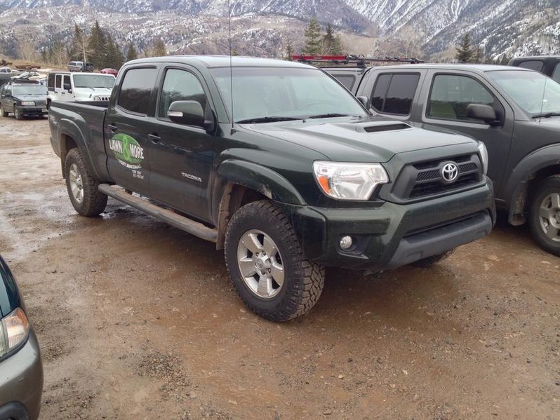

    Having internet issues but I'll try to get more pics up tomorrow. Here's a couple to tide you over lol.

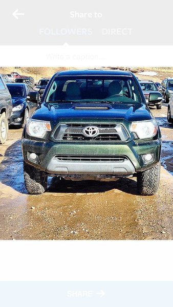

    From the front

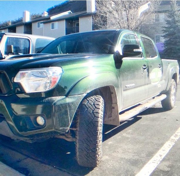

    Compared to the 265 70 17 and 265 75 16 size a lot of people are running. The 255 75 17 is a standard load tire so it has less ply than that of a c load range tire. The result is a softer tire that is smoother riding. It also makes it lighter...then combine that with it being narrower (less surface friction) and you get a little better mpgs even though you gain about a half inch in tire hight. This tire size also makes my dual cab long bed much easier to park because it requires so much less effort to turn a narrow tire at low speeds. Hope this is helpful!

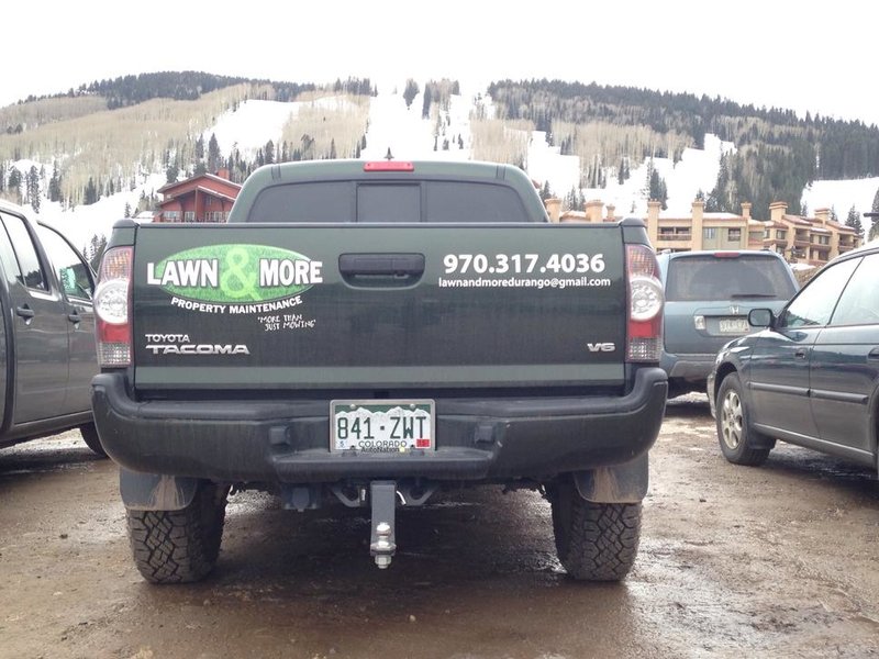

    From behind

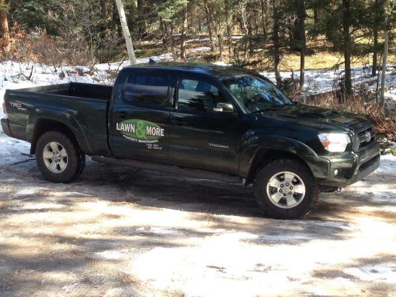

    Better side view

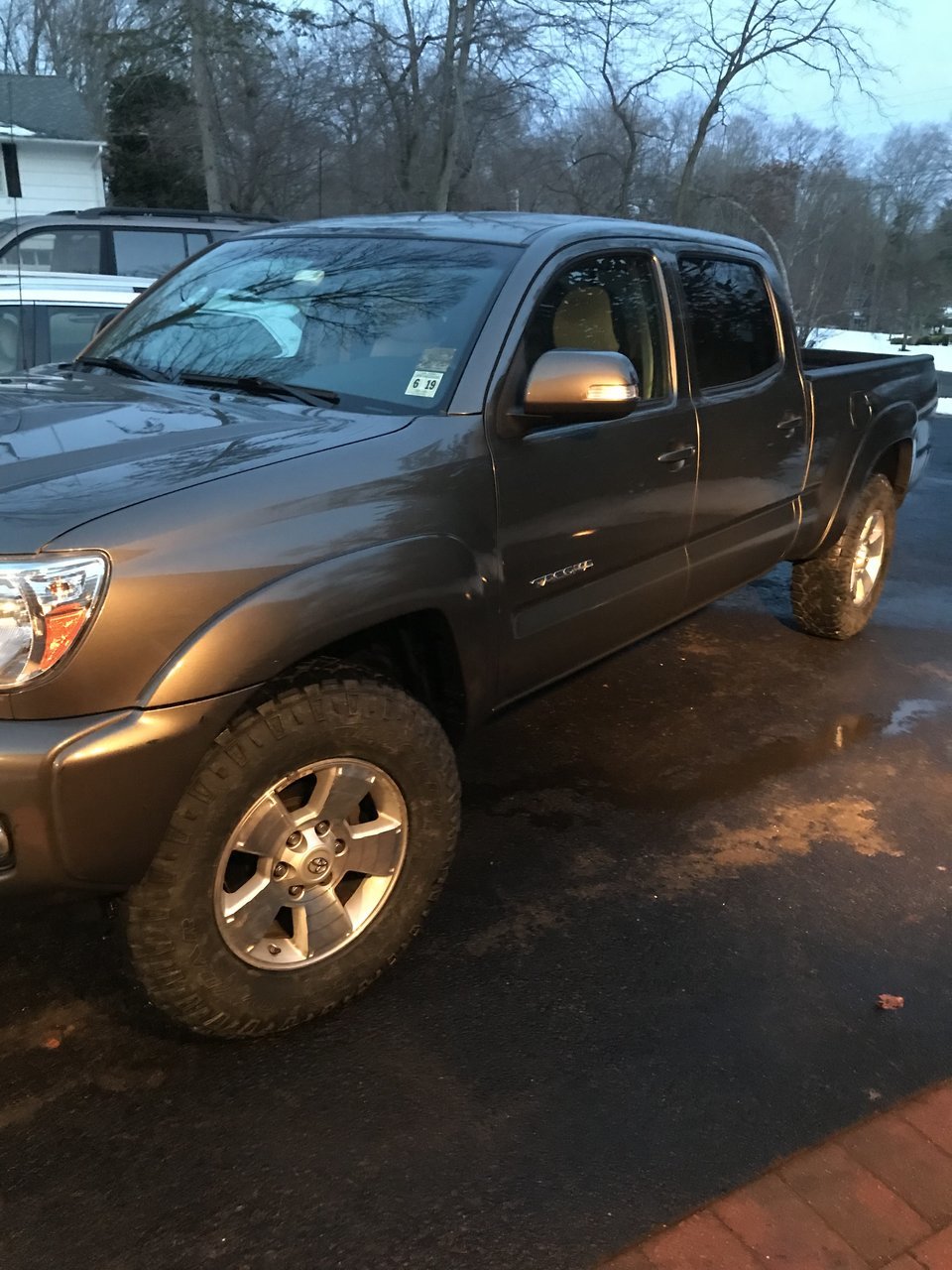

    Just FYI. For anyone mulling this over. Spent a lot of time debating my new tires. 255/75/17 work great on my stock 2014 dclb TRD Sport.
    I haven’t taken it in any flexing situations but normal driving (full lock, reverse, turning onto my steep driveway etc they seem to work fine no rub).
