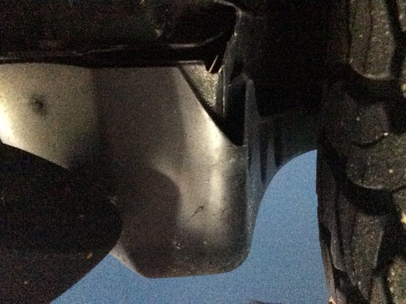

    image.jpg I have Firestone Destination A/T 255/75/17. I had to trim the driver side Bushwackers fender flair. Mud flaps would probably have to come off. There is more clearance between the Bushwackers and tire than what clearance I had between the mud flaps and tire.
    This is a picture of the bottom edge--near the drivers door--of the fender flare with 3 pieces of 1/4 inch wood strips wedged between the stock 265/65/17 tire and flare. There was hard rubbing with the 255/75/17 tires.
    I didn't measure any difference in mpg with the taller tires. I might have lost a little acceleration due to the tires being 3% bigger, but that could be in my head. My speedometer is only 1% off, as measured using gps on my wife's iPhone. Odometer is 3% off. My traction is great, but that could be because of the Destination A/T.
