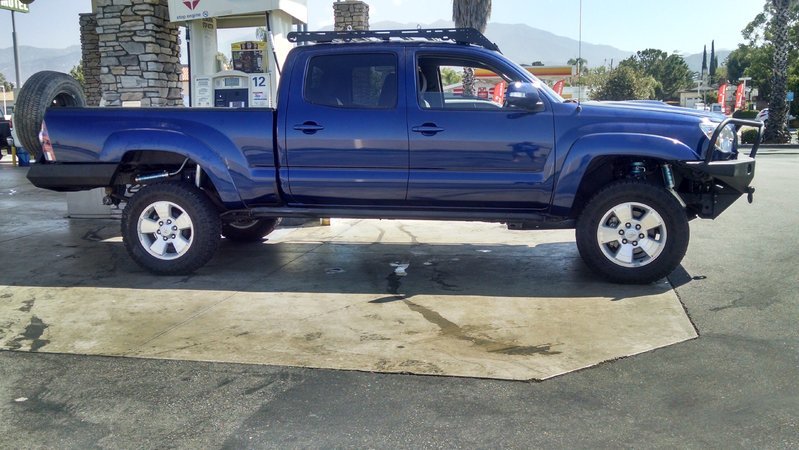

    Where did you heat/deform? I'm slapping these tires on my factory wheels as you did. I'm trying to save the guessing and determine where to start trimming. I'll guess from there. Nice color btw. Here's mine.

    Has anyone put these on a 8.5" rim? Cooper website says its allowed but what about aired down?

    Are those the trail edition 4 runner rims 17x7.5"? Any rubbing issues?

    I went ahead and mounted them. No issues so far.

    Thanks. Looks like your enjoying one of our scenic trails Broken Arrow Sedona

    Yeah we headed down to Sedona the last day of Overland Expo West before heading home to Cali.
    So I never knew Nitto/Toyo had offerings in the 255/80/17. I confirmed on both websites but I wasnt able to find a price. I'm assuming its a new size for them?
