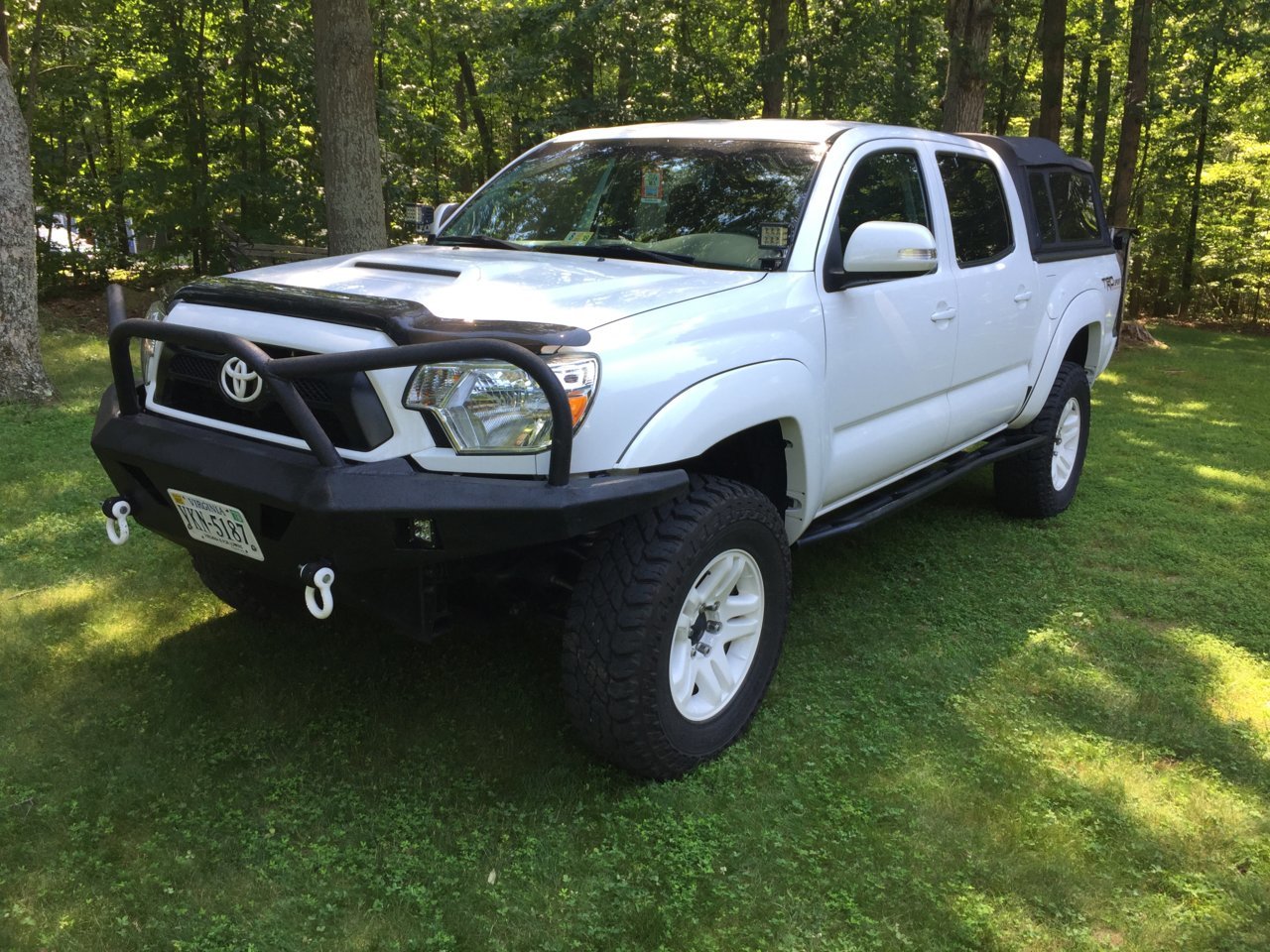

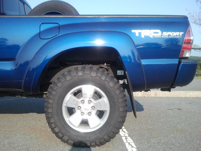

    255/80/17 ST MAXX on first gen Tundra wheels. About 20,000 miles and still loving them!

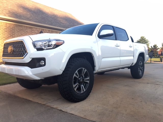

    Got my 255/80/17 ST Maxx Mounted up on my totally stock 2018 TRD sport yesterday. Stock wheels/stock height. No rubbing so far and I doubt it will ever rub. I haven't been able to really stuff them yet but did try in a small ditch and had no issues. Tires are quiet enough for an aggressive AT/MT hybrid tire. I will wait to comment on how smooth they are. I have a little more vibration than expected, but they have 7 miles on them. I plan to drive the truck quite a bit this weekend and I will report back then.
    Here it is. The conclusive evidence I searched high and low for STOCK 3rd Gen sport with 255/80 pizza cutters.

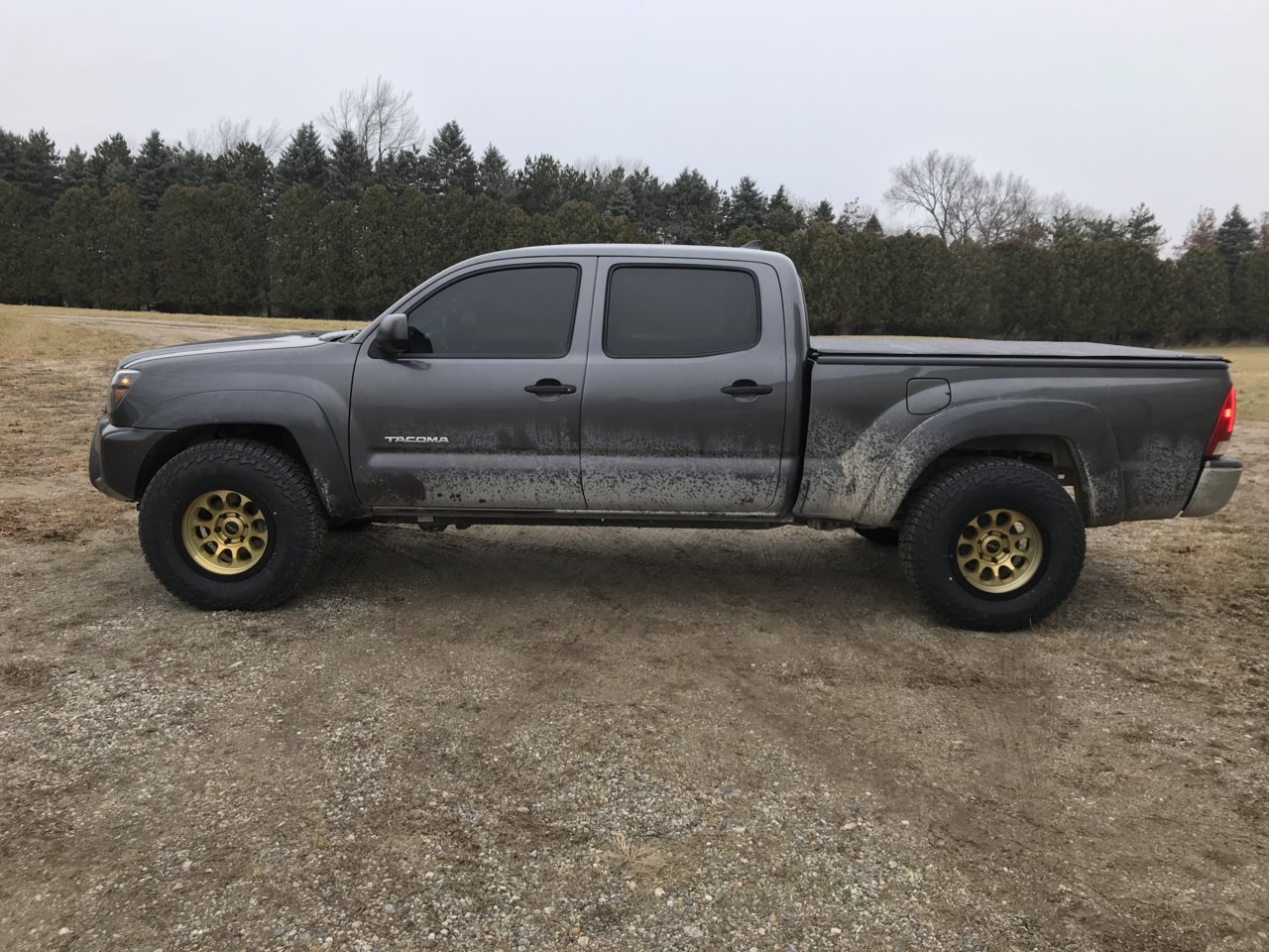

    Can you get some pictures or measurements while turning/stuff? Really looking into the FX Pro 17x8 et 0 with these 255/80s, and I think it will be pretty tight. But you're giving me hope with your setup :cheers:

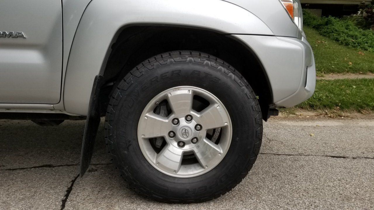

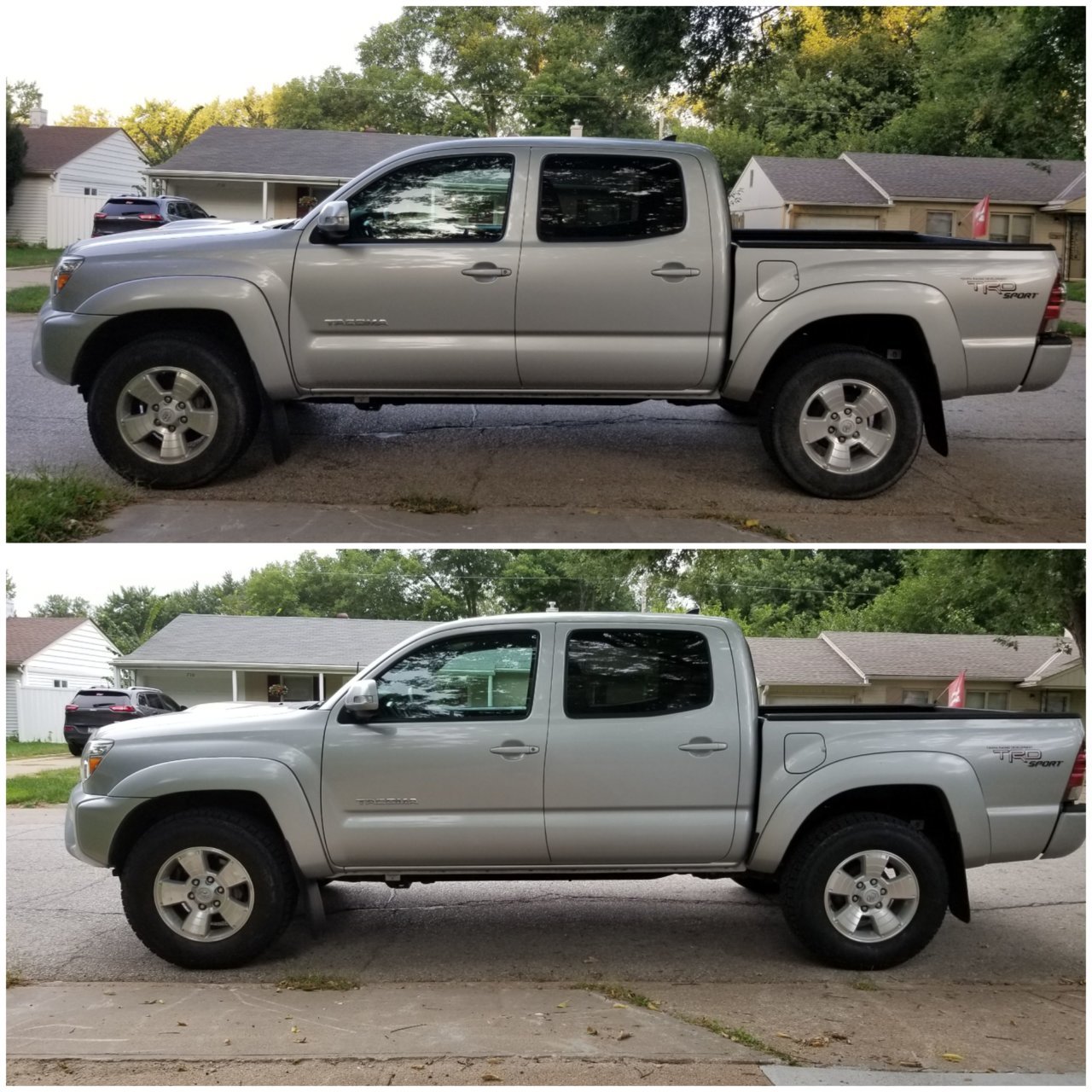

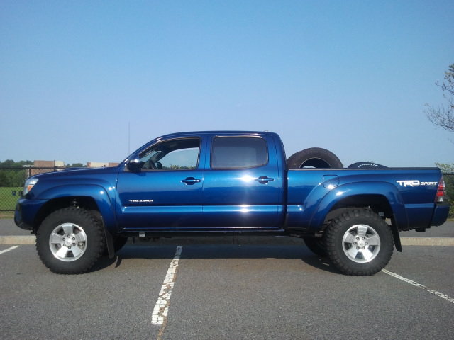

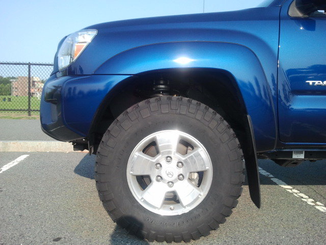

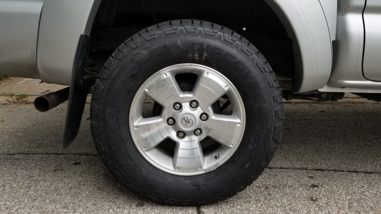

    Chiming in with a touch smaller size for comparison. Just put 255/75r17s on my stock 2013 Sport this morning. Couldnt feel, see, or hear a rub through 15 mi of city driving and a tight parking garage downtown getting to work. I love the fit stock, but if I was going to lift I think I'd go up to 80s.
    265/65r17 on top. Front and rear with the 255s20180828_120204.jpg 20180828_120132.jpg 20180828_120123.jpg

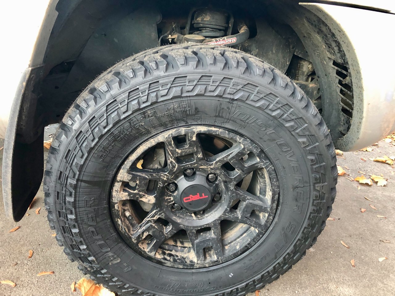

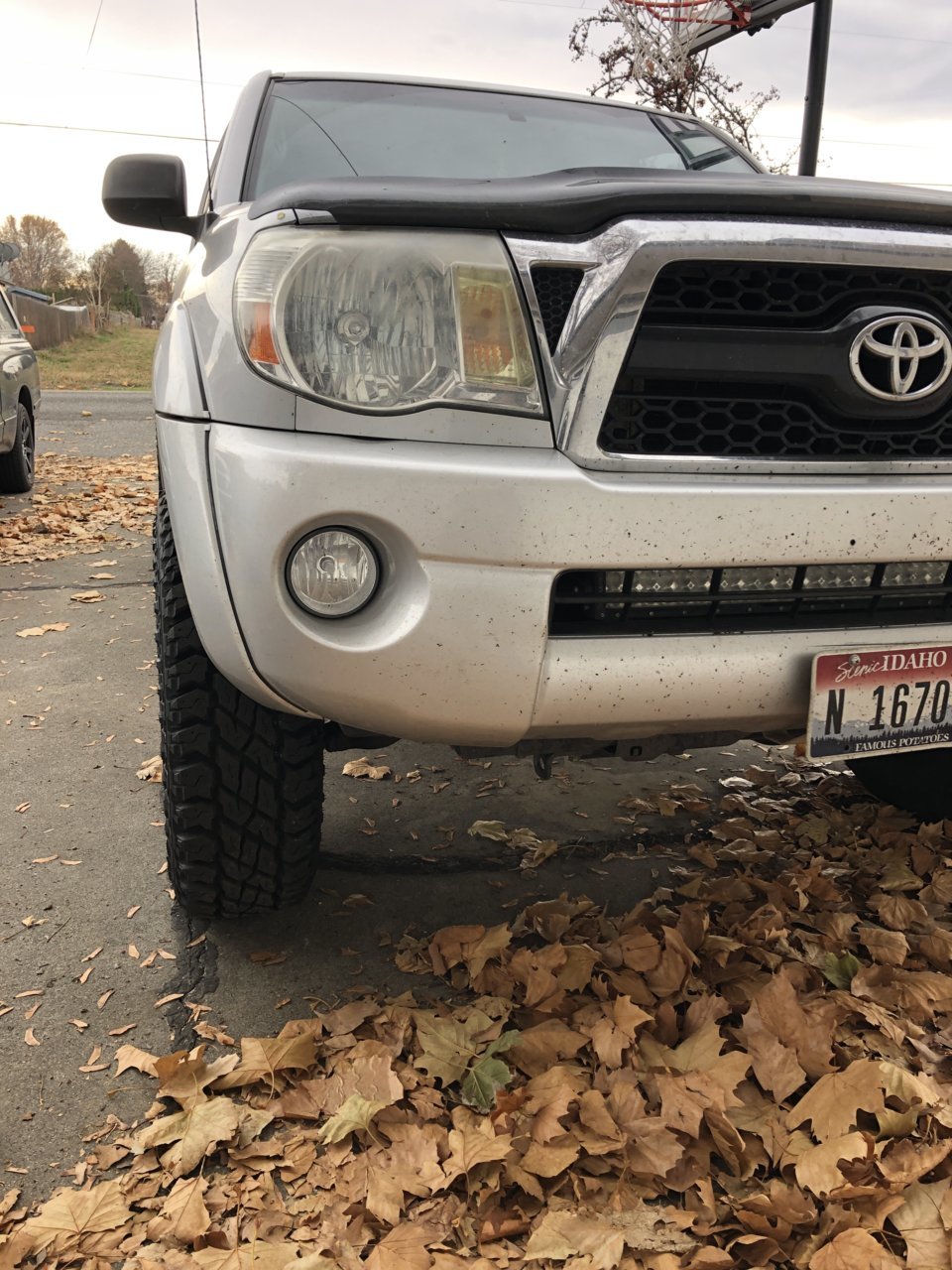

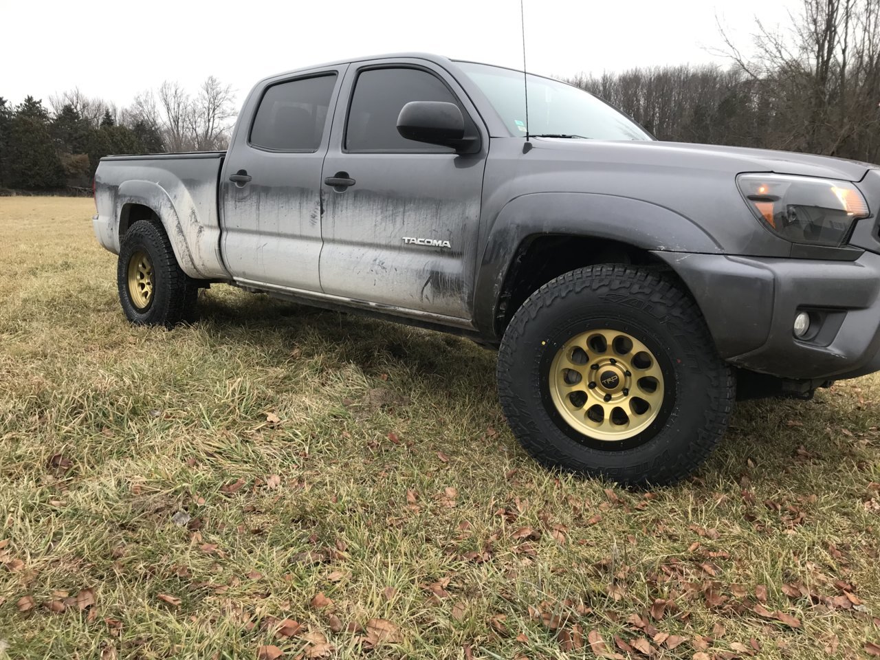

    Just thought I'd post something that worked for me- 255/80R17 Cooper ST MAXX on T4R TRDPRO wheels, 1.5" leveling spacer (was there when I bought it), Camburg Balljoint UCA's (to add caster), no wheel spacers, no trimming. Front hub to fender measures 22". Husky mud flaps intact with no rubbing on road or off so far. Pic was taken right after install.
    To add- tires are pretty flush with fenderwell with this wheel/tire combo. I’ll update with more pics later.

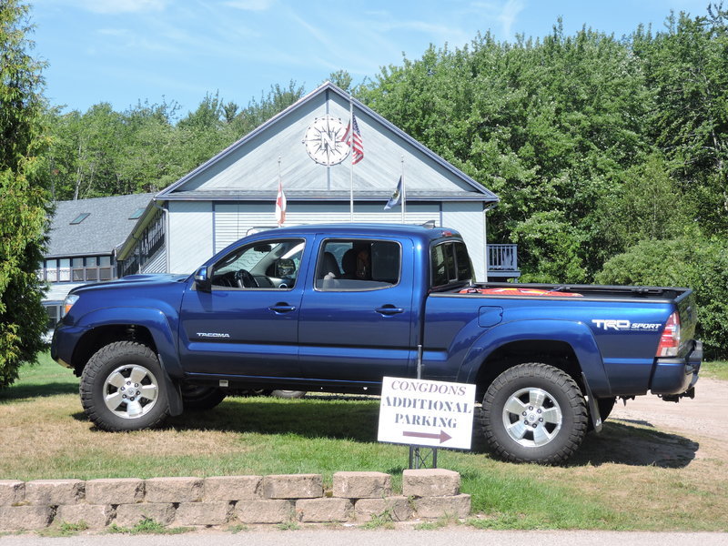

    didnt know we had pizza cutter thread here is mine 255/80/17s cooper st maxx
    and yes my winch is busted thats why its like that
