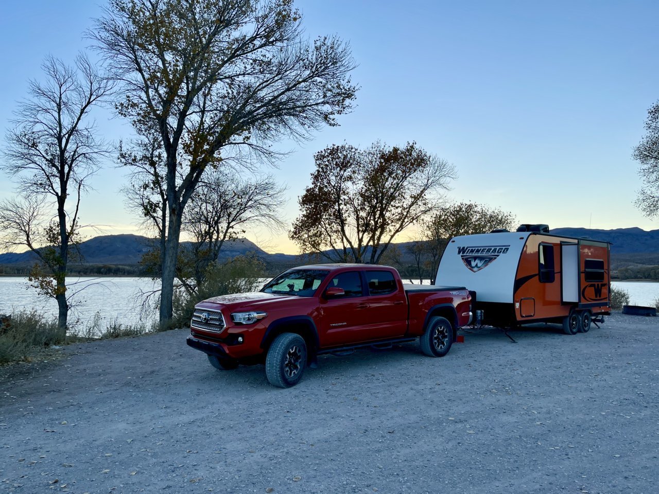

    So those of you with the cooper ST maxxs, how quiet, or not, would you say they are? If you had to tow a travel trailer any distance, would you say they’d sing too much for comfort?
    I am looking at 255/85/16 on stock wheels on a new 3” Bilstein/ icon rxt leafs lift coming in July. Unfortunately in 16” there are only 6 tire choices. My other choice I guess is the Toyo OC M/T.
    look forward to your comments.

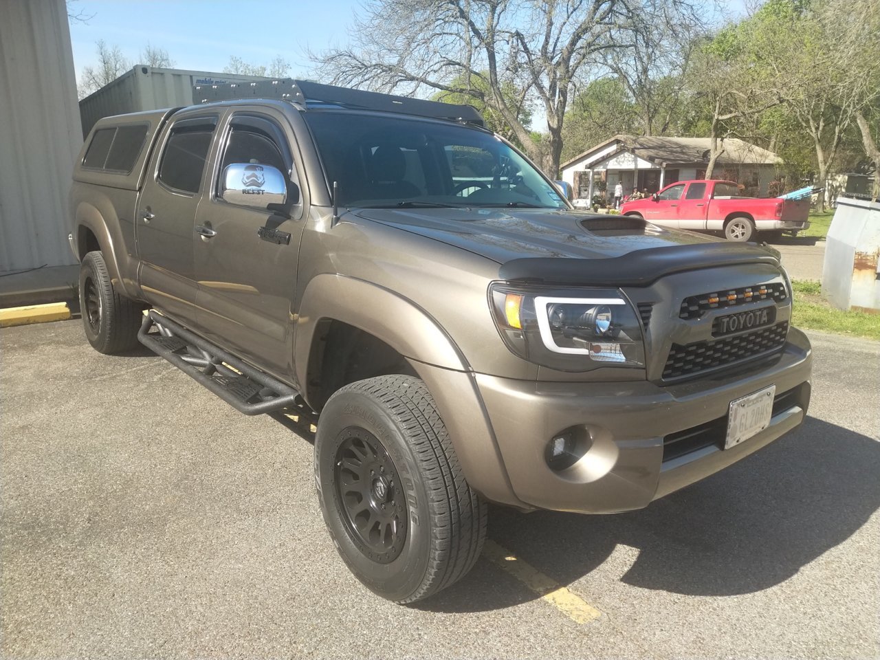

    I just upgraded from Hankook 265/75/16 to Toyo AT3 255/80/17. So far only rubbing was on the front mud flaps on reverse which I already removed. Gained about an inch of lift and not really feeling any significant power lose. I'm on Eibach pro lift kit with a 2.5in front lift, Wulf aal 2.0in rear lift and oem uca. Liking how the tires fills in the wheel well.

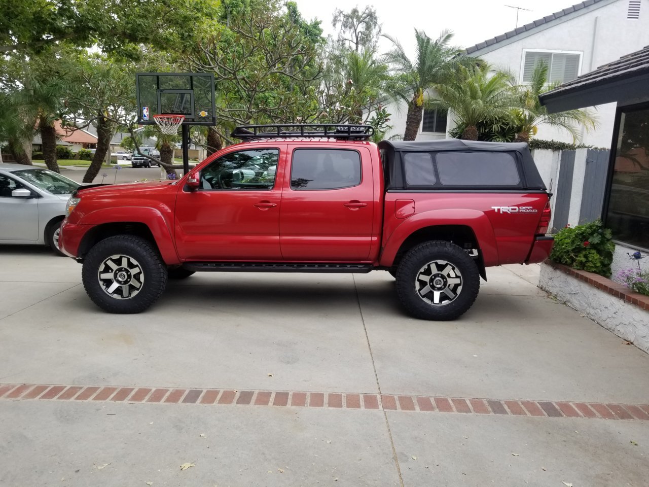

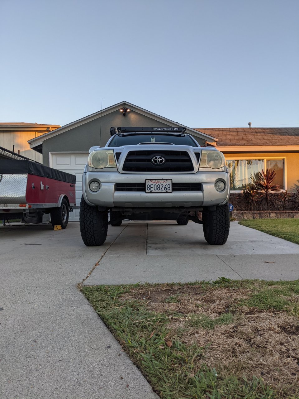

    Toyo AT3. So far they feel good and look great. Slight rubbing on front inner fender plastic pieces when reversing and one weird angle. Everything else clears. Running 17x8 with 0 offset. I have a feeling I'm going to be lacking power when going up the mountains and towing my lightweight camperPXL_20210626_010559991.MP.jpg PXL_20210626_025311161.MP.jpg
