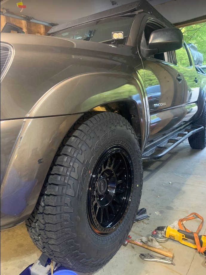

    The truth is people don't usually cycle their suspension then they post online then it fully clears. Lift matters 0% on fitting tires. It comes down to tire size, wheel offset, alignment, and the cutting you do.
    This isnt quite at full bump

    I have a feeling you will need to fold the pinch weld to fully clear. I have 2nd gen so I am not 100%
