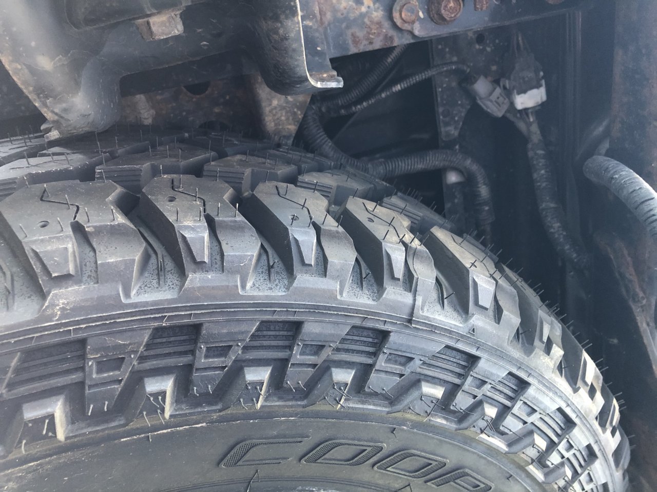

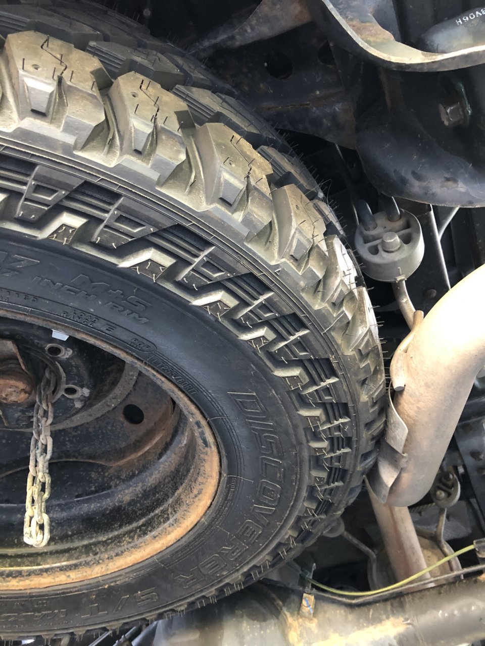

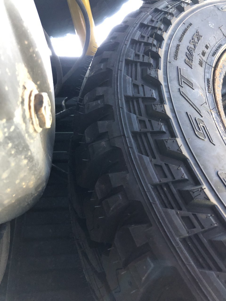

    4C325F8A-8747-44C7-888F-E1612A368530.jpg 01FF222A-D8C9-47AE-AEC9-64AF1EF1A215.jpg 255 80 17 ST Maxx’s fit in the stock spare location...it’s tight but there doesn’t seem to be any obstructions!6B33168B-D2EE-4941-B062-6E7AA5ABB57C.jpg

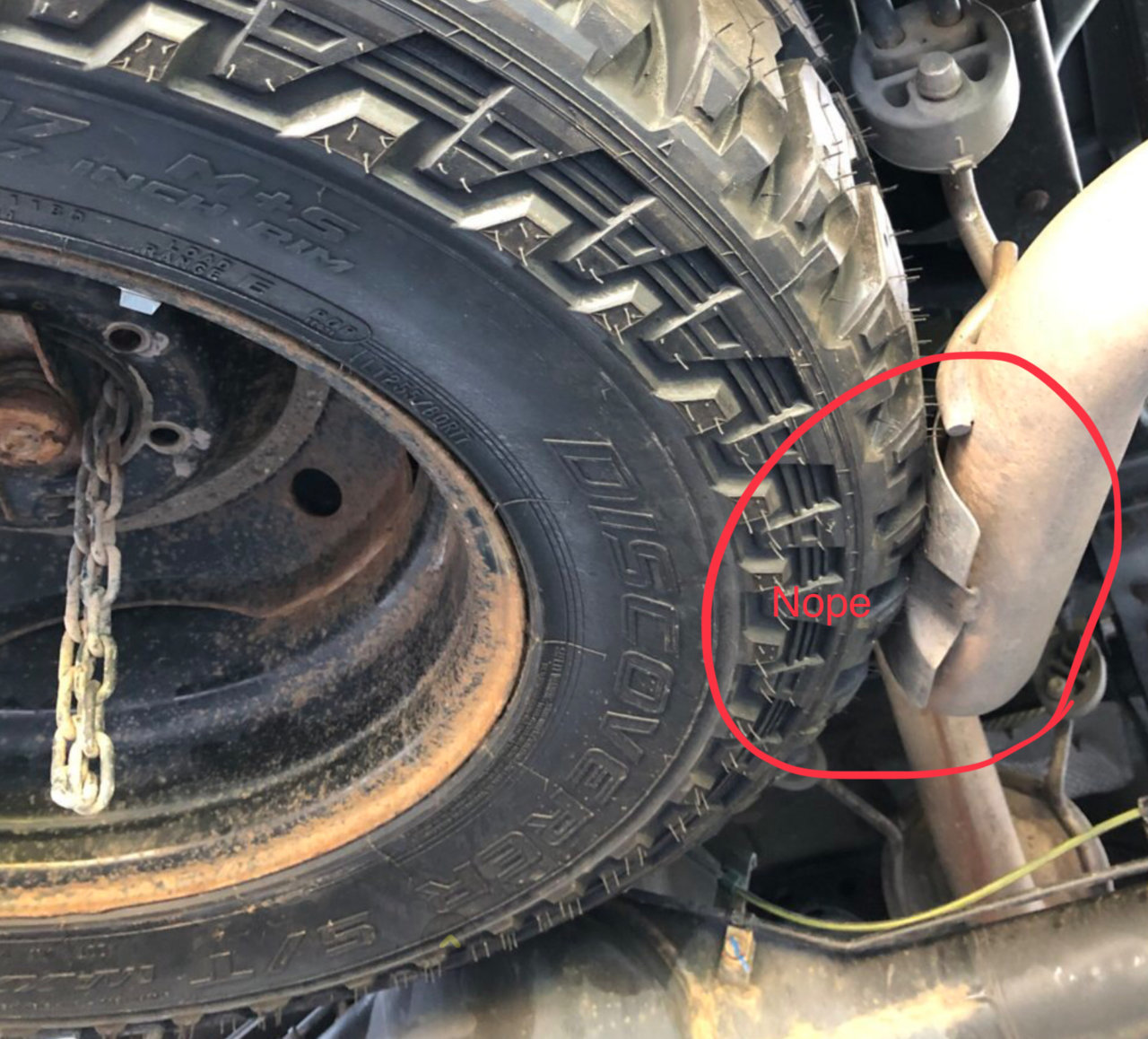

    Seems like a bad idea. Seems too close the the exhaust.
    I’m about to get 255/80/R17’s so I’m watching to see how to fit a spare.

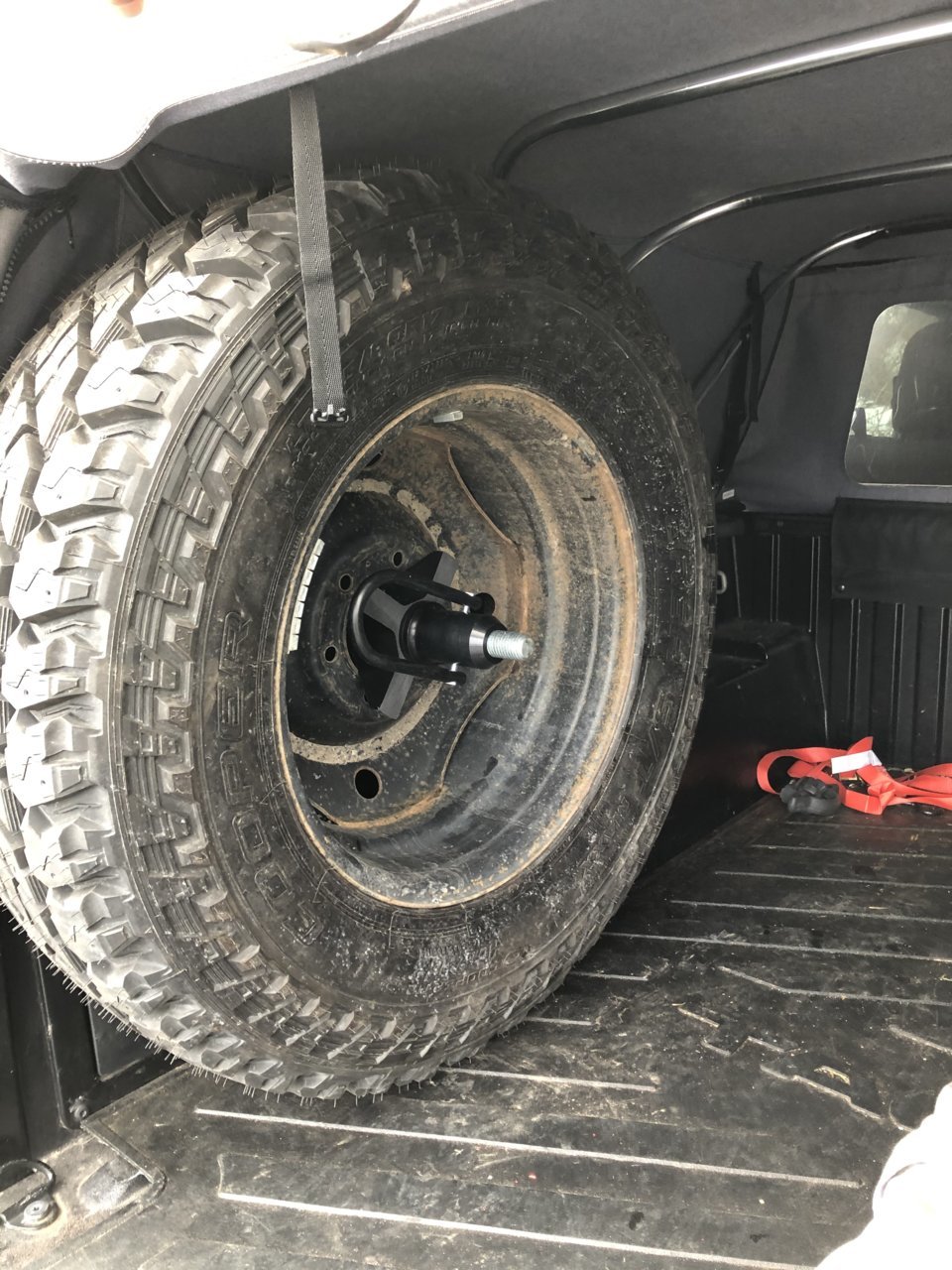

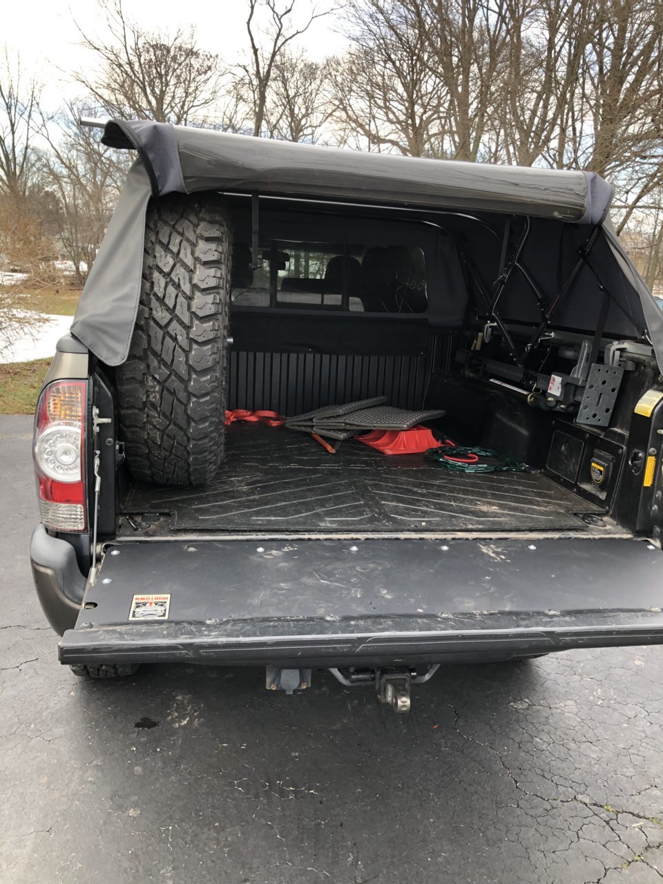

    Aight quick update. agree with the thread completely, although the tire will fit it’s definitely not an ideal spot even with the heat shield. ended up moving to a side bed mount setup. Overall I’m happy with it I didn’t lose to much bed space and gained alittle underbody.
