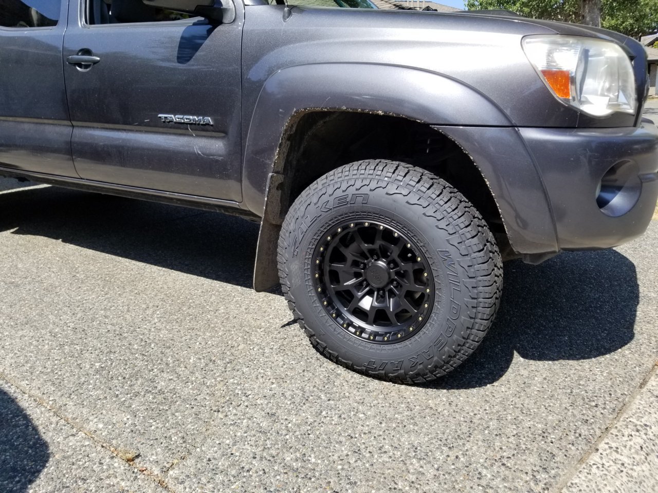

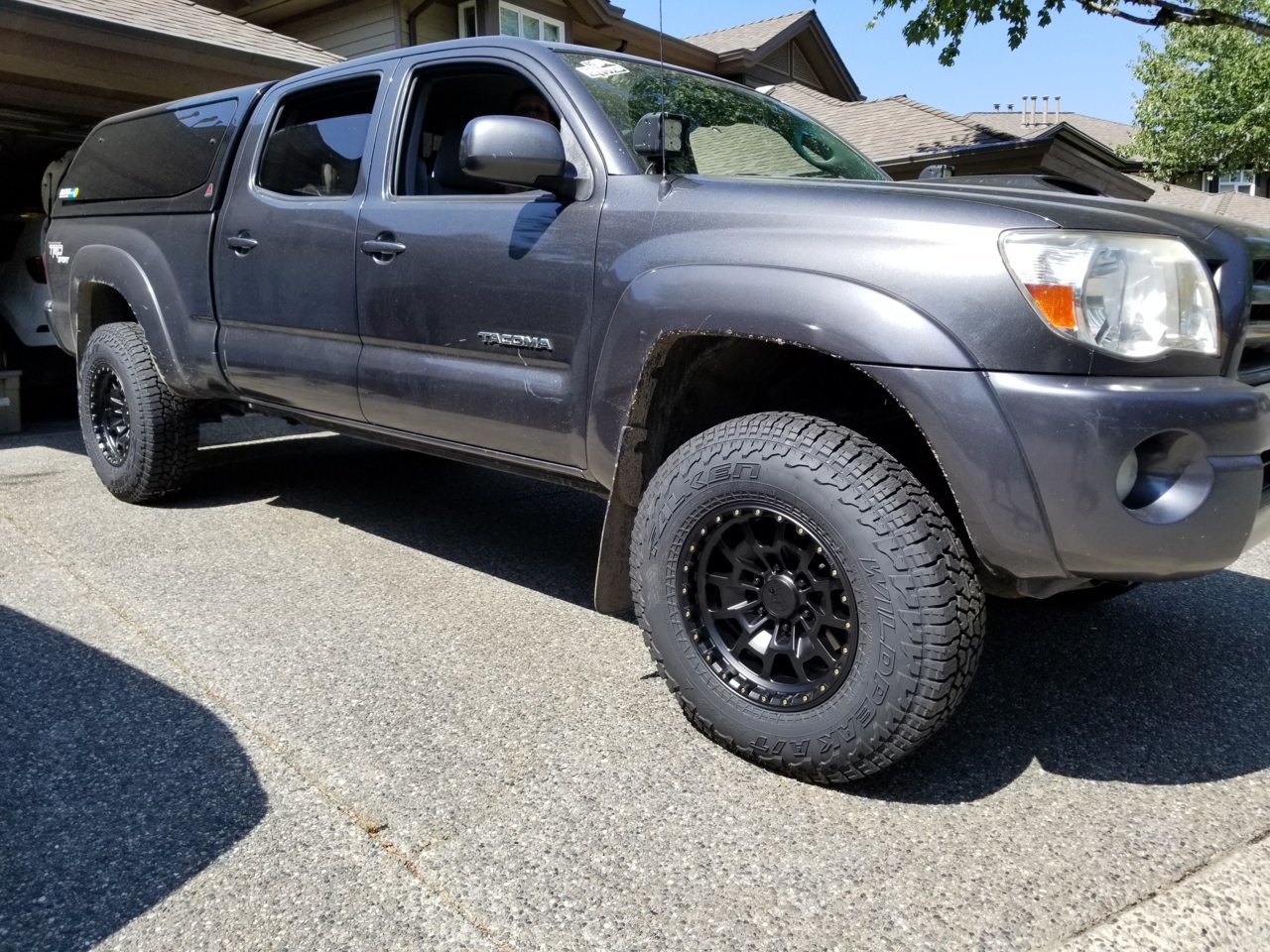

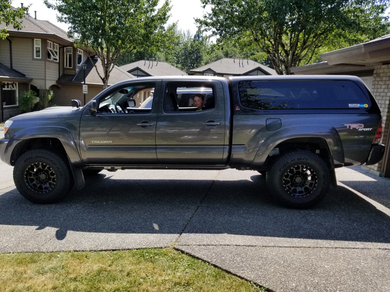

    255/80r17 Falken Wildpeak AT3W on KMC Summit 17x8.5 put them on today. Iv got 6112 on the 3rd setting getting about 2 inches with a 2"ish AAL in the rear. Little bit of rub when articulated at full crank. I'll likely finish on 4th notch and add a final 1" block on the back to even the lift. As it's a 10 ply tire it feels crazy solid with no roll issues as of yet.
