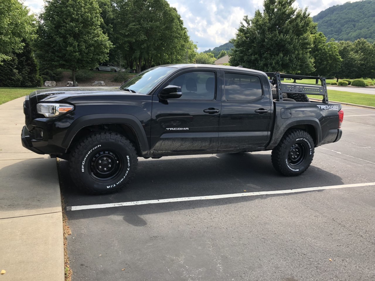

    Got my 255/85R16 BFG M/T's installed today on a set of 16" Steelies. Super happy with the way it turned out. Now just need to get the lift on!

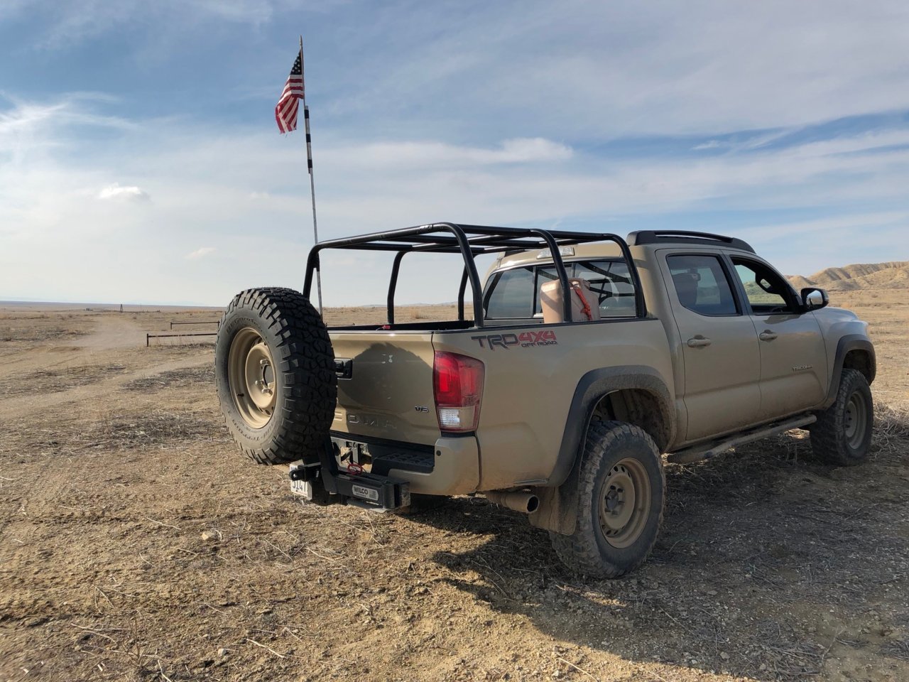

    ALL-PRO sliders and pack rack, Tepui Ayer RTT, Total Chaos Bed Stiffeners, OME 2" Med/Heavy, FJ Steel Wheels, 255 80 R17 BFG KM2s, Wilco Offroad Hitchgate Solo High Clearance
    Thanks man! No spacers.

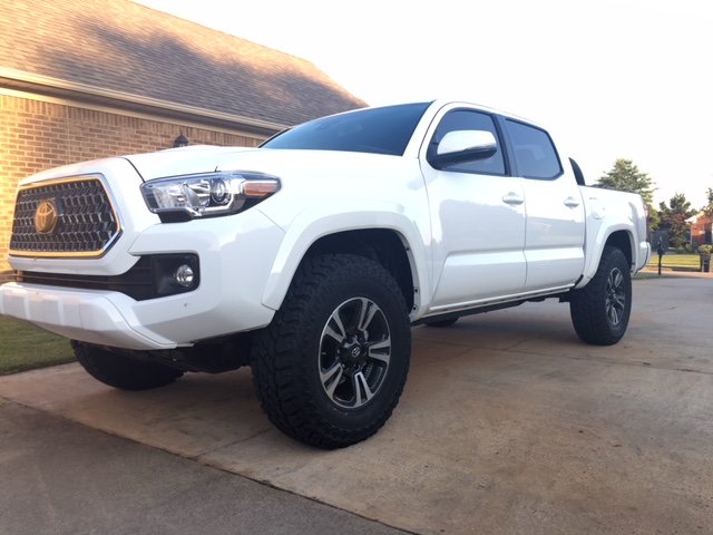

    Got my 255/80/17 ST Maxx Mounted up on my totally stock 2018 TRD sport yesterday. Stock wheels/stock height. No rubbing so far and I doubt it will ever rub. I haven't been able to really stuff them yet but did try in a small ditch and had no issues. Tires are quiet enough for an aggressive AT/MT hybrid tire. I will wait to comment on how smooth they are. I have a little more vibration than expected, but they have 7 miles on them. I plan to drive the truck quite a bit this weekend and I will report back then.
    Here it is. The conclusive evidence I searched high and low for STOCK 3rd Gen sport with 255/80 pizza cutters.

    Appreciate this info as I was wondering if I needed to go to 75 series on these tires to avoid rubbing

    Thank you!!!
    I’m so glad you posted this, the exact info I’m looking for. And a picture to boot!
    Looking to upgrade shoes on my ‘18 white sport 4x4.....
    I see skinnies in my future...

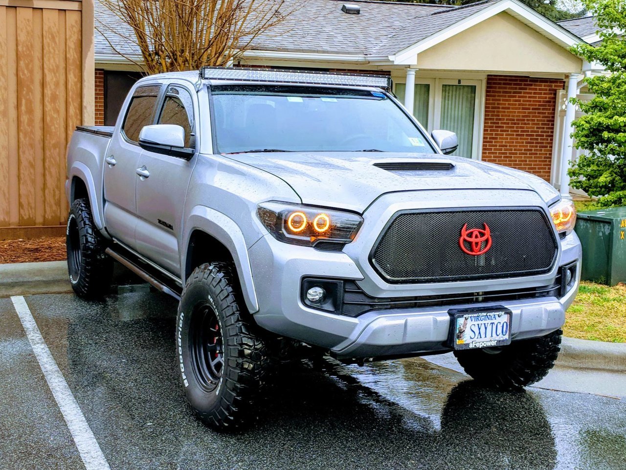

    Tires: BFG 255/85r16 MT KM2
    Wheels: 16" Steelies, 16x7 -19mm offset
    4- 10mm billet spacers used to achieve -29mm overall offset for suspension clearance and aggressive stance
