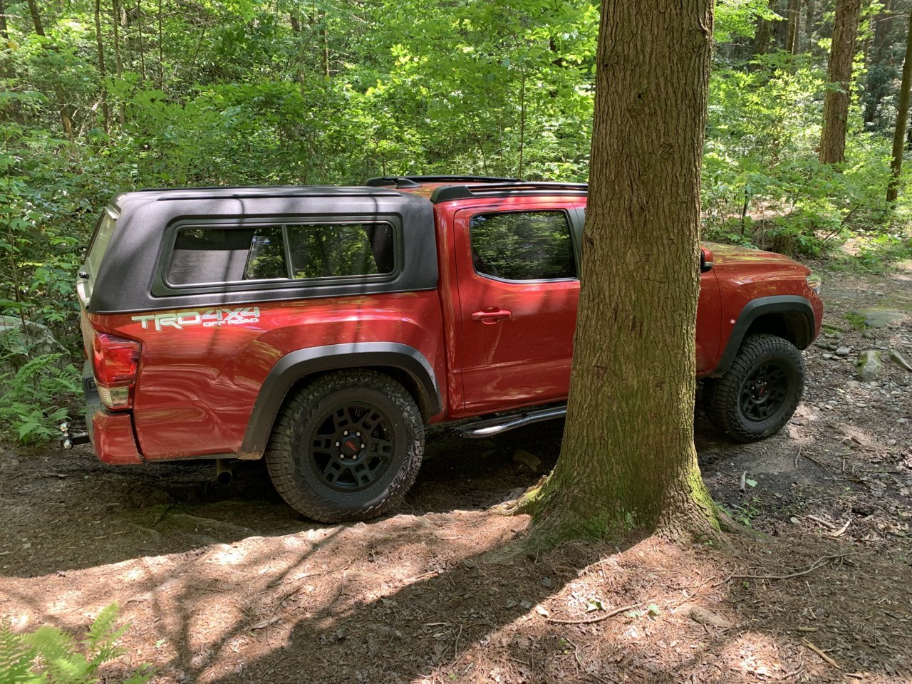

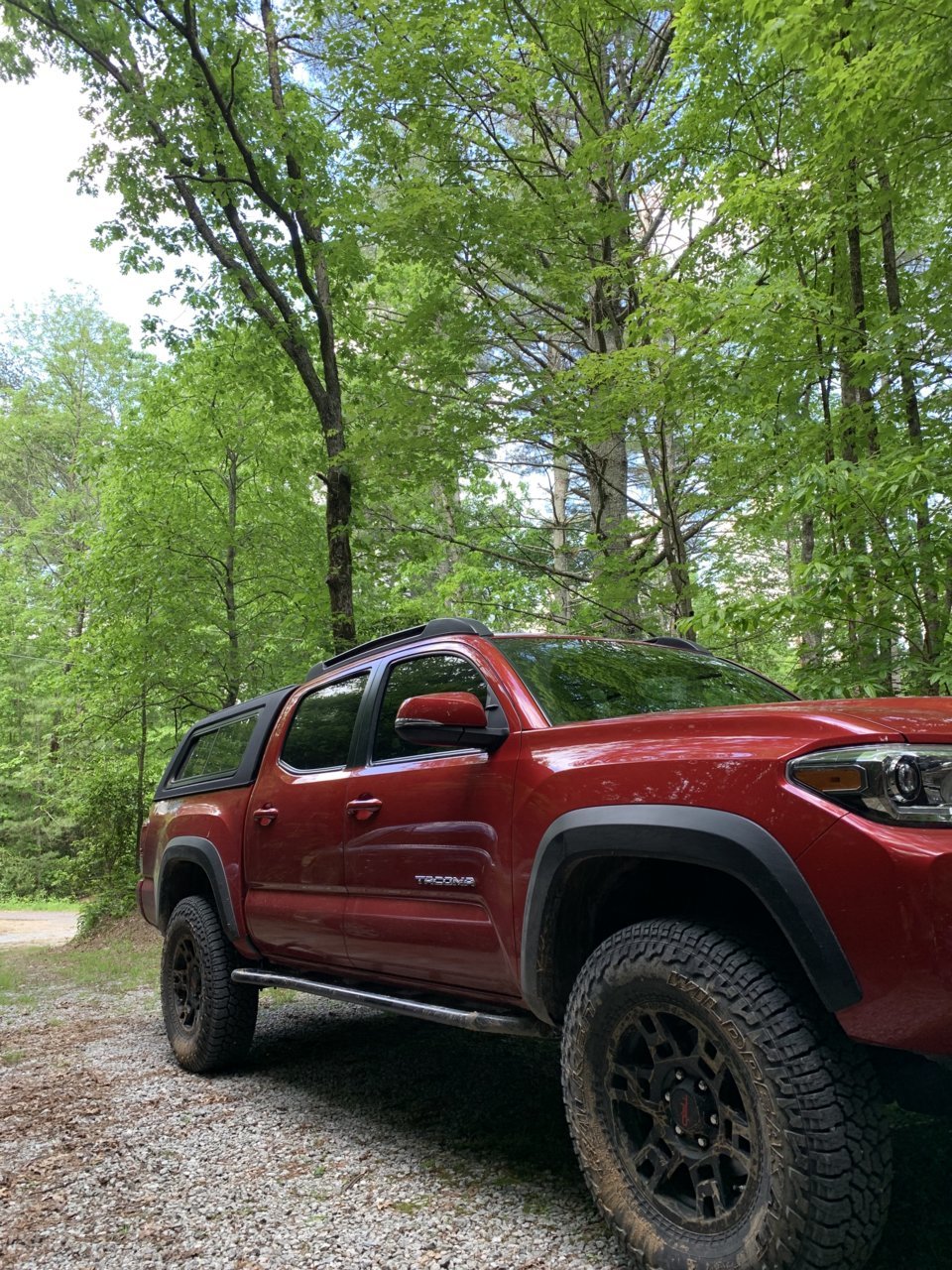

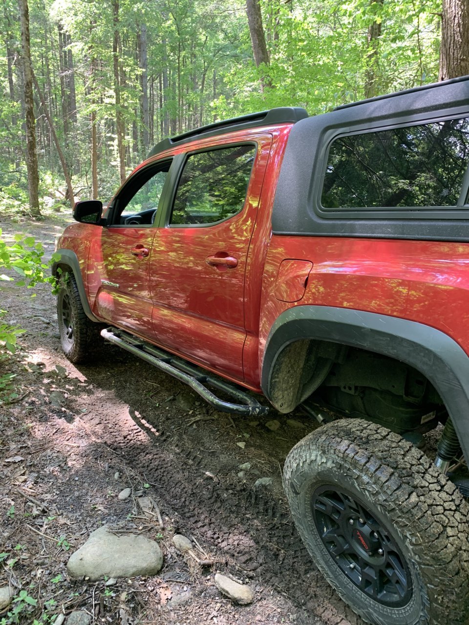

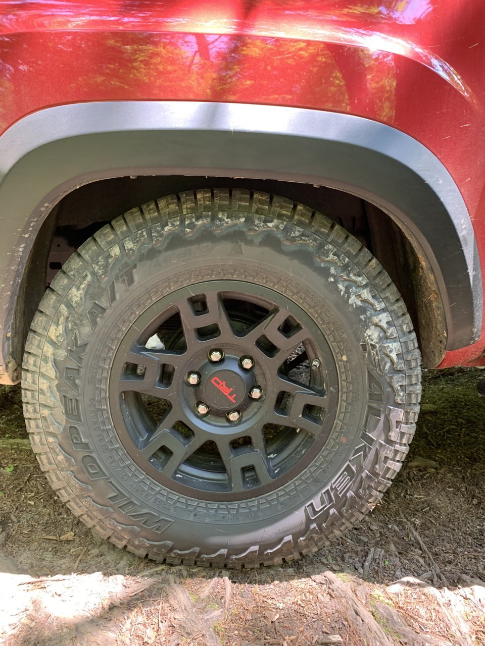

    The Sema wheels are only 7” wide. I’ve got them on my truck too with the 255/80 Wildpeaks.

    Nice! I like it. I thought I was the minority who prefer the skinny profile. I think it looks better myself. So sick of seeing all these trucks on the road with tires sticking out three feet from the fender.

    7 inch wide SEMA wheels work very well in this size. I would not go 9" Especially if you air down on trails.

    any scars on the wheels from being a thinner tire? Thinking about going to this size...thanks

    If you run 7” wide wheels you should be pretty safe with these 10 ish inch wide tires. I still managed to mess my wheels up a bit, but that’s more because of the large loose rocks I was messing around in vs tire/wheel width.

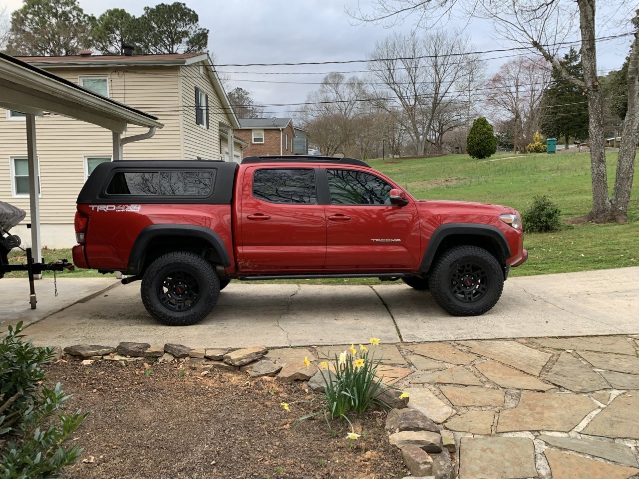

    Beautiful. I have been looking through this forum looking for assurance but wasnt feeling confident with all the different rim set ups and mostly 3rd gens posting. I have an 06 with the same 4Runner rims and just ordered 255/80r17 Falkens today. Did you have to do anything special (mold plastic, cutting) looks like you still have front mudflaps thats a positive. Super excited to see this, nice rig man.

    If you turn in reverse, turning off a steep driveway, or flex offroad in any kind of turn you will absolutely tear off stock mud flaps. Even the aftermarket flat/skinny ones would rip off of mine. Was the same deal on my 1st and 2nd gens

    If that's the worst of it I'm perfectly fine with it as my mudflaps are already all off. Thanks

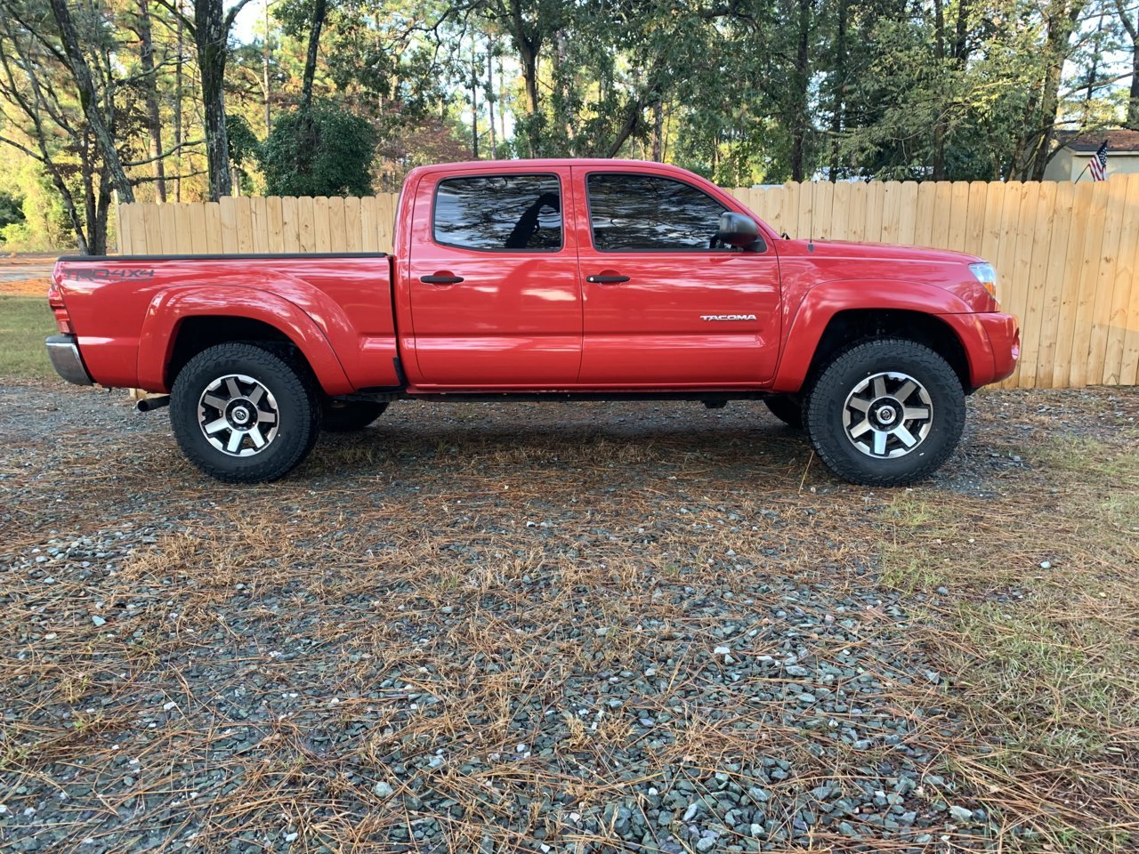

    265/70r17 to 255/80r17 Falkens. Removed side step
