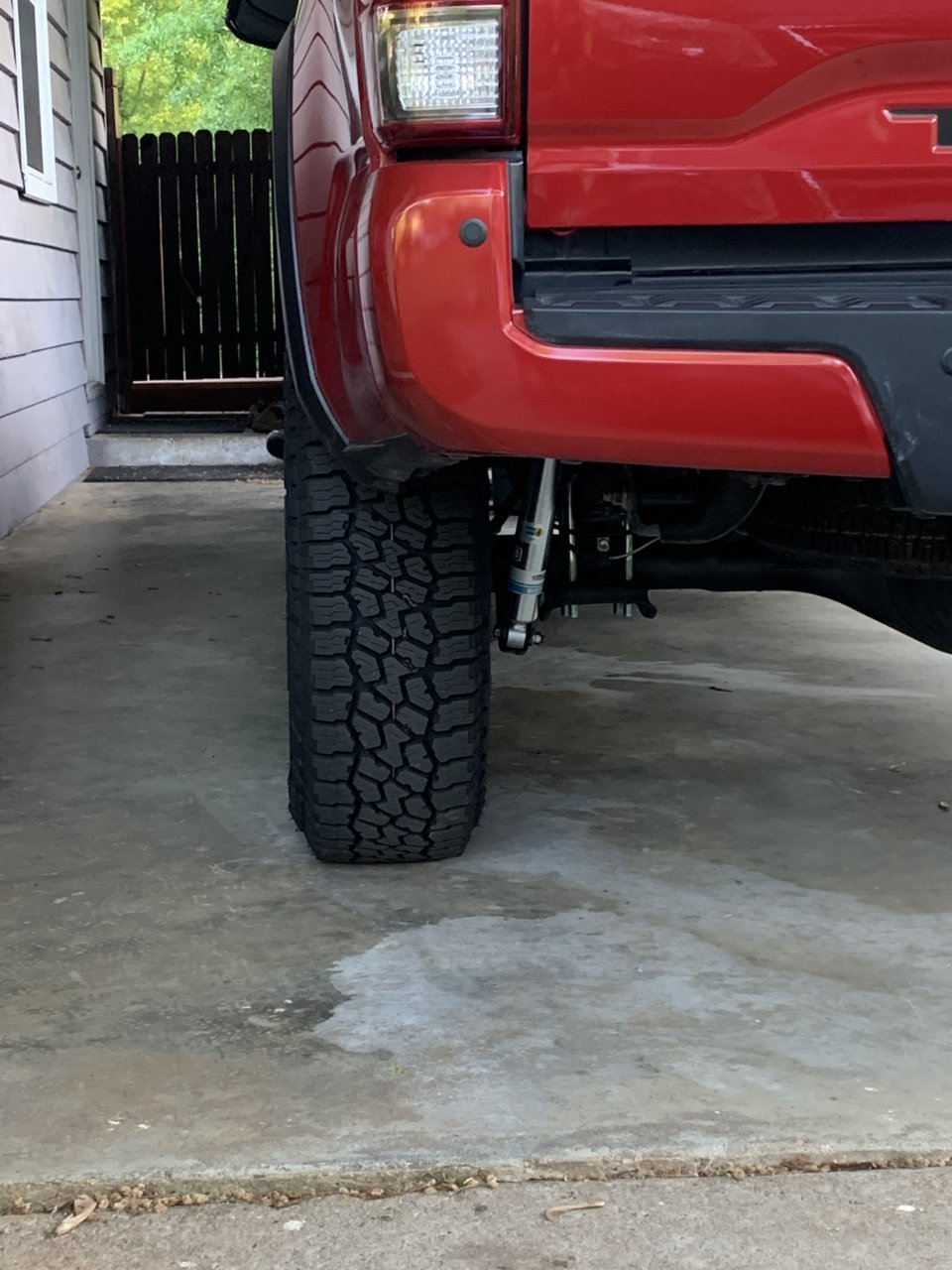

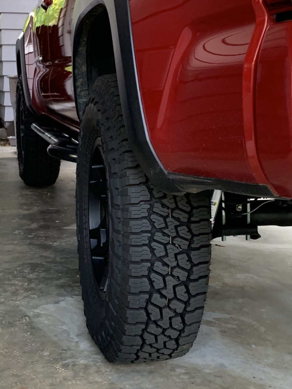

    Will it rub?... 255 80 17 on an 8 inch wheel with a 0 offset. I've got a 2 inch spacer up front and RekGen mudflaps in place of the oem ones...

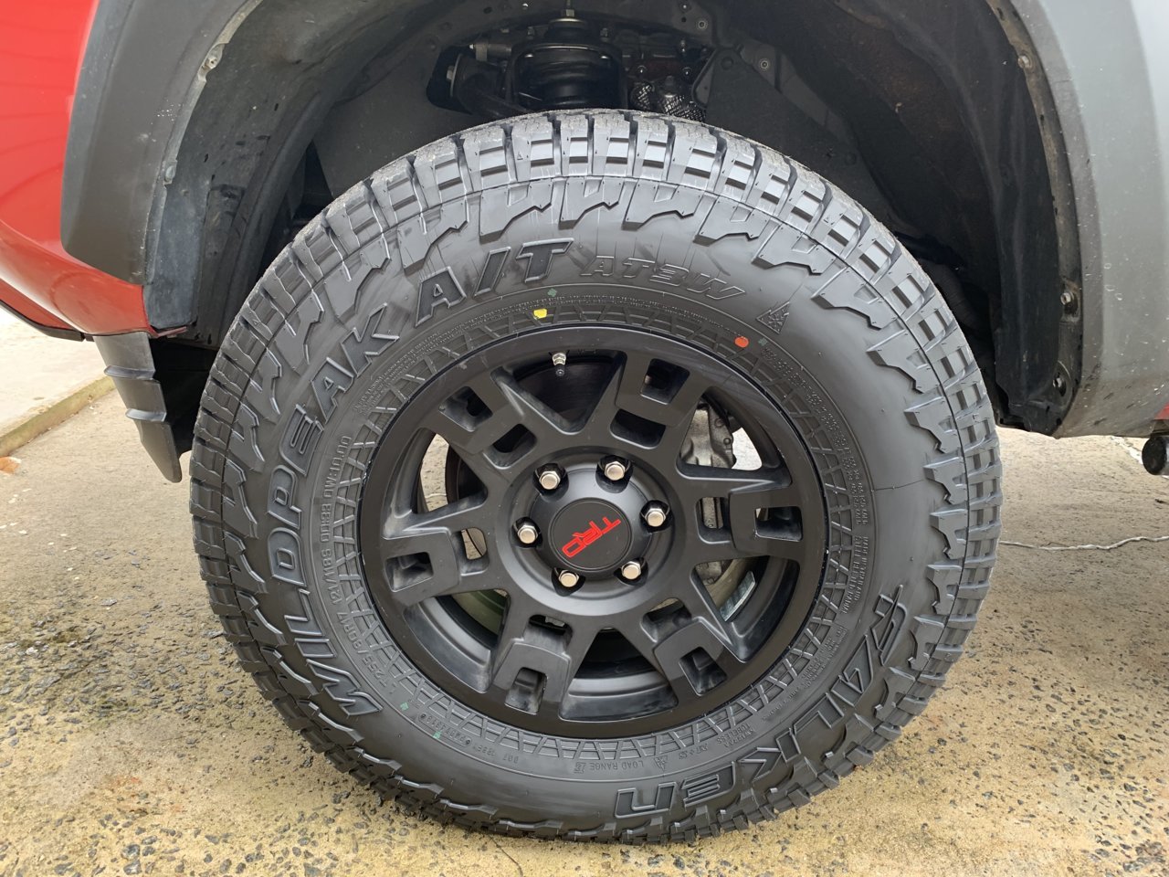

    Newest member to the pizza cutter clan. 255/80r17 Wildpeaks on knockoff TRD wheels 17x8 +15 offset. Thanks to everyone on this thread for the info. Really helped and I love how it turned out. These skinny's don't look much narrower than stock on an 8" rim. At least to me.
    Matt over @Discount Tire hooked me up with a good deal and arranged for local installation. I was in and out in 30mins.

    Look good!
    Bring them back and have them installed correctly. Yellow dot to valve stem.

    I had noticed that. Planning to for sure.

    curious what the reason is?

    its the lightest point on the tire, it should be oriented to the heaviest part of the wheel to use less weight during balancing, very few tire shops care to do it properly in my experience.

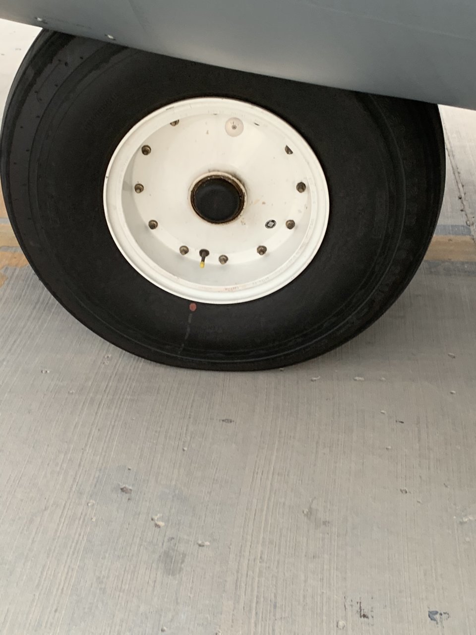

    Plenty of info online via YouTube and elsewhere if you search “red dot and yellow dot tire”. They’ll do better than me...
    They have to do with the heaviest and lightest points around the tire.
    In other random related news, the plane I flew today only had a red dot and had it aligned with the valve stem...

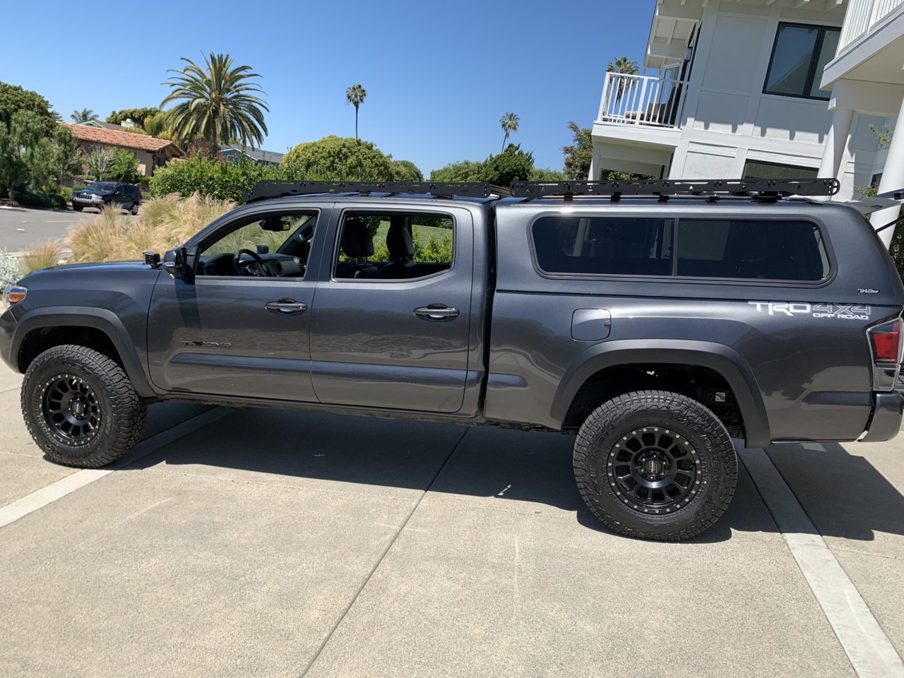

    255's, 5100s w OME, full Martin Roof Rack, Snugtop
    D9425C52-B3CA-4725-AF1A-9C3698C4A41B.jpg Just got my 255/80/17 Wildpeaks on. Love them so far. Switched from a 265/75/16 wildpeak.
