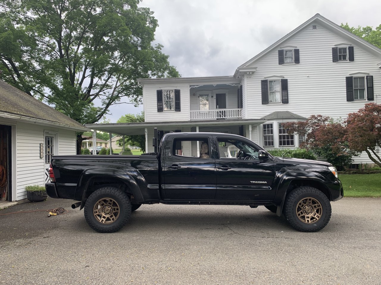

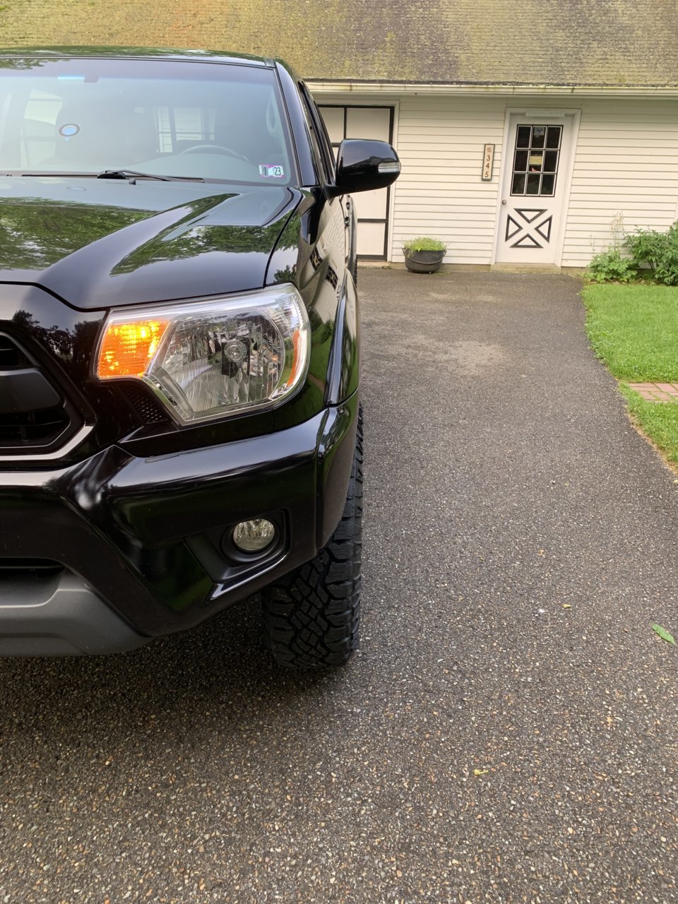

    Just installed SL rated Duratracs in 255/75/17 on TRD Sema wheels (4mm offset). My truck is on a 1.5-2” lift front and rear. Looks exactly how I wanted it to look. Definitely skinnier than the 265/75/16 I was running previously, but I kind of prefer the look and performance of a tall skinny tire.

    Pics for width, track, and tire poke reference.

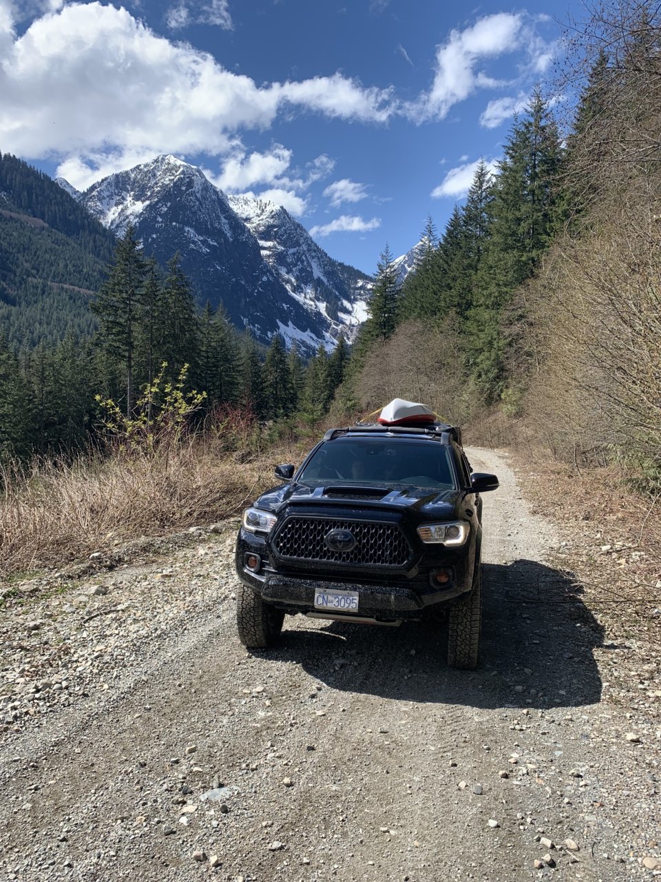

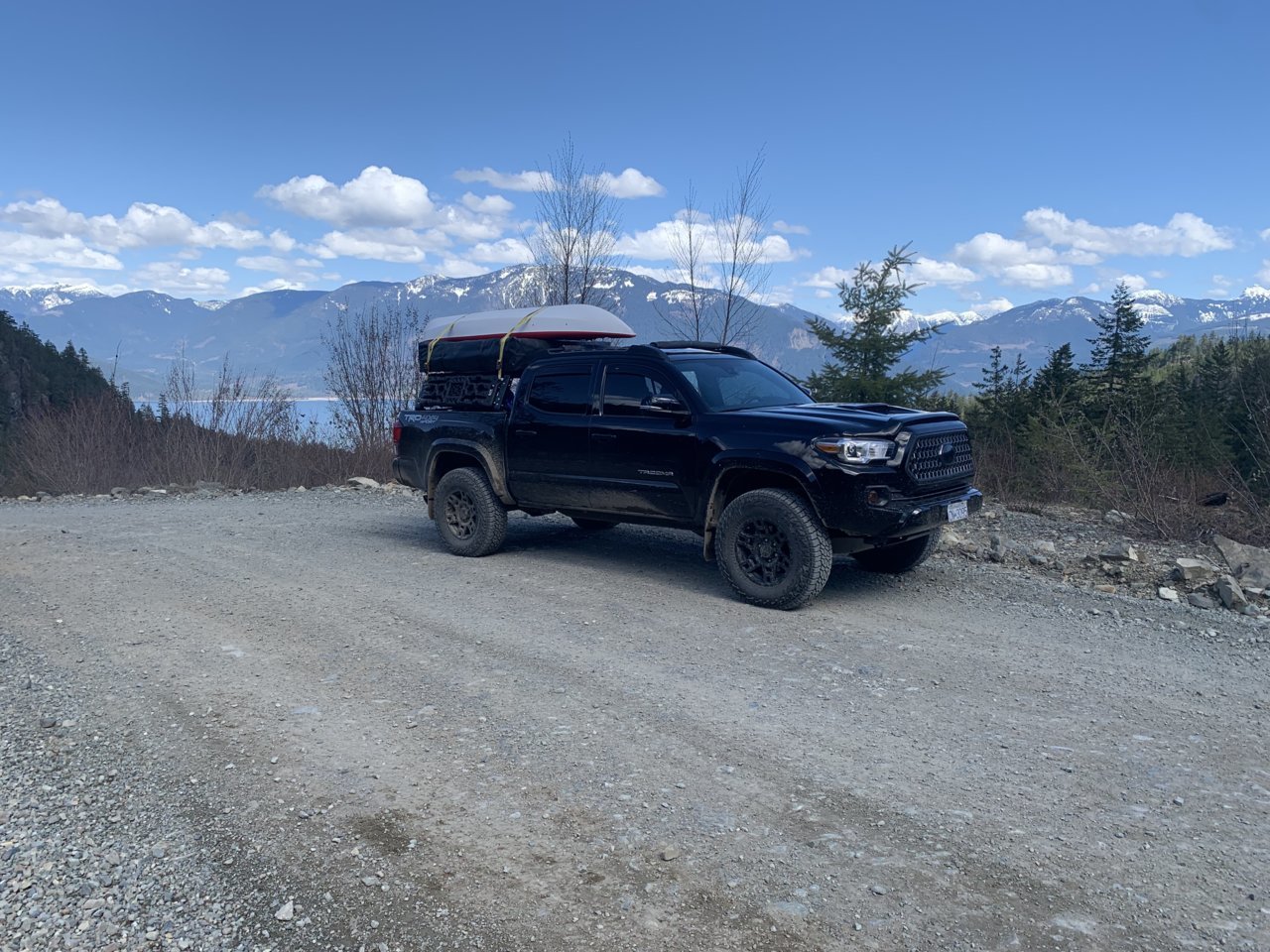

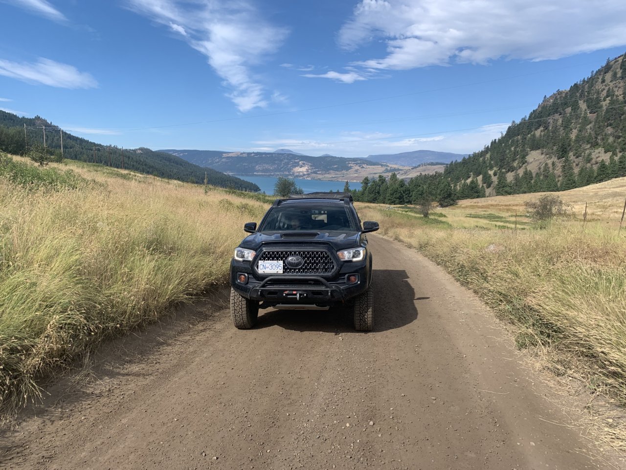

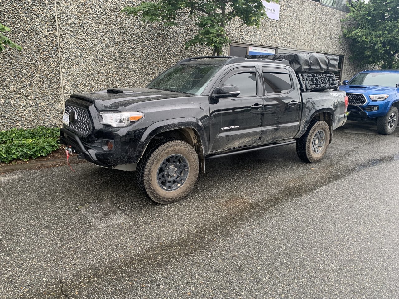

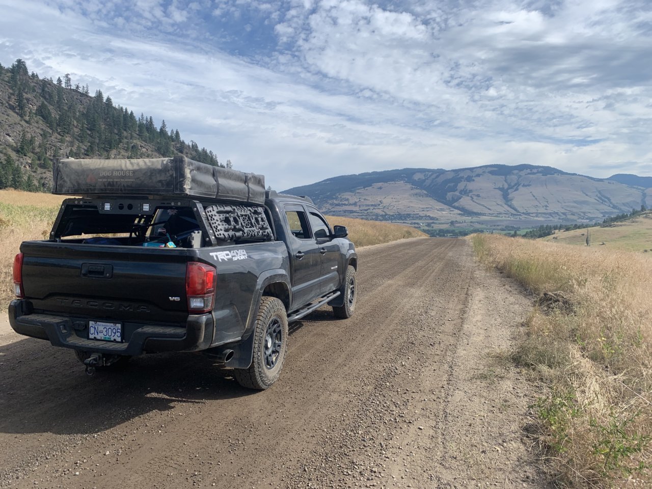

    -10 offset increases the scrubbing radius. I would say you will rub for sure, probably will need to trim fender liners.
    I have zero rub at full articulation off-road, even with mudflaps. It’s great

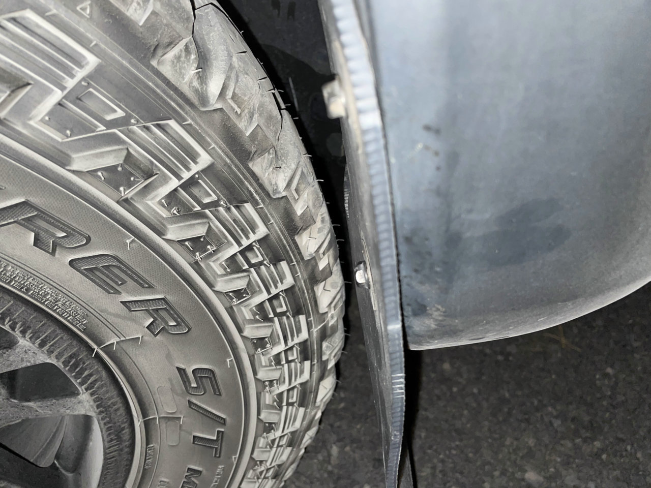

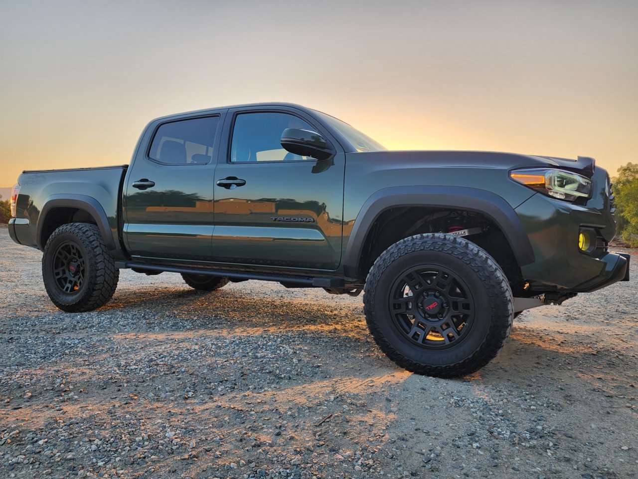

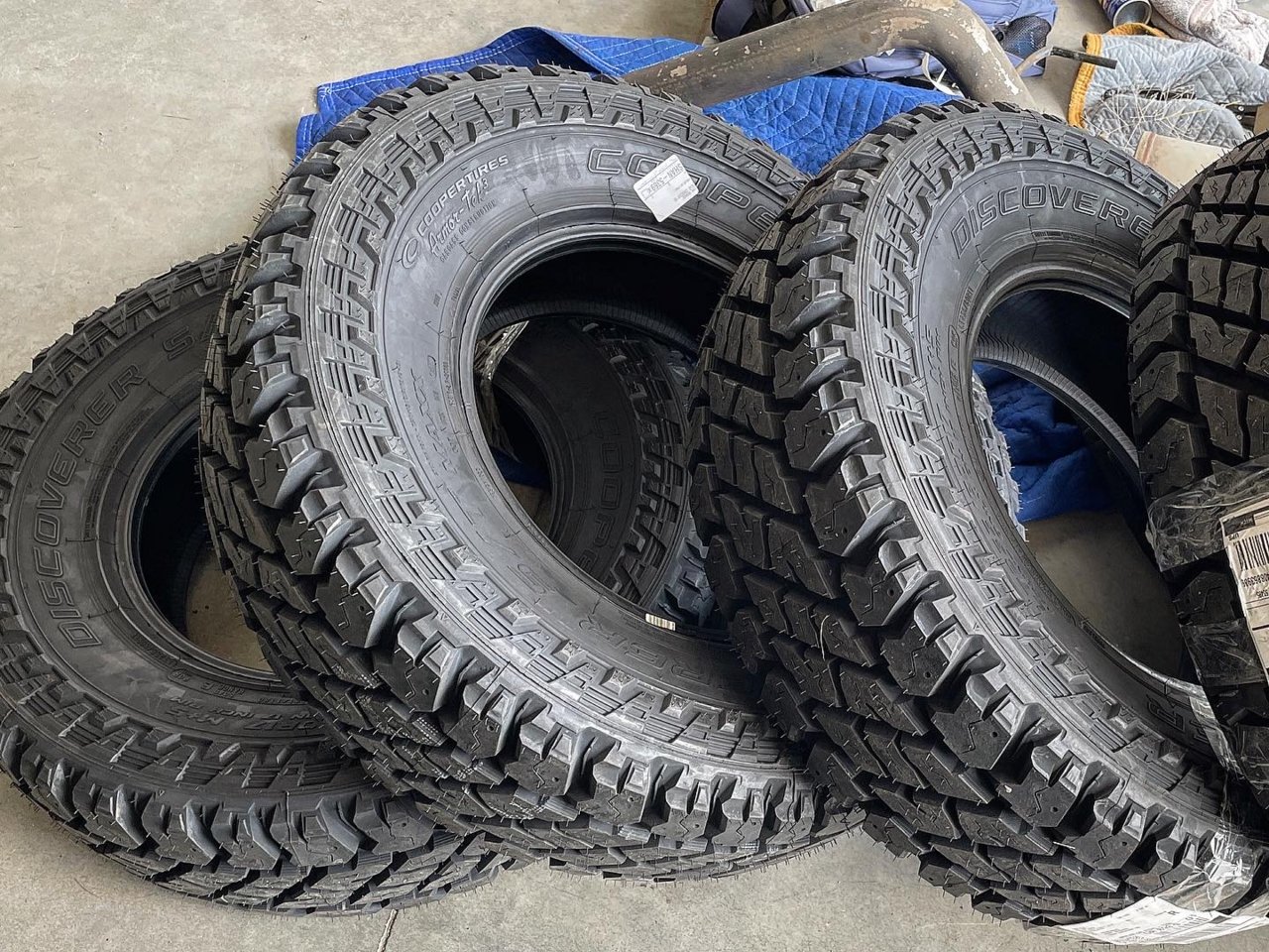

    just got mine ... love'em so far ... looks even better in person ... here's a few pics ... wondering if it will rub with the mud flaps though .... i did some melting and zip ties -there's almost a half inch of space -my fingers barely fit.F7486B32-531D-4728-81A6-BE8E1704CB90.jpgIMG_4606.jpgA36F3271-2E94-44A0-BB62-253E7013643E.jpg2FC09269-ED44-4C35-85DF-401E4CDDB30B.jpgFB4BA893-C3AE-497F-8D03-5370A06BF855.jpg573D28AD-99A4-401A-9474-76C522166366.jpg

    what did u do to get ur mudflaps to not rub? 255/80s, right?

    Man, looks great!
    Im running 255/80/17 wildpeaks with stock mudflaps and no rubbing whatsoever. Coopers do run like a quarter inch bigger so that’s why.

    Thanks -I appreciate it! Yeah, your truck was one of the reasons I went pizza cutter route.
    The stock flaps sit a little more flush than mine.... and I think ur half right -wildpeaks are about a quarter skinnier but are a quarter taller than the ST Maxx -fwiw ...and according to tire rack
