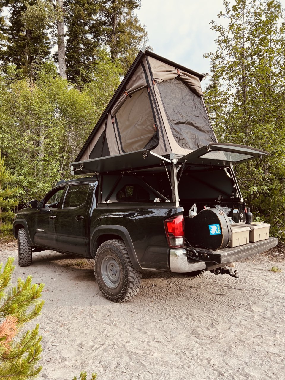

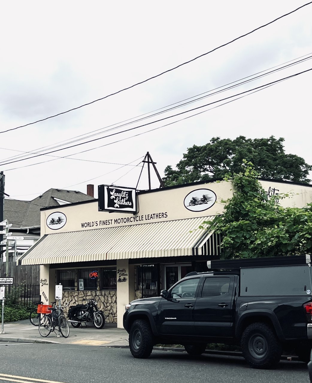

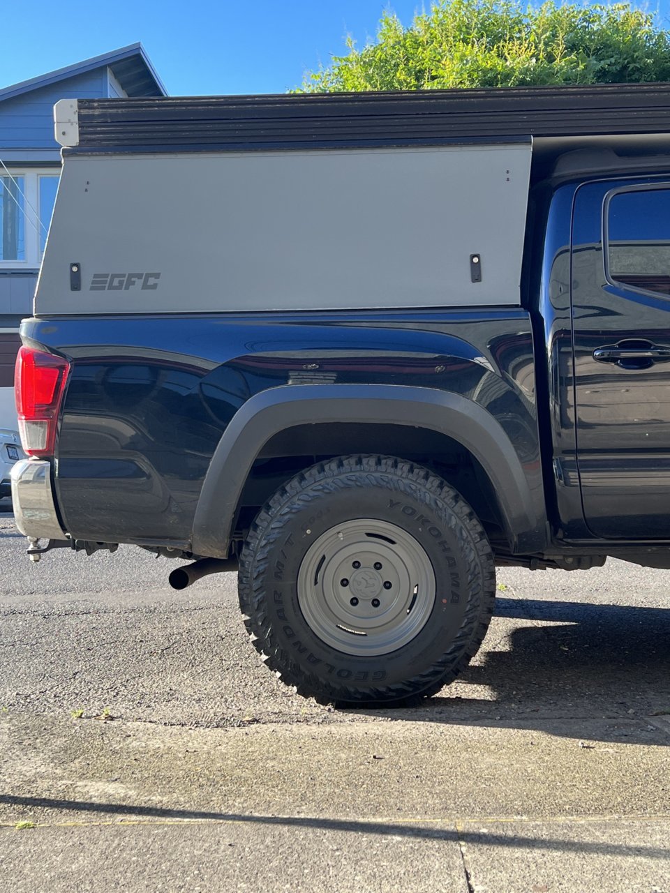

    Just wanted to add my two cents and experience with 255/85/16 tires.
    2019 TRD OR 4dr 5ft, stock suspension. GFC camper
    I bought some Yokohama Geolanders back in July and wrapped them round fifteen52 analog wheels with zero offset.
    I LOVE them. this setup puts the stance how it should look (in my humble opinion). tires are almost perfectly in line with the fender flares. there's a slight bit of wheel well rub at 1/4 turn with a bump. I can likely remedy this with a heat gun but it honestly isn't bothering me or hurting anything so it can wait until I put a little 2" lift on. the best part is that I bought 5 tires and rims and the spare fits under the bed with no modification. just pull the wheel back slightly as you're cranking it up and it sucks right into place with a very slight angle. The rub is a little worse on trails so you'll need a lift with this setup to get out in the dirt.
    New suspension will include another leaf for the camper weight on mine.
    have fun out there!
    anywho, just wanted to share some real world experience since it was so hard to find it when I was looking.

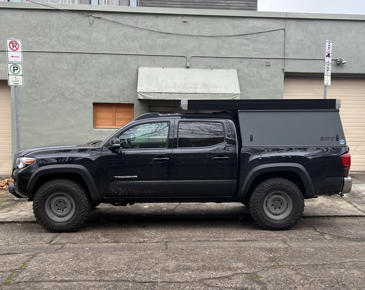

    A direct sideshot would be great. Great truck you have there. How are you liking the GFC? I really want one, but need some ventilation windows for when the dog is traveling back there. It's the only thing holding me back. But... GFC told me they are working on side panels that will have screens! Can't wait

    wouldn't trade the GFC for anything. It's the best canopy in the world that happens to have a tent on top. Endlessly useful day to day and a dream to have on the road (and off).

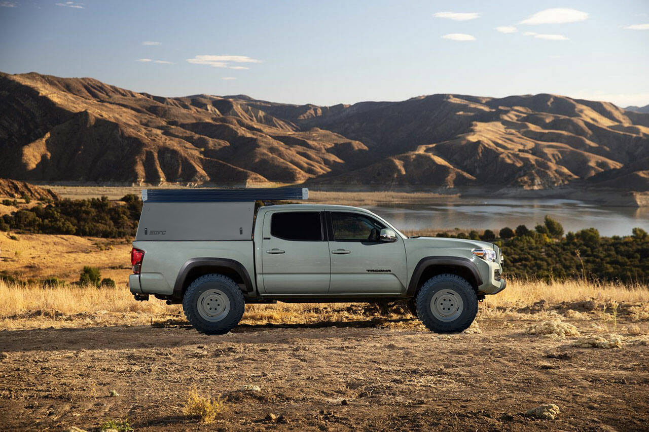

    I've got a lunar rock on order to reset the odometer (photoshopped below)... excited about the color change. Never did want a black truck but you kind of have to take what you get if you want a manual trans. IMG_4981.jpgLunarRock.jpg

    most people prefer the tan or cement trucks but I think the black looks much cleaner
    edit: those wheels look better on the cement/lunar truck though. What are those rims?

    err black doesn't look cleaner.. especially 10 minutes after you leave a car wash and the dust is already fully covering the damn thing. haha. To each their own, always. the wheels are Fifteen52 analog.

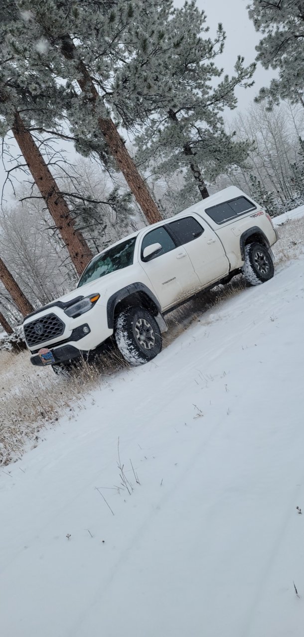

    Here's my 21 255-85-16
