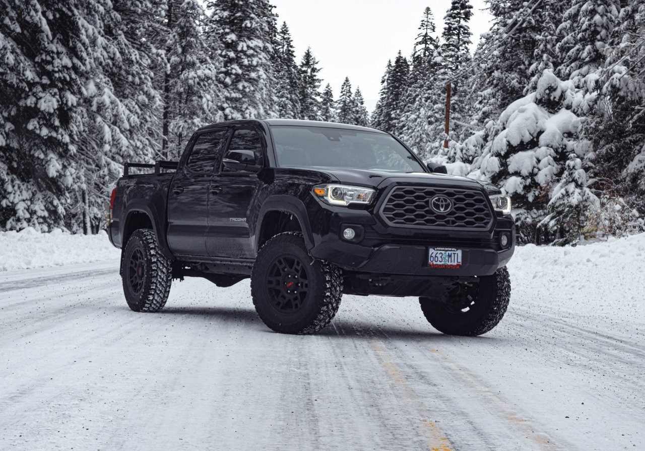

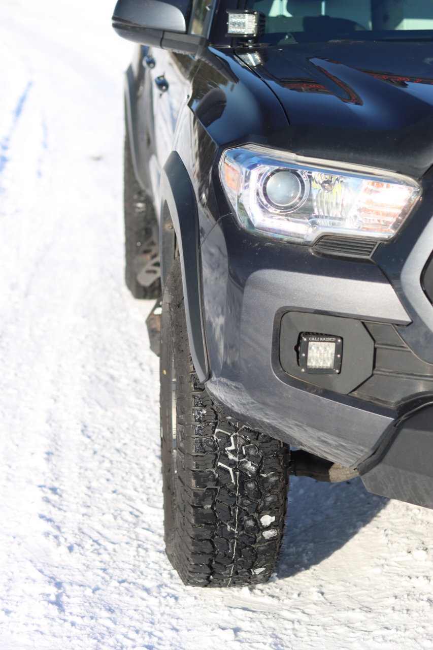

    Here's another

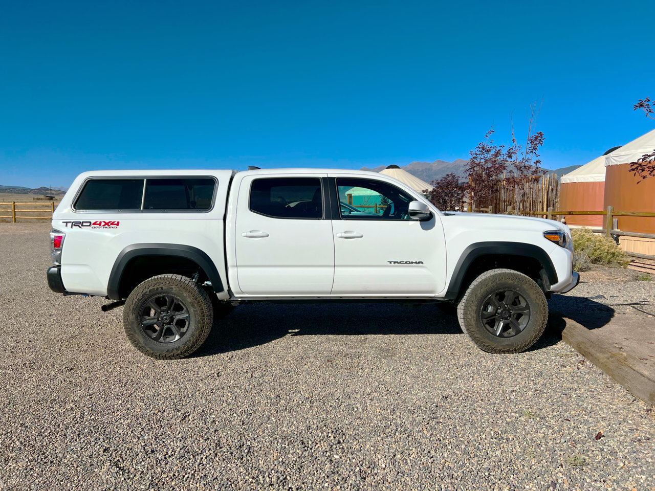

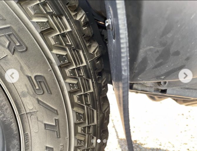

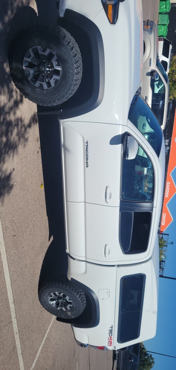

    Just wanted to give this post a shout out. After spending hours on here researching what I could fit on the 17" pro wheels with a bone stock suspension, this was the most thorough and confidence boosting post/write-up on the entire internet. I'll go the same route as you did with the trimming for peace of mind, because it's a TIGHT fit in there (third pic).
    Here is 255/80 r17 Falken Wildpeak AT3Ws on a stock OR suspension

    Yes with stock wheels. Where people get into trouble with rubbing is with different offsets that push the wheel further out. I am running 255/80/17 on 17x8 Rims with close to factory offset. I did have to remove front mud flaps. Never tried modifying them like some have. I have a 2" lift but ran them for 20,000 miles on stock suspension prior to that.

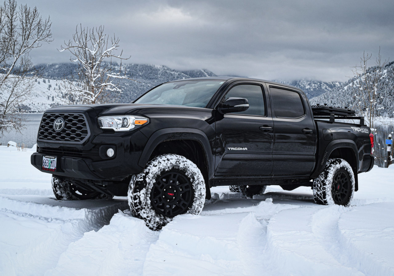

    fwiw, and incase anyone was interested... the cooper st maxx 255/80/17 at 40 psi (no added siping or studs) are doing good in various snow and icy conditions so far... for this deep snow in the pic I had to put it in 4wHigh.... I tried just auto LSD -that would't do it.... cheers!

    Your post is a little confusing. Did you try 4hi after auto-lsd (2wd) and before 4lo?

    correct ,but no 4wLow ... tried auto LCD first -in "2wd" -which didn't work .... then went to 4wHigh -which worked ... hopefully thats more clear!

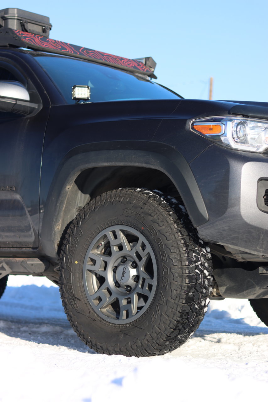

    Bed mat
    Enjoying the 4Runner wheels with 255/80r17 Falken AT3WsB68332B6-7509-4DCD-91B2-598F9CB2DA01.jpg

    I could have sworn you said 4wLo, but it’s clearly 4wHigh in my quote. Either I misread it or you edited it right before I quoted it. Anyway, I’m glad you got out. In that much snow, I wouldn’t bother with 2hi.

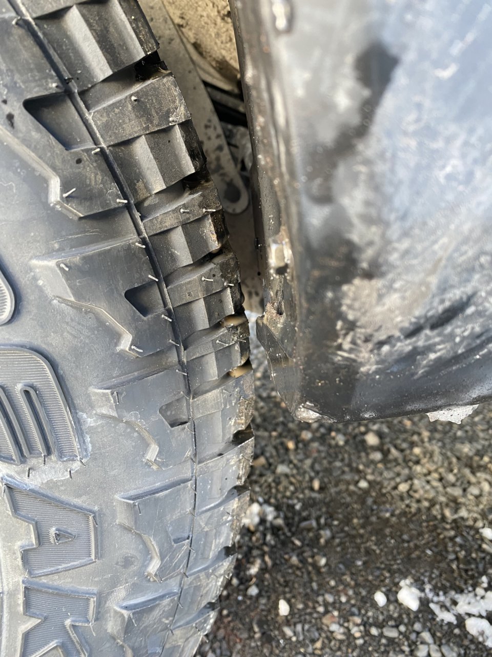

    yep -im running rekgens with 4mm offset wheels, 255/80/17 copper st maxx tires, and a lift (about 2.5" -2.8" in front and 2" in the back), and caster pushed out.... I had to do some melting of the plastic fender, bent the mudflaps a bit, and zip tied to hold it out of the way.... they major rubbed before melting and zip ties .... here is the after pic -i haven't rubbed at all ...... fwiw its worth -I found the mudflaps do nothing lol -but I like the looks
