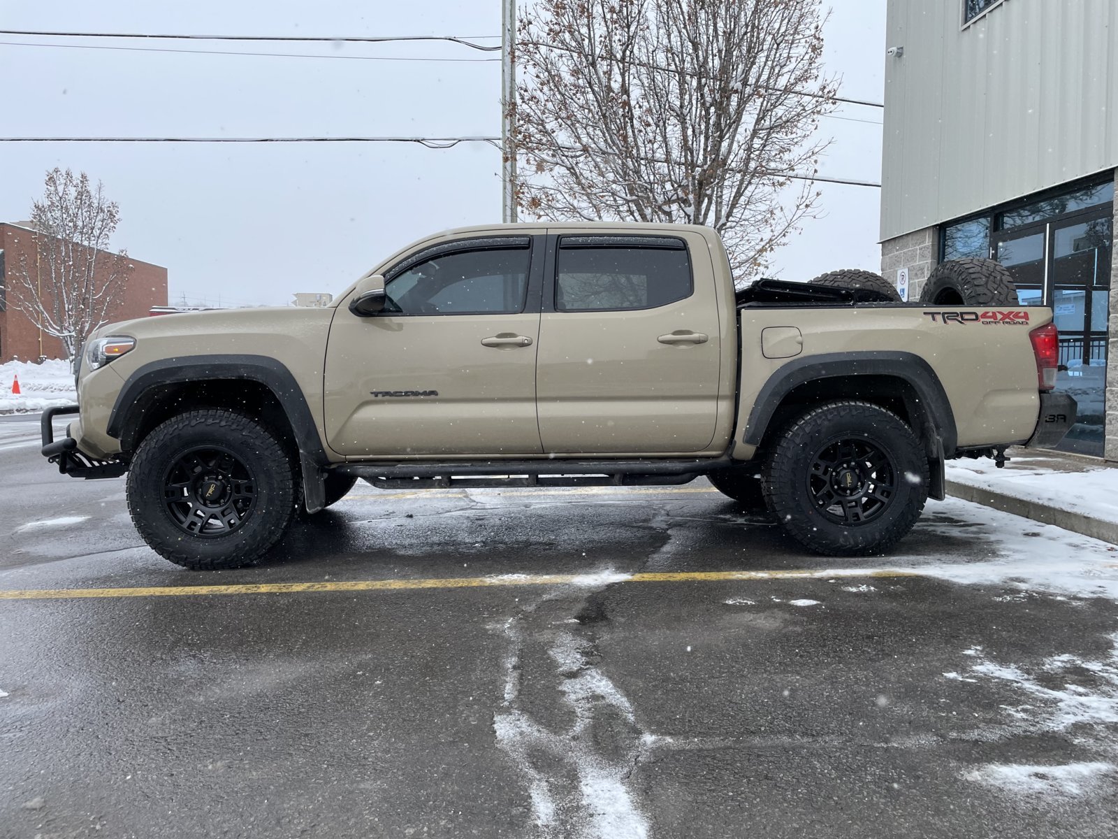

    I know this is an old post but I just wanted to give you a shoutout on how good your truck looks. This in my opinion is the perfect stance for a Tacoma. The tires are larger in diameter for clearance however the 255s are by no means too lean looking. I have a black 2013 with the same wheels and now I'm thinking about this tire size. I might still go with 255/75/17 to say in the XL load series range, but it shouldn't look much different than these.

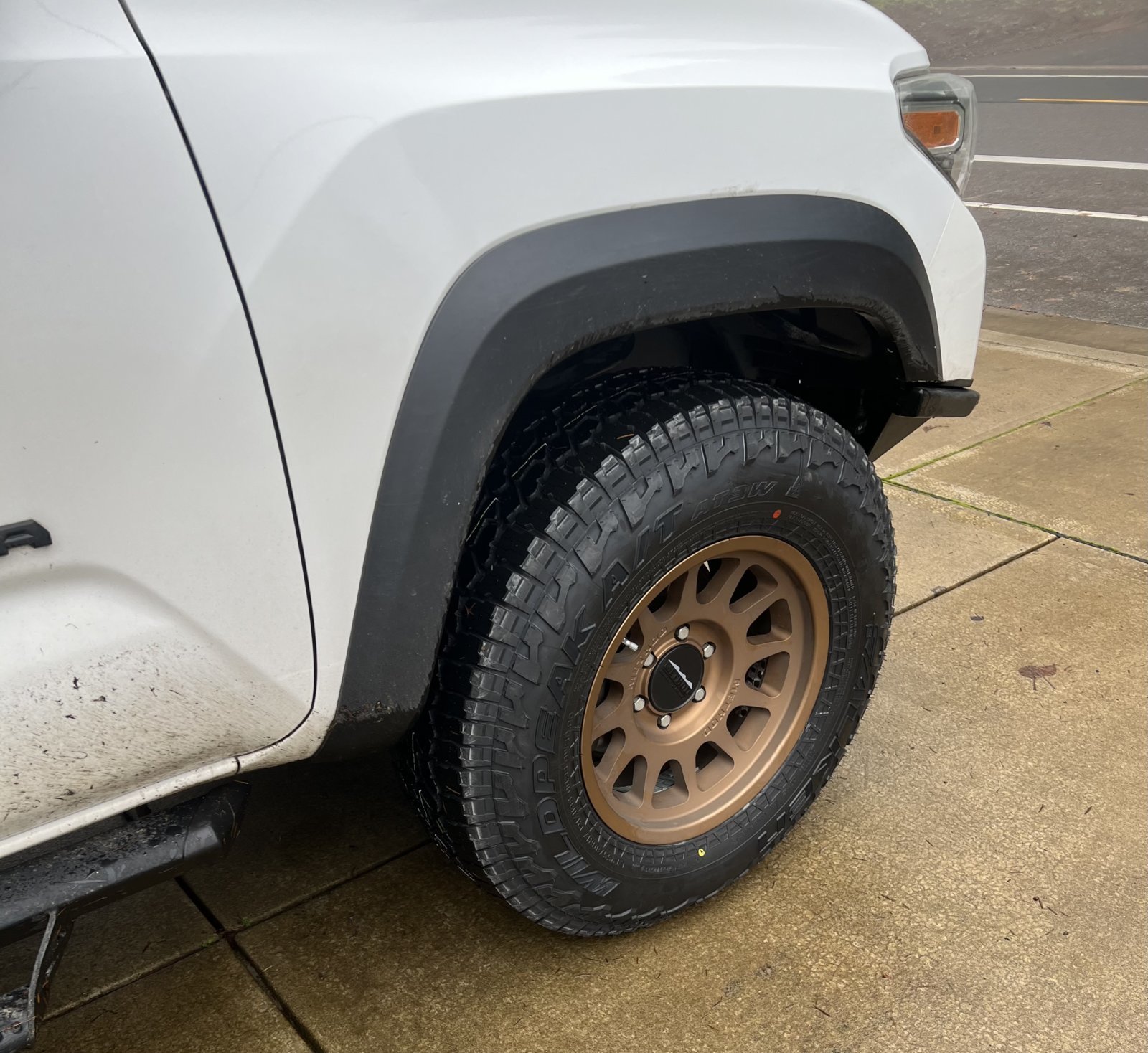

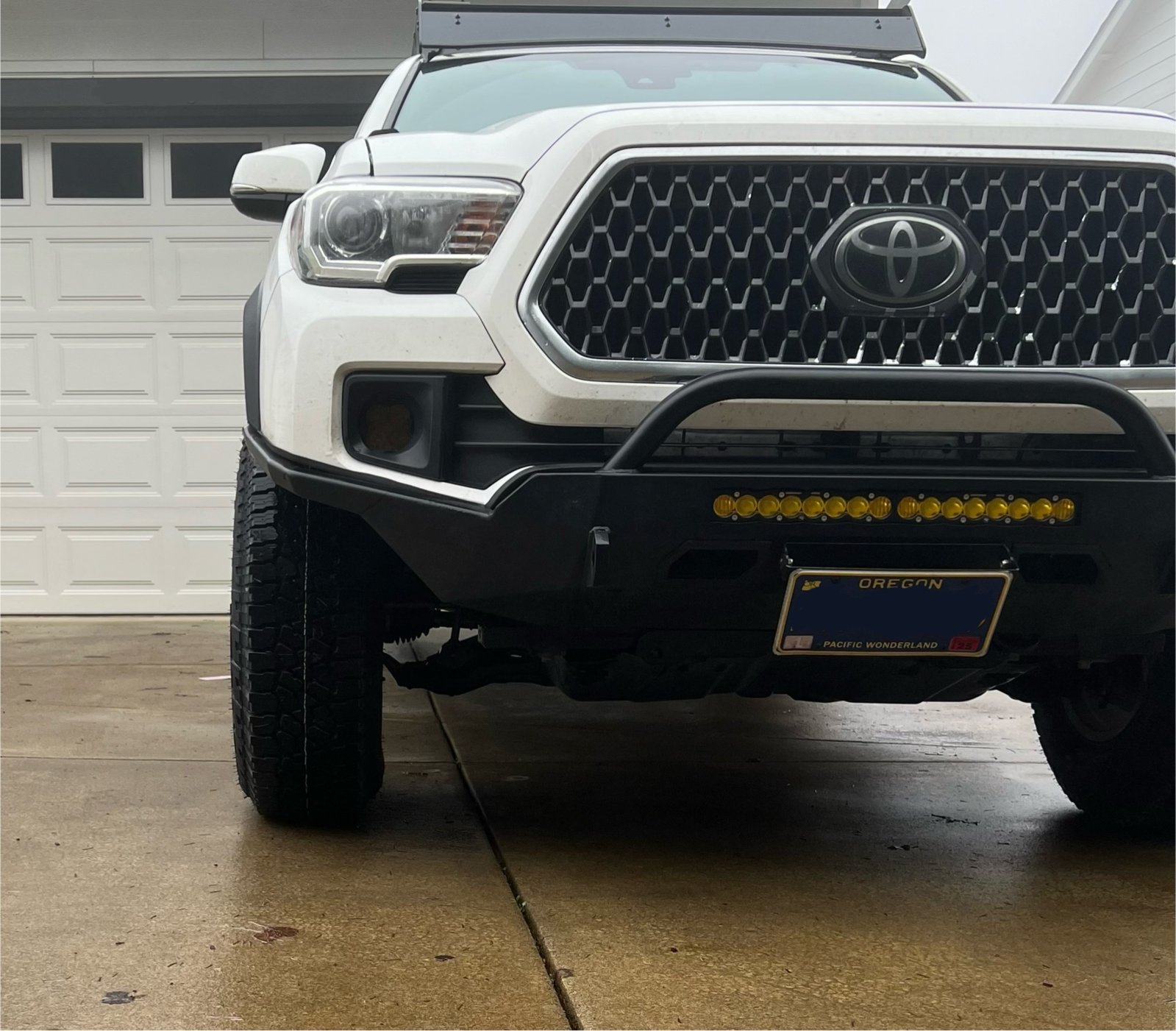

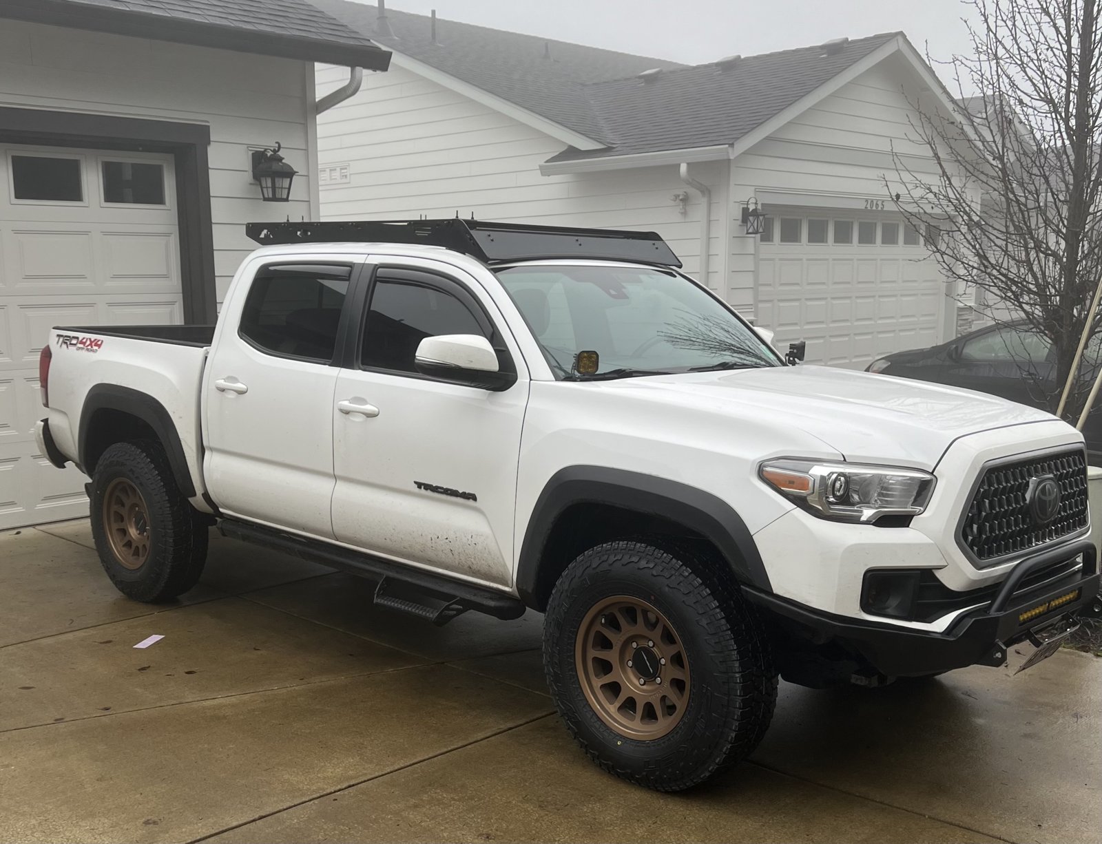

    Thanks to everyone that’s contributed in this thread. Today I had some 255/80/17 falken wild peaks installed (no suspension mods) on my 2018 OR. Not even a full day with them but they look & feel great so far.
    Came from some general grabbers atx, hopefully these do better in the rain.

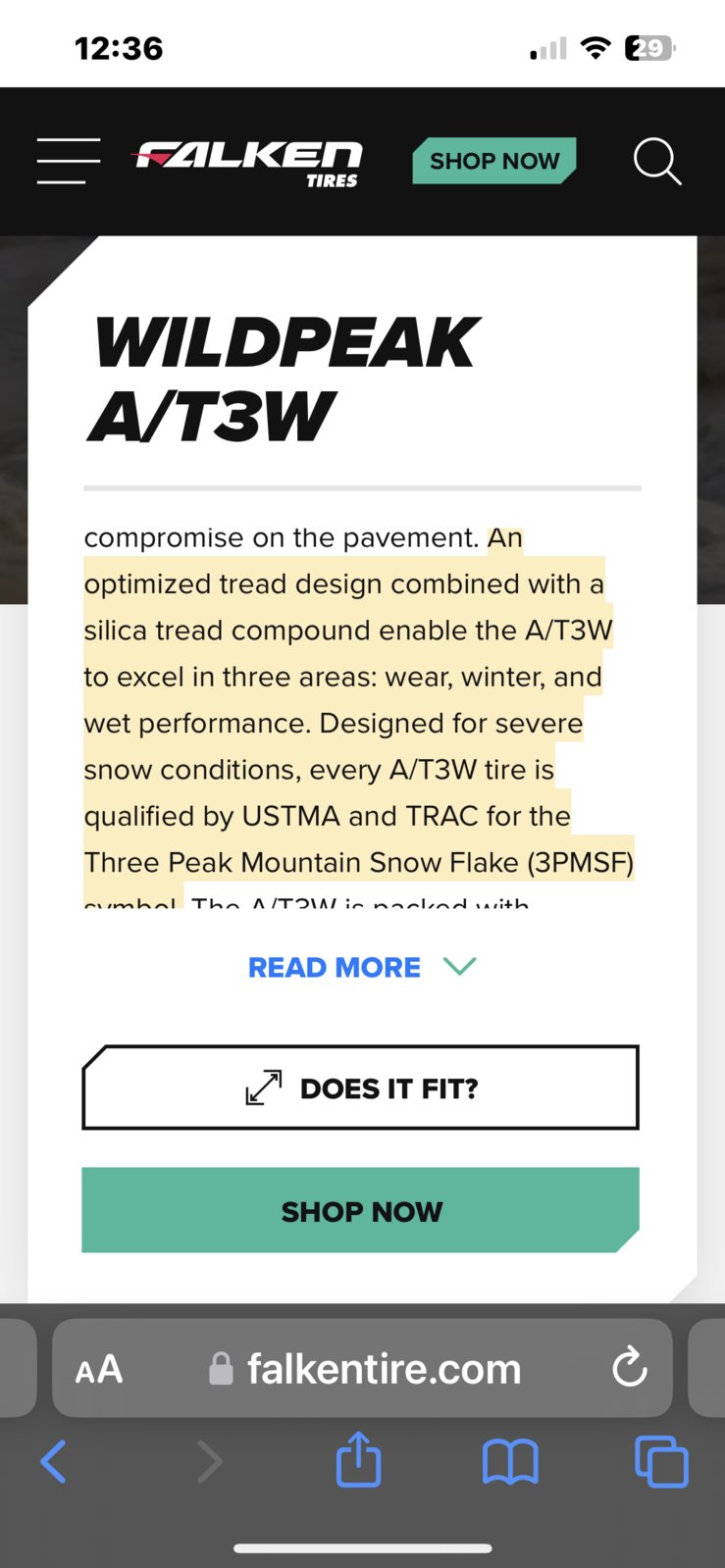

    Wildpeaks are fantastic in rain, snow and wear. That’s what AT3W stands for: wet, winter and wear.

    Those look nice on your truck,I have the same tires on my 2015 for 6 years now and they still look great,no problems.

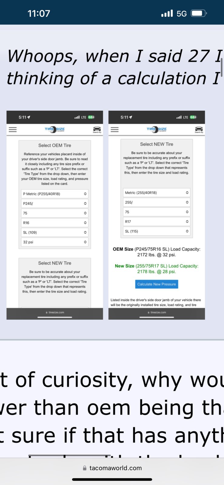

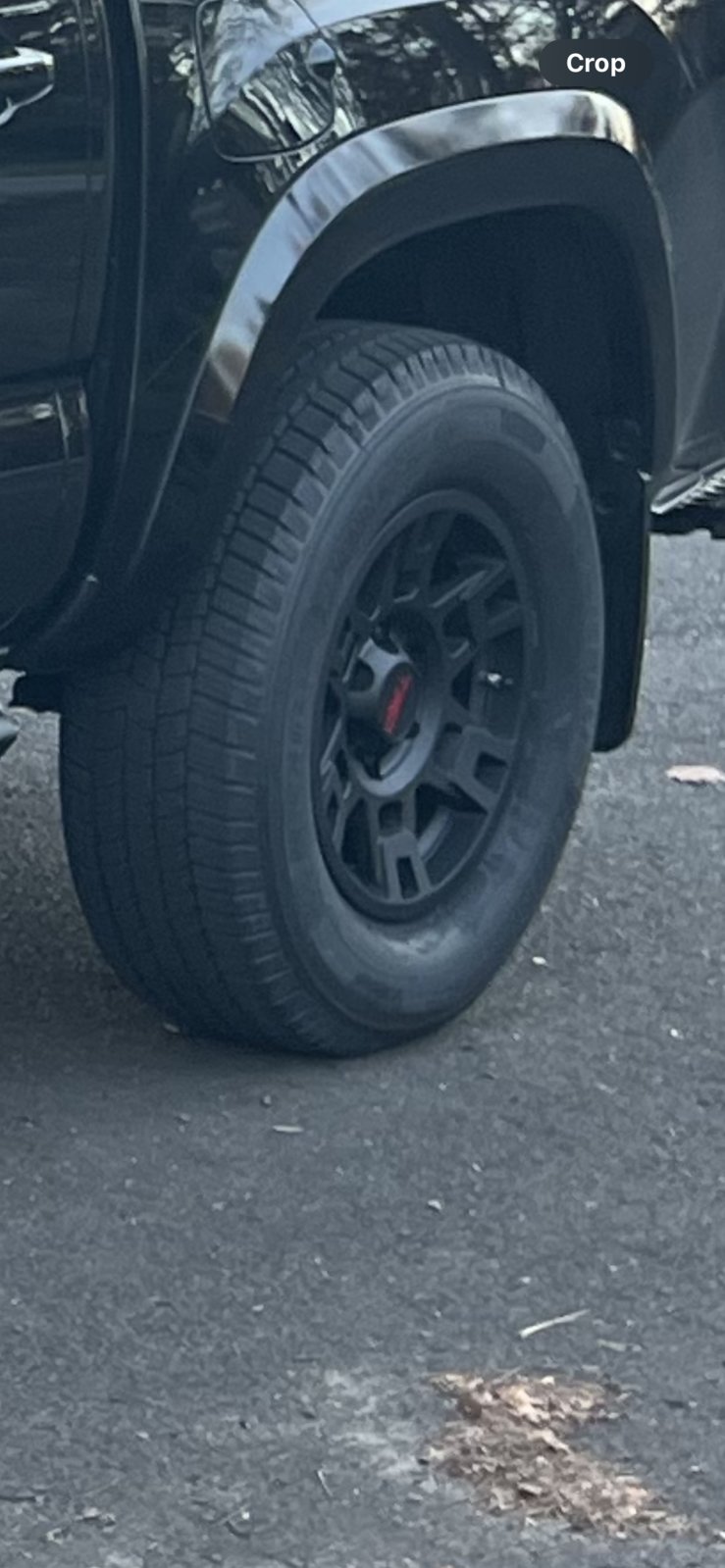

    So recently got 255/75r17 michelein defender lxt on. Did the psi calculator, says 29 psi so that’s what i set it to. Someone came up to me and said they look flat. Are they too low? I have a 16 sr5. Oem tires were 245/75/16

    For reference this is what I went off of

    I'd still run them at 32 or 33.

    Is oem not 245/70/16 ?
    Regardless, I wouldn't run them any lower than what the door jam says, nor higher than 35 psi unless I was carrying a lot of weight, or towing.
