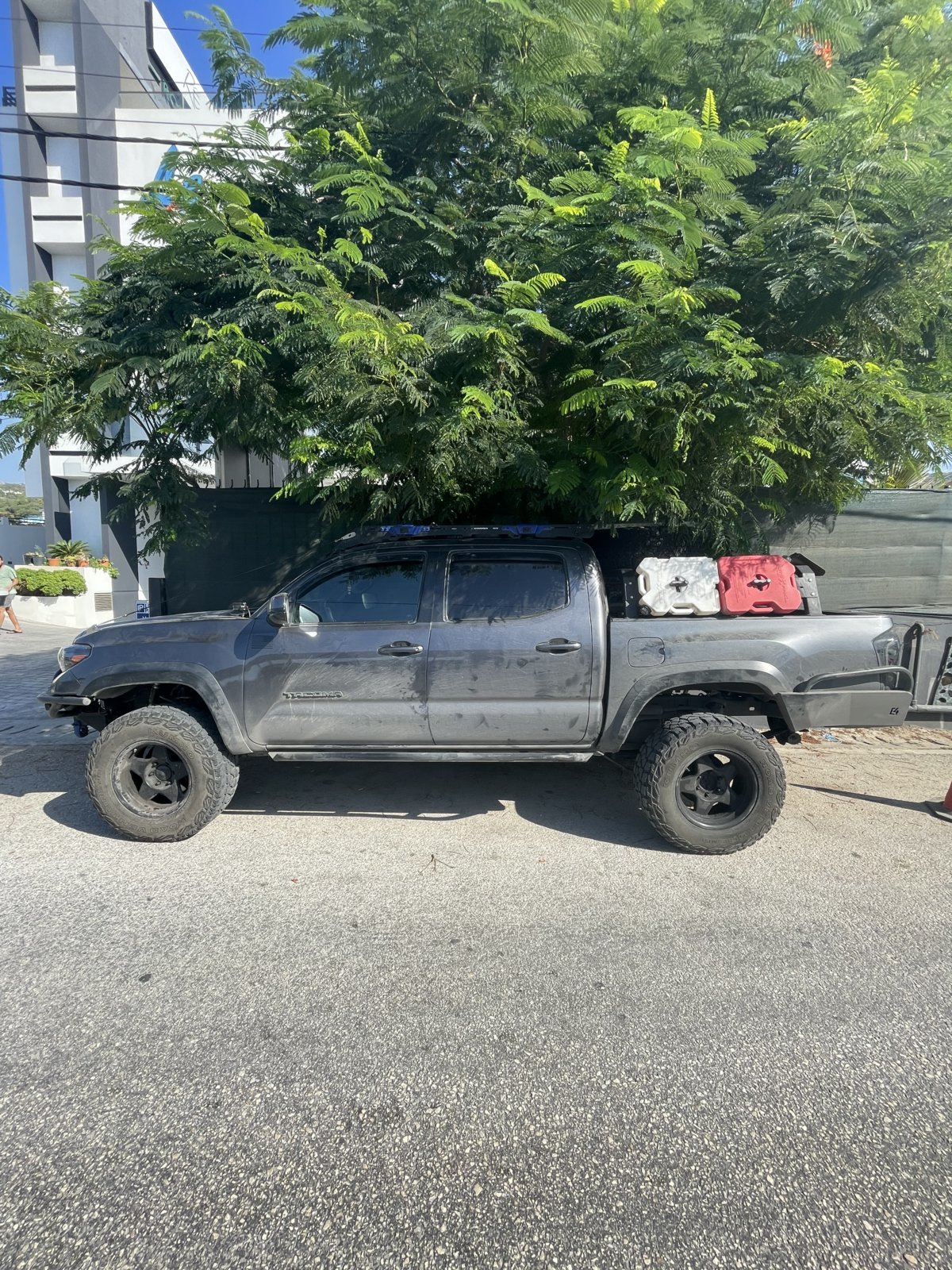

    Hi! I’m in the market for new tires and considering 255/80/17s. I’m on a stock 2nd gen TRD sport with 4Runner ORP 7-Spokes (+15 offset wheels with 265/70/17s currently). Will 255/80/17s fit with this wheel setup and no lift? Ive already removed mudflaps and I’m prepared to do so cutting if need be
  16. Mar 5, 2024 at 12:51 PM
    #696
    Tronfunkblow
    Tronfunkblow Well-Known Member
    Mar 24, 2022
    #393351
    359
    California
    2017 DCLB TRD OFF-ROAD 4x4
    MT64s, Icon RXT Leaf Springs, Topo Topper
    It should post #360 of this thread seems to be running this size/spec. However, the new Wildpeaks are a little larger in size so you might run into some rubbing but if you are prepared to cut then you should be fine. I'm on a 3rd gen so I suppose I'm not the best to answer this one.

    Nice Truck, I have the same one (color + Yr) and I want to put on the same tires. Only diff is that I am going to use SRS Ray 10's 16 X 8 4.00"/BS -12 offset and I am going to do a two inch lift in front and and RTX leaf pack in back.
    My question - do you think a lift would have helped with the rubbing (Solved it?). I'm trying to figure this out myself.
