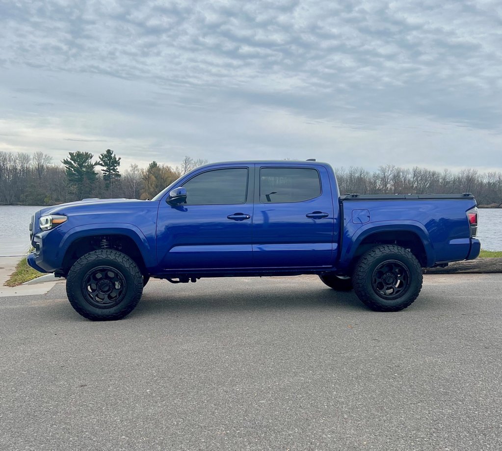

    Used to have 255/85r16 ST Maxx on my factory OR wheels. Got tired of them pulling right so I went down to 265/75r16s.
    Just went back up to the 255/80R17s on 4Runner wheels. Went with the Open Country RT Trails. They're just about the lightest ones I could find. I believe their website puts them at 52 lbs.

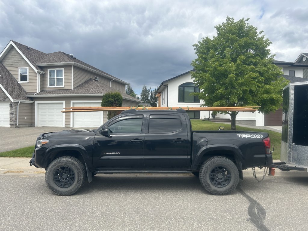

    Some Serious Tires
    25/80/17 wildpeaks at3w are also 52 pounds each.
    I run them and absolutely love them. My next set will be the same.

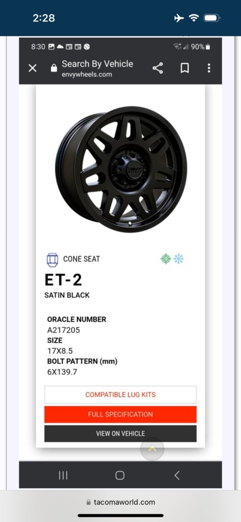

    What size tire? Is this the rim you got?

    Hey DT, ya I got the R13 satin rim. 17" +4 offset, on 255/80/17 AT3 Wildpeaks.
    Soon after I bought them, Wildpeaks came out with a 255/85/16 AT4. Had I known they were coming, I would have stuck with my oem 16" rims
    Anywho, great quality rims, comes with the centre caps, just no TRD sticker, which I bough off of Ebay.

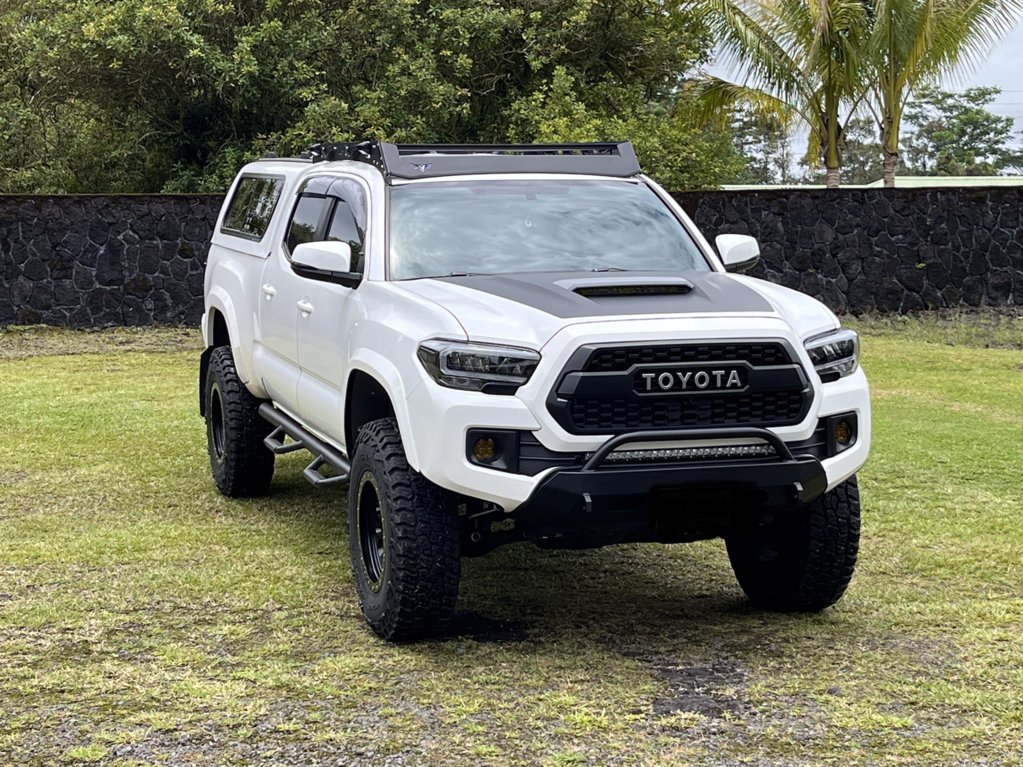

    I was looking for a photo of a double cab long bed with the skinny’s on. I’m gonna put this on my rig.

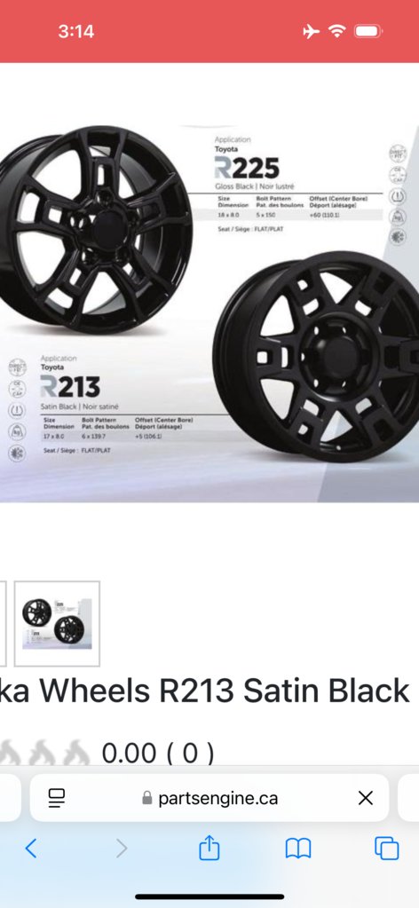

    Considering the reasons I’m thinking about new rims. I’m looking for opinions from others weather or not it’s worth going from 0 offset to +5 to solve my runbing issues at the rear of the front tires. Will it make enough difference to be able to add mudflaps and stop rubbing the cab mount? Current rims in photo and thinking of switching to the replica 213 mentioned above.
