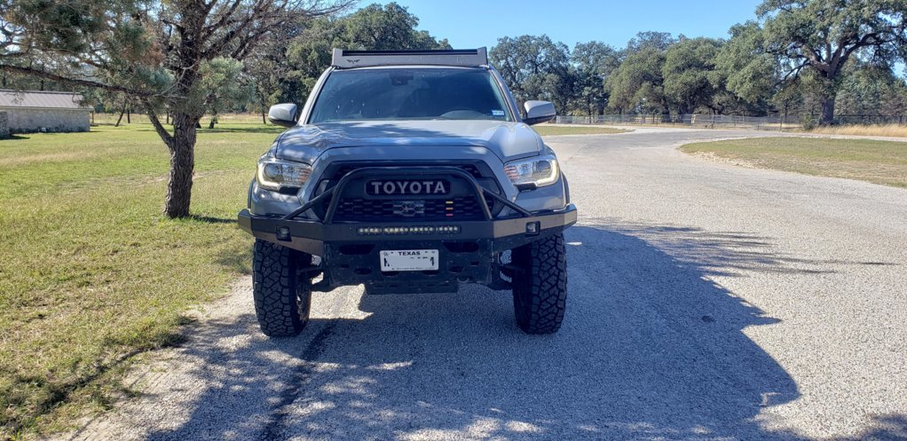

    Left front wheel slightly "touches" the mudflap in certain driving situations. Doesnt bother me one bit.
    Im at 1.75" lift in front and 2" in the rear. By the way, lifting the truck wont help with rubbing issues unless you plan to drive in a straight line and never cycle your suspension. Just how Toyota IFS works.
    For example, even if you are at 3" lift in front, your wheel still goes through same range of motion as stock, its just the wheel has a different starting point. Hope that makes sense.

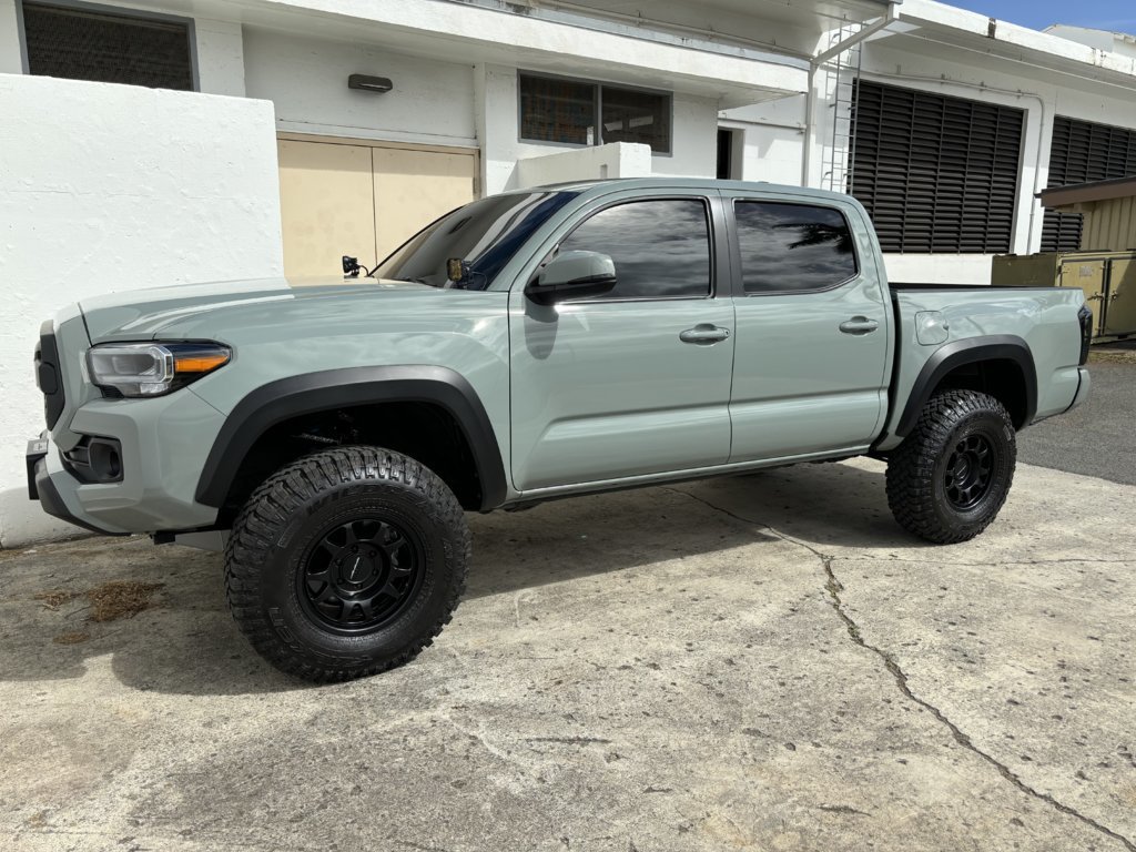

    ‘23 TRD OR 4x4, Wescott leveling kit. Has 255/85/16 Wildpeak MT tires with Method 702 wheels!

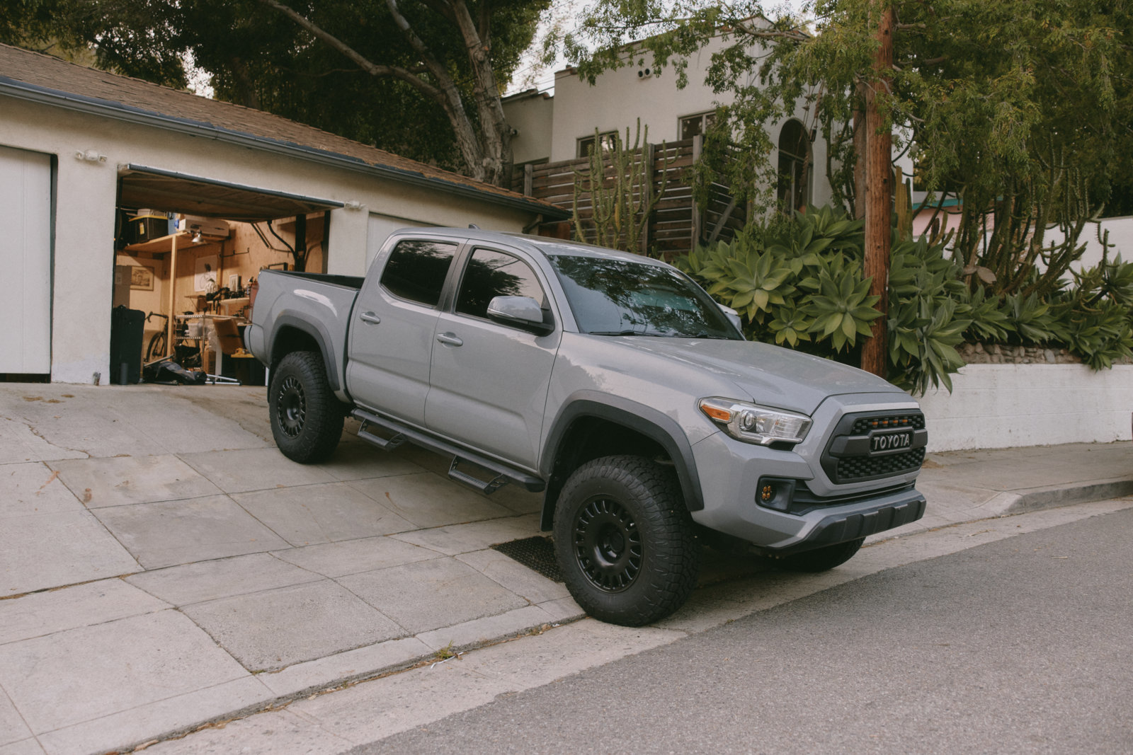

    2020 Cement TRD Sport DCLB
    17” KMC KM722 w/ Wildpeak AT3 Eibach Pro Truck Stage 2R

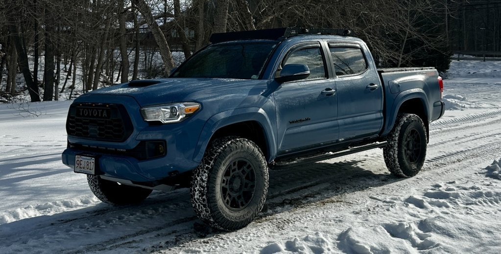

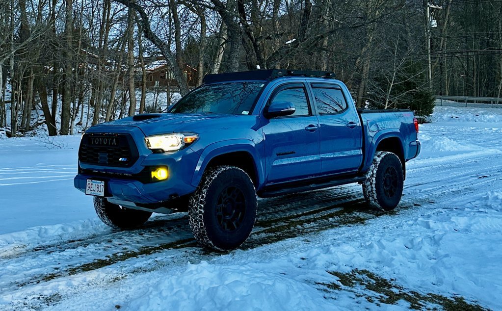

    Just wanted to share my experience putting on pizza cutters for anyone who’s considering them. I went from a 265/70/17 Wildpeak at3w to a 255/80/17 Wildpeak at4w. Long story short. They rubbed quite a bit on the cab mount, had to do a cmc a couple days after install….. Long story long, the truck is a 2020 sport dclb. Eibach pro truck stage 2r with 1” lift in rear and 2” in front. JBA uca’s and KMC km722 wheels with 0 offset. I preemptively hammered down the pinch weld, as well as heat gunned and trimmed some fender liner. That stuff did the trick for keeping the tires off the fenders but the passenger side rubbed on cab mount pretty good. Strangely the driver side cleared, barely, but cleared. The alignment was its own story but after a couple trips back to get a proper alignment I gave up on the tire shop and I’ll have to get one from someone who knows what they’re doing. What I can say is that the passenger side rubbed with 2.5* caster all the way to well over 4* of caster. Other guys may have been able to pull off these tires with 0 offset and no cmc but no dice for me. YMMV. Other than that, they look great and now with the cmc done they clear just fine. I will say, I definitely noticed the extra weight. Especially coming from a smaller SL tire. They also ride a good bit stiffer than my old at3w’s, to be expected. I have about a week left on my 30 day return window so I’ll have to make a decision soon whether or not to keep them. Still on the fence.

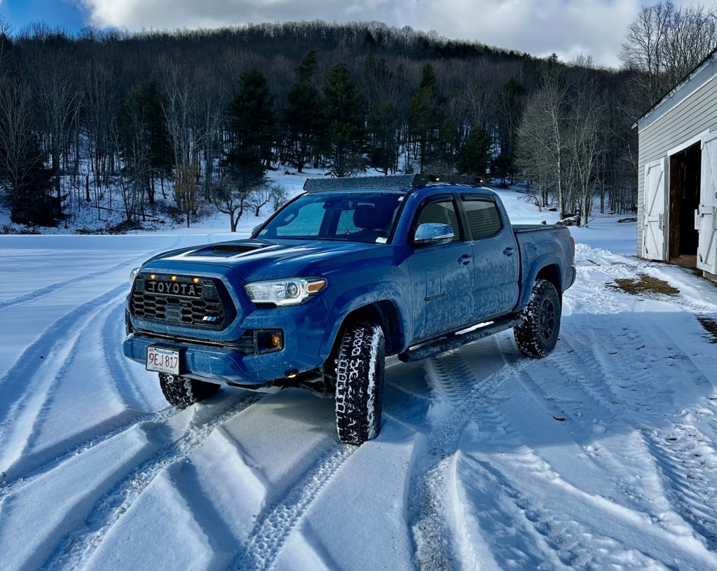

    2019 Taco TRD Sport Cavalry Blue
    2019 Cavalry Blue TRD Sport
    Bilstein 5100 on all four corners. Eibach 2" springs up front. Dakar 2" leafs in the back
    Toyo Open Country AT III E-Rated 255/80/R17
    TRD Pro wheels (knockoff) 17" +4mm offset
    Front Runner Slimsport roof rack. Lasfit Rock Lights custom fit on 30 degree mounts (printed by )
    Diode Dynamics SS3 sport fogs
    V2 Tacoma Pro Grille
