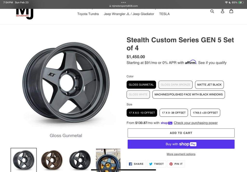

    Will 255/80/17 work with any of these wheel offset with the Trd lift? Preferably no cut and keep my mud flapsIMG_0428.png

    Positive offset should work fine. Negative will be a no go

    I run 255/70/18 with 0 offset. Tire barely clears the factory UCA. Positive offset would be no-go.
    Cbeecher likes this.
