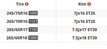

    Do you know the offset of the stock sport wheels?
    The +30mm offset of the stock 16x7 3rd gen OR wheels is the key factor that clears the 255/85/16 tires on a stock suspension 3rd gen.

    They're actually +25. The sports are +30
