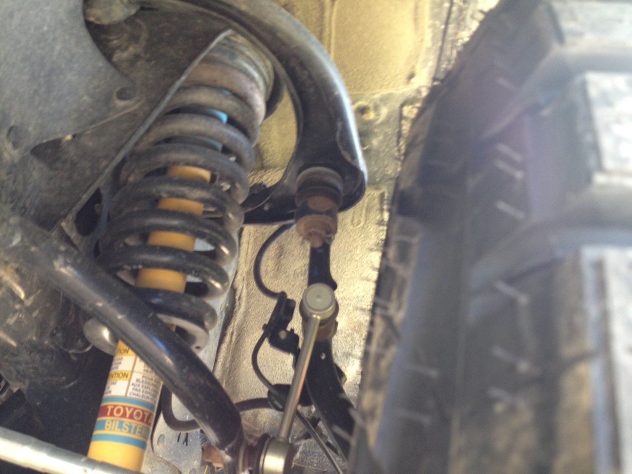

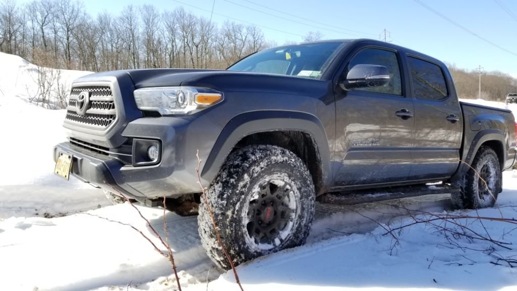

    I'm sporting 4TR SEMA Pros w/ 255/80/17 ST Maxx on stock OR suspension. Unfortunately there is a little rub, but only on plastics. I used a heat gun to bend fender liner away, I still have a little more in the back section of liner and that little hard plastic tab in rear of fender well. That piece will have to get cut out. I'll take a pic of it later
    Fuel economy loss is maybe 1 - 1.5 mpg on my (morning) commute. It's 22 miles each way, but in the am I get to experience some driving, unlike stop & go afternoon traffic ( 35 minutes vs 1 - 1 1/2 hr). Yeah, Metro NY traffic blows!

    @BastekFX thanks for posting! I don't mind doing some heat gun treatment or minor trimming. Just really want to avoid cutting fenders and such. Been there done that.

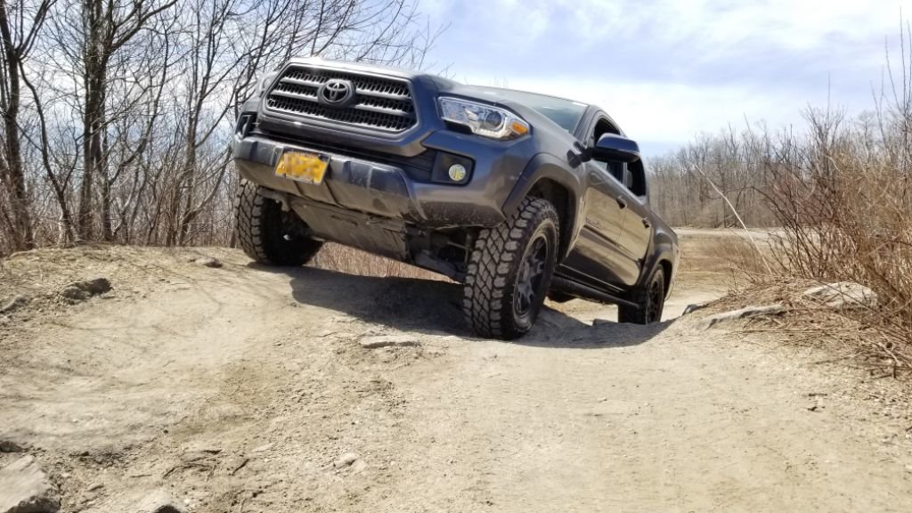

    I have the 255/80R17 ST Maxx on my GX470 nad I enjoy them quite a bit.
    My only beef is that my tire popped off my 8.5" wheel the first time I wheeled on them (only dropped to 16psi =/) which makes me quite hesitant to air down to the tire pressure I typically use when in the snow or doing any true wheeling.
    They're also a very short tire. 255/80 may be the size, but that is NOT the measurement the tire comes out to. My friend's have 285/70R17 Duratracs and 285/70R17 Wildpeak AT3ws and both are CLEARLY taller than my ST Maxx. My tires look tiny next to them. I don't mind it, but I know some people care about that sort of thing =P

    Nicely done sir! I had a feeling it could be done on stock suspension, with some minor plastic trimming/manipulation.
    I’m not on stock suspension anymore, but you’ve got me considering swapping out my SCS wheels again :crapstorm:

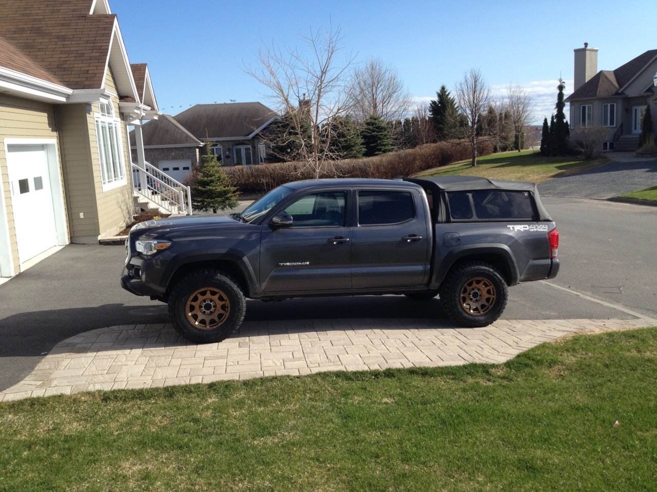

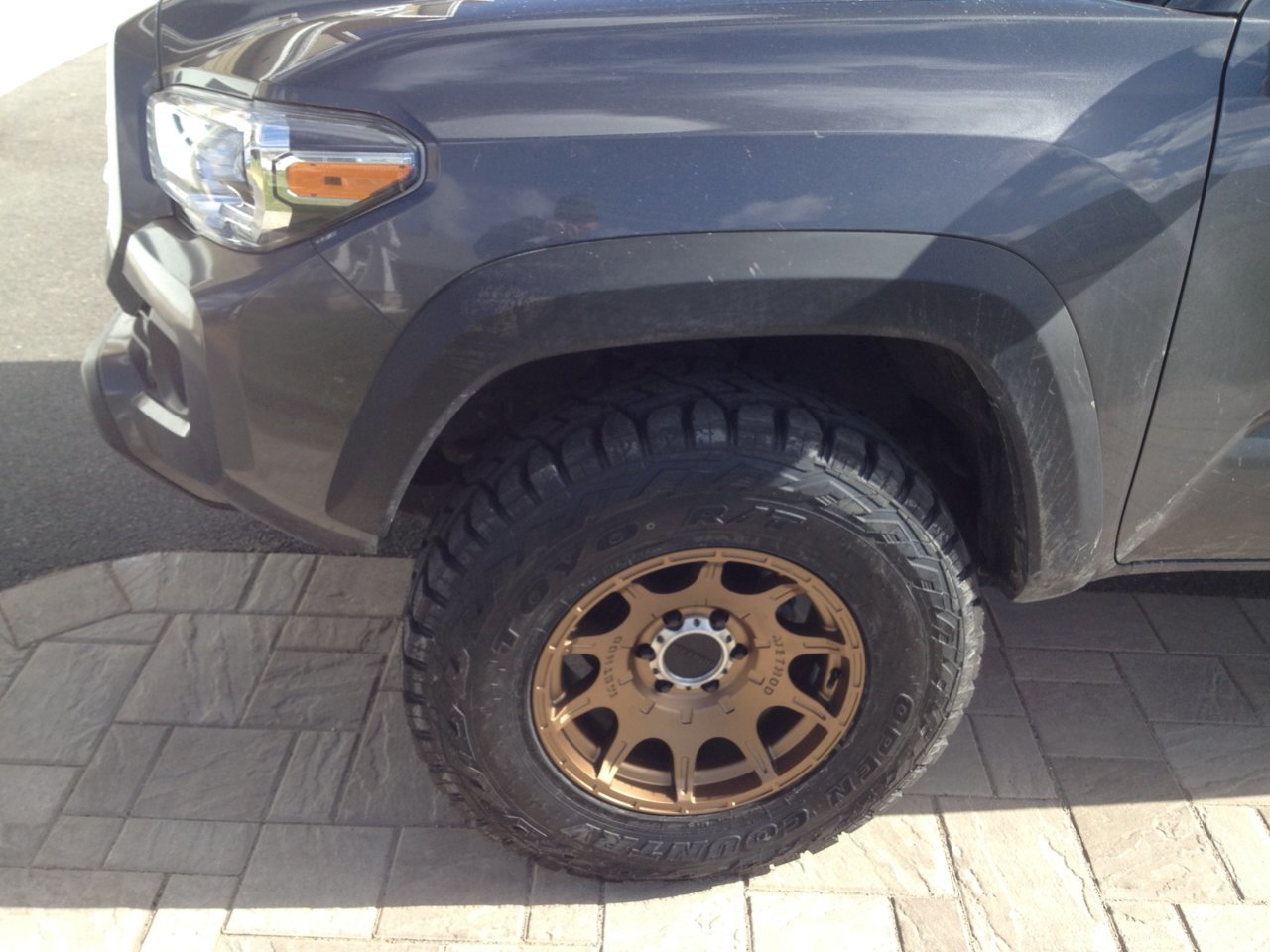

    17 OR DCSB MGM
    Bestop supertop Bronze Method roost 255/80/17 toyo open country RT Interior LED XenonPro HID low beam
    Toyo open country RT 255/80/17 on method roost 17/8.5 0 offset.
    Garage was not sure if it was rubbing we will see, but on stock offroad suspension it fits.

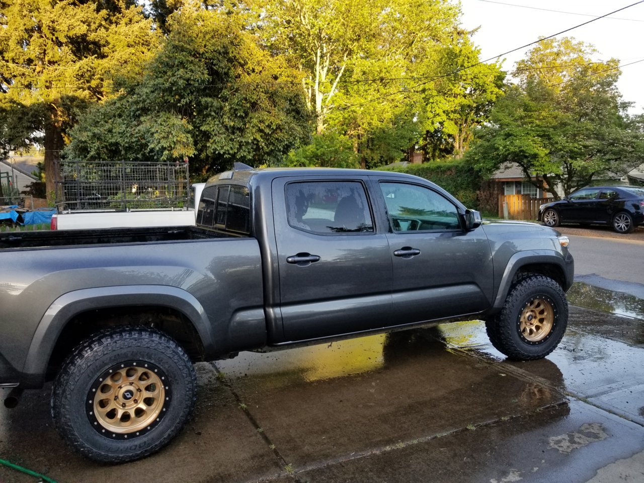

    They rub with scs rims on stock sport rims, nothing the grinder couldn't solve.

    After a little ride to the hardware store, they rub on a an angle near the plastic fender . I heatguned it and flattened it, ill see tomorrow if its better.
