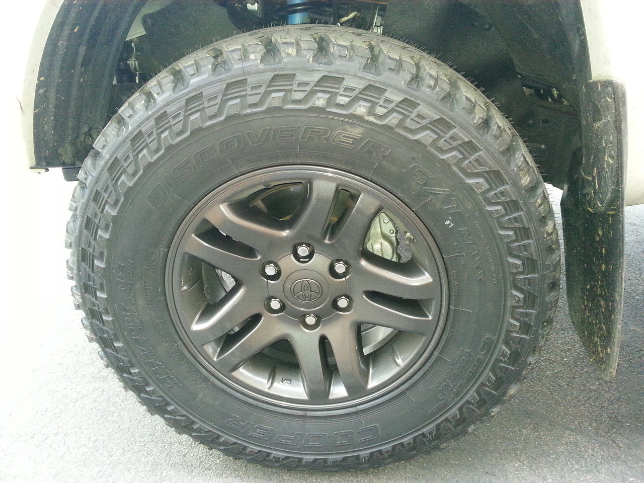

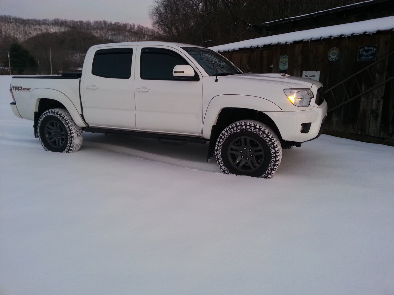

    255/80/17 with 3-2 lift, on Tundra's, still have mud flaps and no rub,20160125_175557.jpg 20160112_141054.jpg no cmc.

    See this is more of what I was expecting, no CMC with a lift. I just bought these tires and pick em up today. I still want my mud flaps :cookiemonster:

    Did have to remove the little mud flap extension on the front side of the front wheel. Mine is really close to rubbing at full lock and flex, it might depend on wheel width and offset.

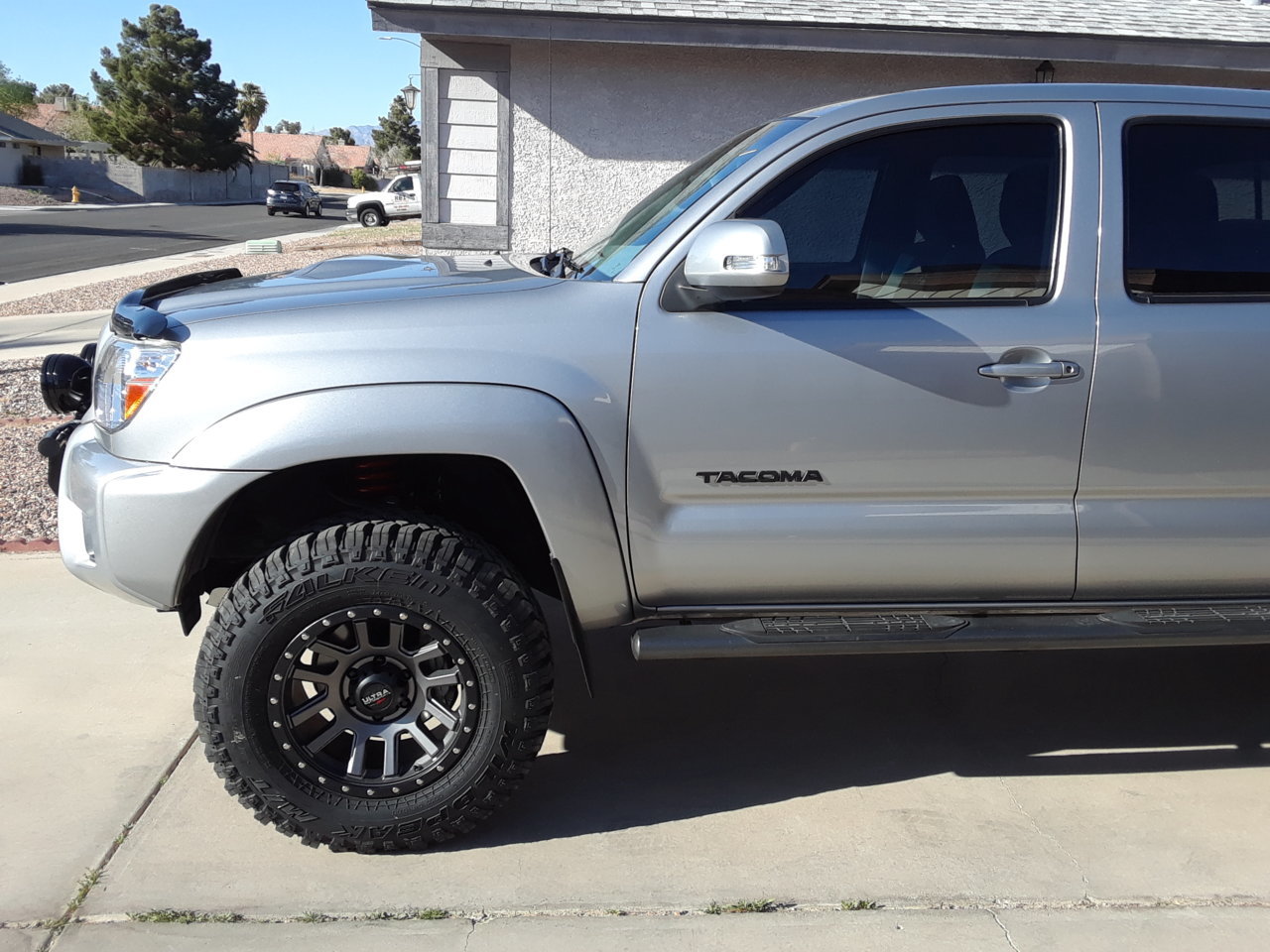

    Only rubs if my wheels are barely turned and i have to turn into a steep driveway. If my wheels are all the way turned, and I go up the same driveway, no rubbing.

    I think it's rubbing on the fender as my cab mount does not have any wear markings.

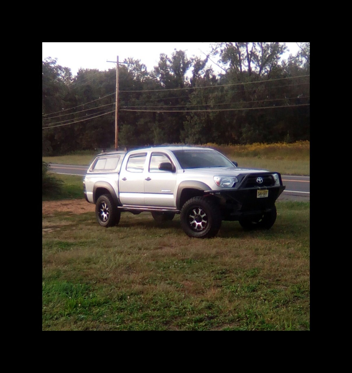

    255/80/17 St Maxx no cmc removed mid flaps

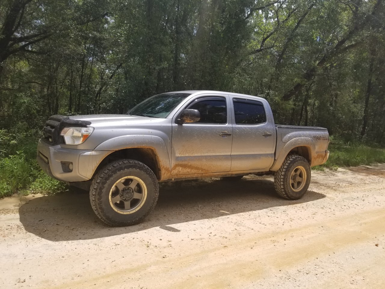

    5100's @2.5 and add a leaf. 255/80R17 Cooper ST Maxx.
    20170812_143303.jpg 255/80 17 5100 all around front at 2.5 with stock trd offroad springs. No mud flaps no rub even at full stuff front and back. Also running 17x8.5 wheels with -12mm or -10 offset. Somewhere around 4.5 inch back space.
