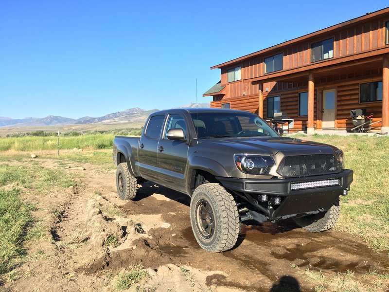

    Love that bumper. Looks good with filled in plates between the bar

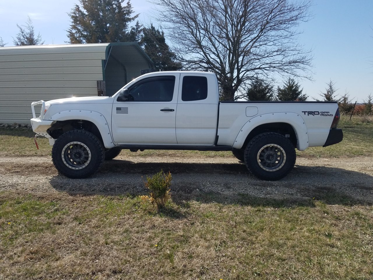

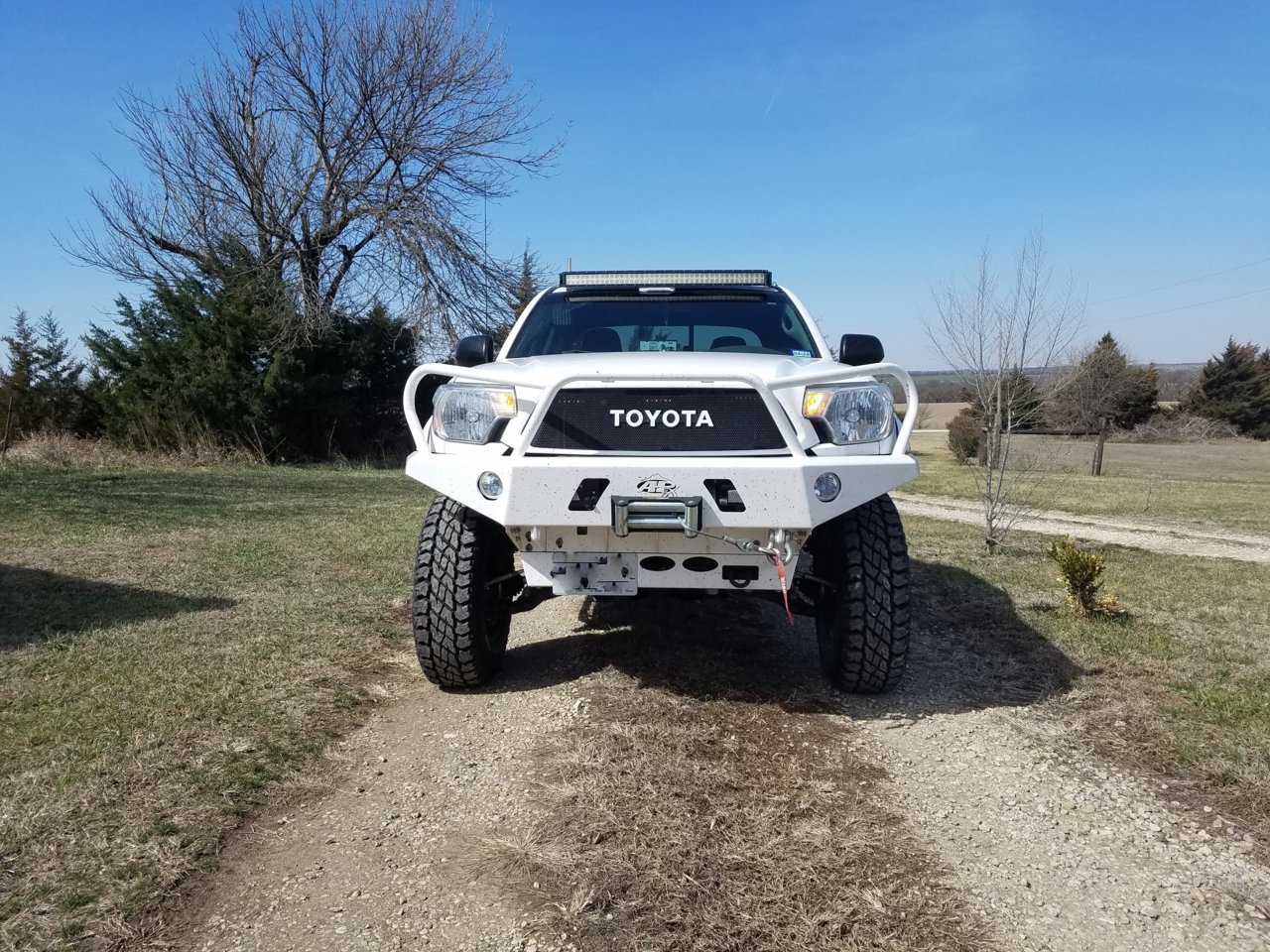

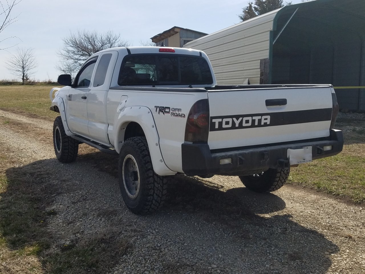

    3" Lift (ToyTech Coilovers and AAL) Bilstein 5100 Shocks Total Chaos UCAs Method Double Standard 17" BFG All-Terrain T/A KO2 (Removed) 33" BFG Mud Terrain Tires Colormatched Grill surround HomerTaco mesh grill insert Legacy "Toyota" Emblem Shrockworks plate rear bumper All-Pro plate front bumper w/ foglights All-Pro rock sliders Smoked Tail-lights DIY Steel Tailgate reinforcement Locking Tailgate handle Tint (15%) w/ sunstrip Tyger Tonneau cover (Removed) Bestop Soft Topper Bushwhacker colormatched fender flares DIY 8-ball shift knob DIY Amber LED grill lights DIY Debadged WeatherTech floormats Sudued US Flag door decals T-100 style tailgate decal Two way radio w/ 3' whip antenna Warn 8000lb winch CalTrend Neoprene seat covers DIY Bed tie-down anchors
    The only other tire I considered is the BFG MTs. I just put these on my 8.5" wide Method Double Standards. Haven't aired them down yet though.

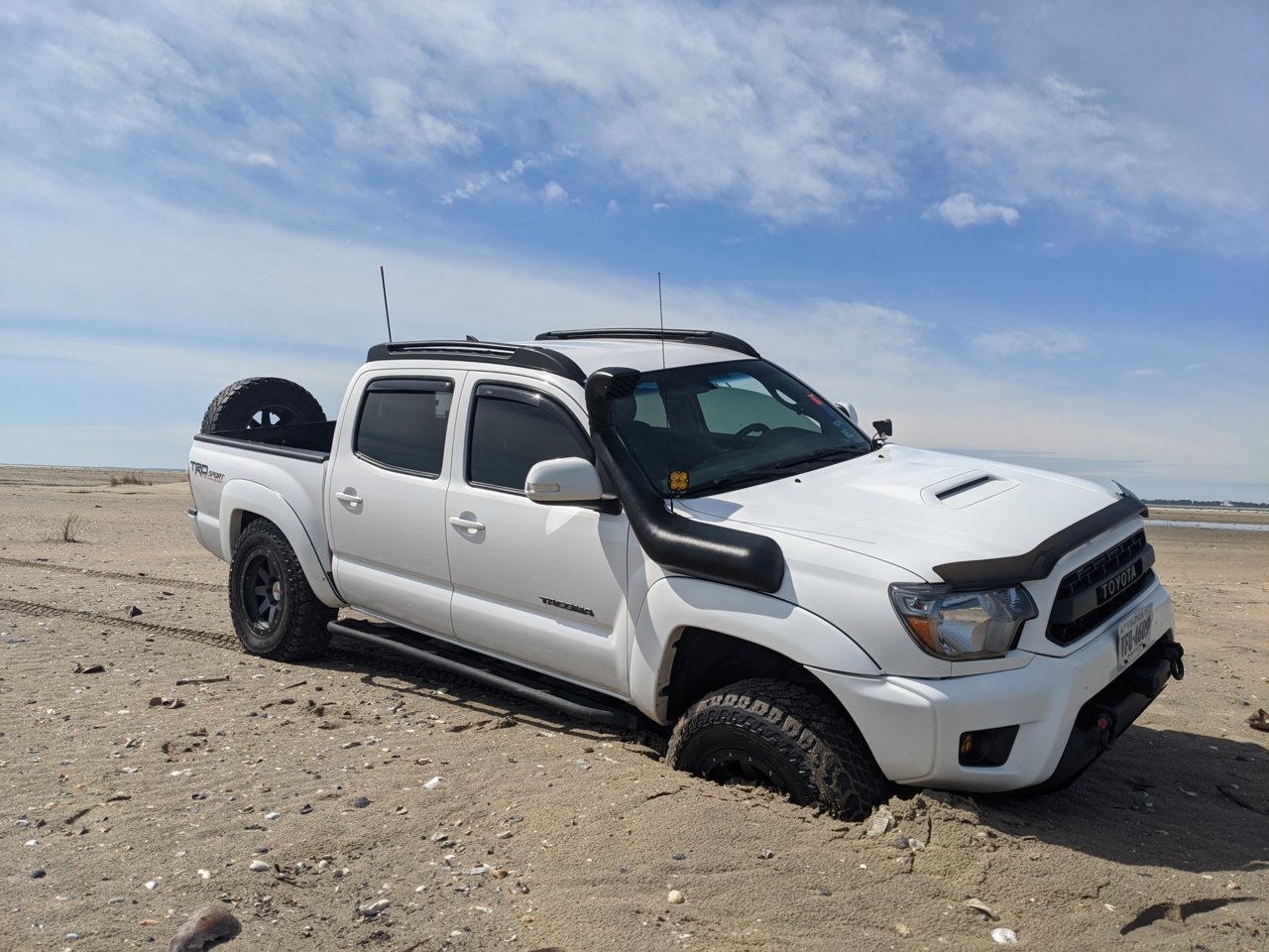

    I've gotten the tires down to 20 with no issues. Haven't really needed to go lower on my beach. The tires actually perform great in the deep ruts, even with them being a "skinny".

    I've been down to 14 on sand with no issues. Now, I don't go bouncing off rocks or put excess pressure on the bead or anything. I usually stay around 18-20 and have never been stuck in sand. Well, there was that one time with the sink hole...
