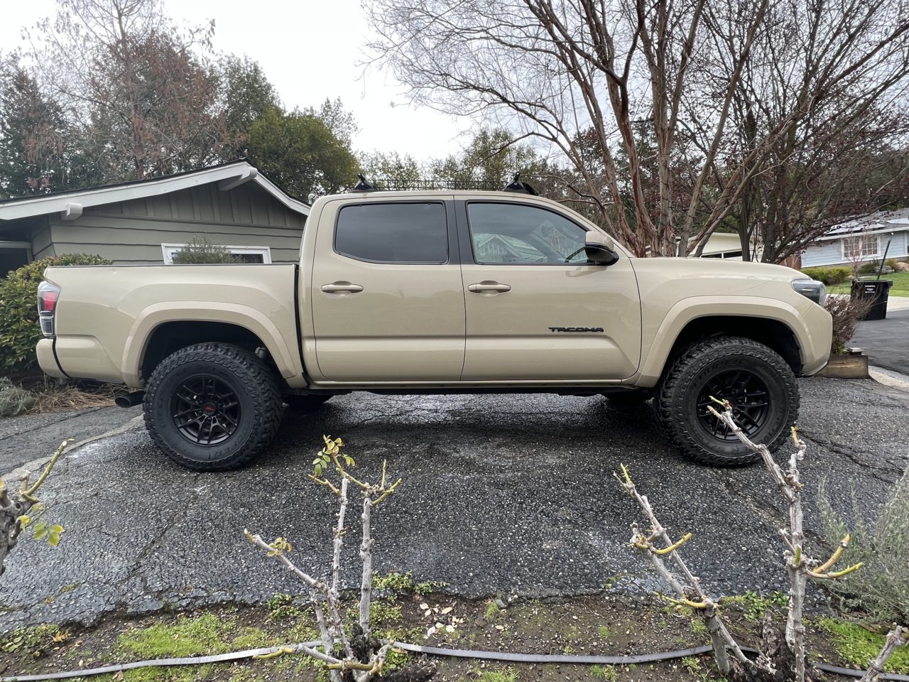

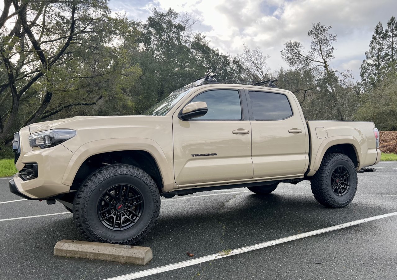

    Just mounted up!
    255/85/R16 cooper discoverer ST Maxx
    stoked!
    im on Falcon sport level suspension with Camburg UCA’s
    Correction…..i do have some rubbing so i’ll be moving my falcon shocks to the top setting for a little more clearance. Hopefully that solves it.
    Its possible my wheel spacers are causing the rubbing so i may take em off and see if it still happens

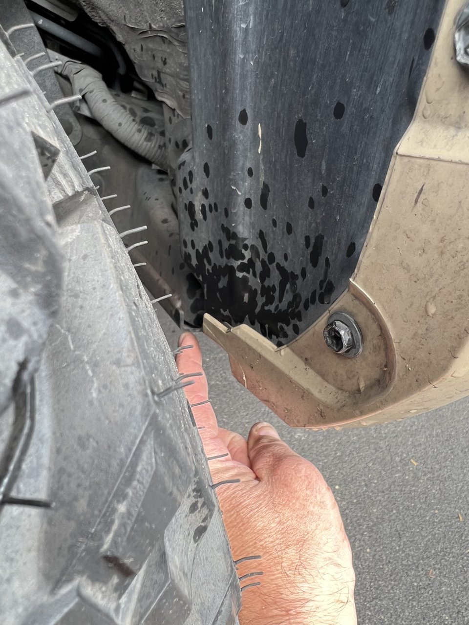

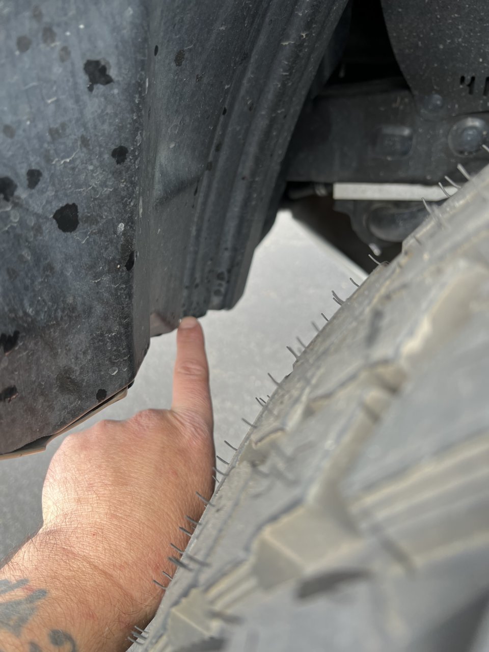

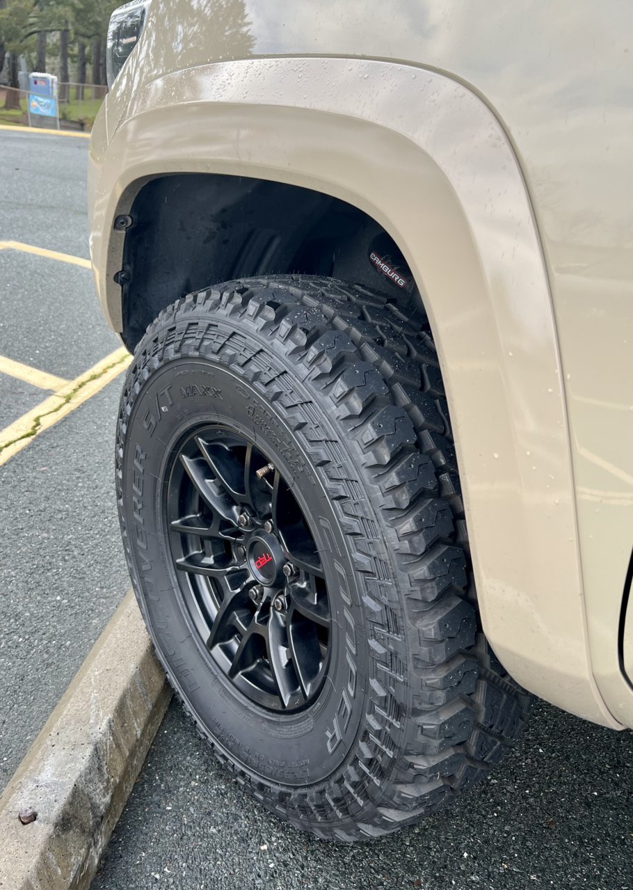

    At full lockturning right, i rub here:
    at full lock turning left, i rub here:
    so im hoping once i adjust my shocks in front to top setting, it’ll clear. But when i have that done, im just going to have them do a cab mount chop and im going to massage the front fender liner with my heat gun and that should fix that one.
    It only rubs on bumps in lock. When turn on smooth road slowly it doesnt rub.
    Super annoying but itll get dealt with soon so its whatever

    I’m not an expert but changing the ride height likely won’t help. Your UCAs may need adjusted. With your spacers what’s your effective offset? That’s probably a factor as well if you’re in the negative.

    yeah i think it could be my spacers. Im going to try that first.

    I was gonna say, lifting it higher won’t help you clear your tires. Unless you plan to never cycle your suspension.

    100% it’s your spacers. It pushes your wheel out. I’m running sema wheels (+4mm offset) and no rubbing even on stock mudflaps at full stuff.

    i took off my spacers and yessir, that was it. No rubbing. As a precaution i used my heat gun to reshape my fenderwell liners, and took my grinder to my cab mount corners and took 1/4” off, then painted em with rustoleum. At some point I’ll just get a cab mount chop so its sealed up on that corner which looks alot cleaner, but for now at least there’s no way it’ll rub. Very happy now- rubbing is a god awful sound! Lol

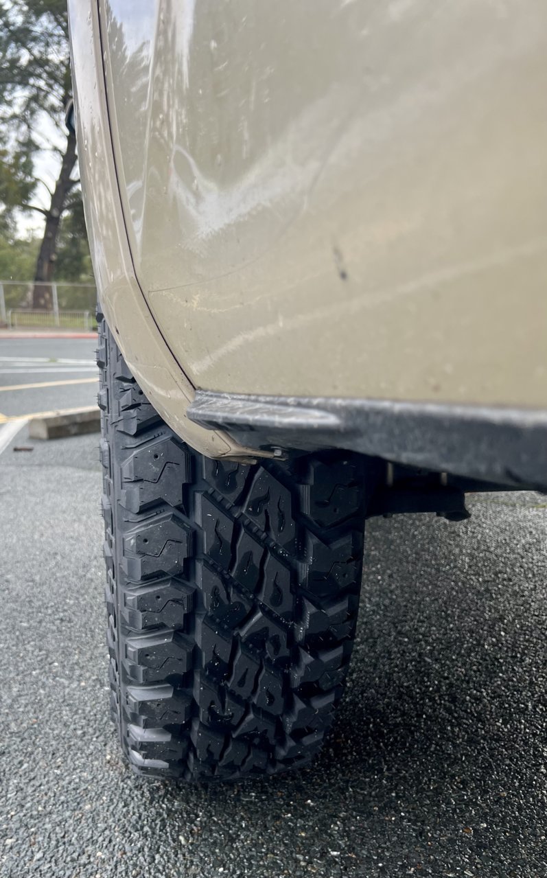

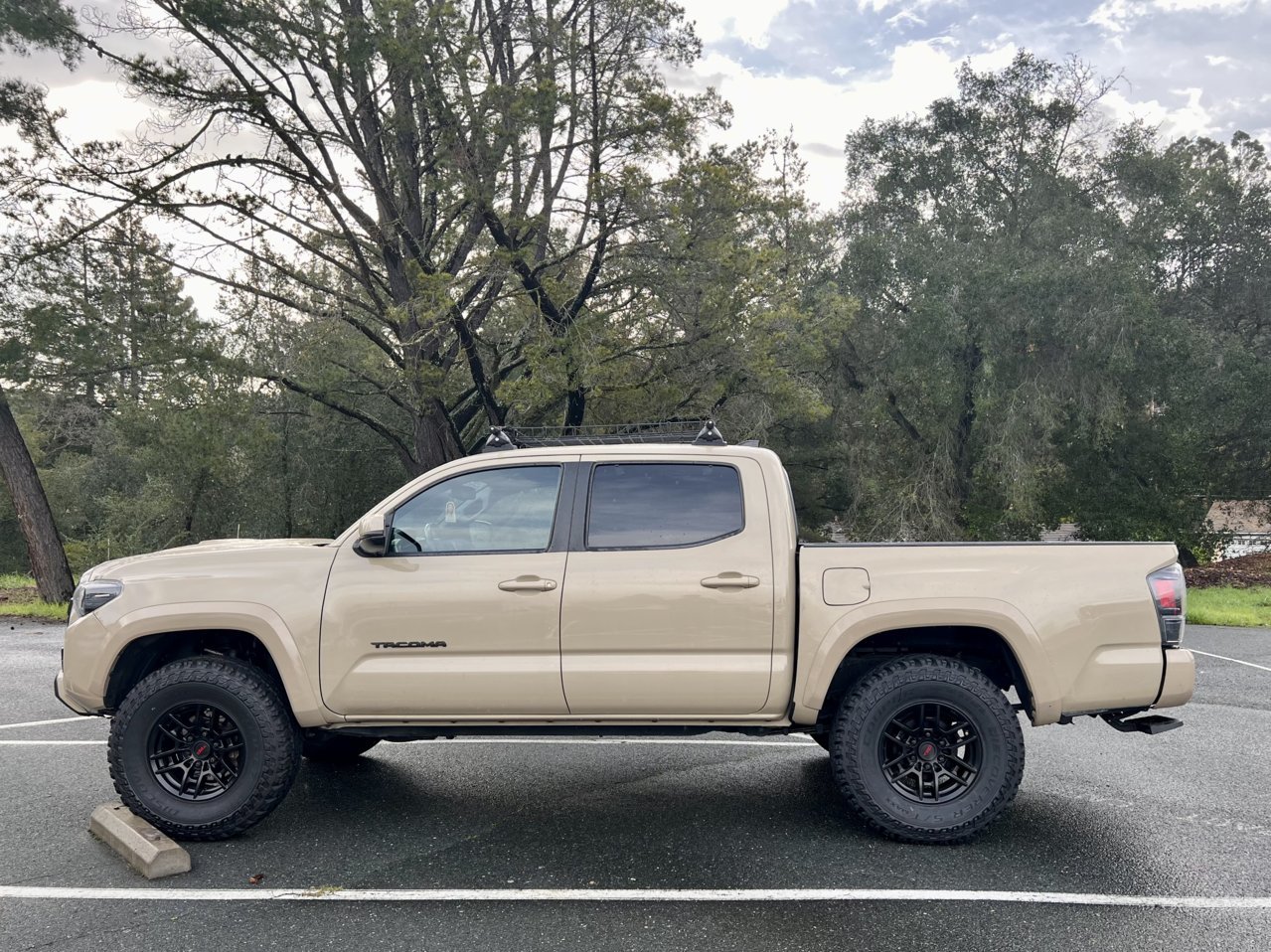

    Loving these new shoes!!!
    255/85/R16 cooper discoverer st maxx
