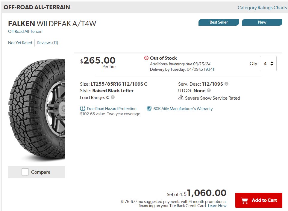

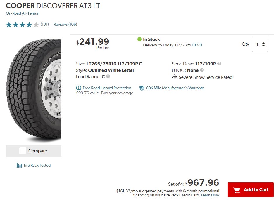

    Ok, guys, I have been debating in my mind for the past week whether to go with 265/75r16 or 255/85r16, both would be load range C preferably.
    Only tire I see available in the above spec are:
    For 265/75 r16 Load range C:
    For 255/85 r16 load range C:
    While accepting the ride quality of them would significantly change compared to the factory non-LT tires, however I am still not sure how much hit would they each has on MPGs, if any one would chime in on how much impact did your 255/85r16 or 265/75r16 (please specify your load range too) have on your tacoma compared to stock tires that will be much appreciated. Thanks in advance!

    The Falkens are larger diameter (33.1" versus 31.6") , so you'll potentially gain a bit of MPG on the highway due to the 4.75% increase in distance traveled per revolution of your engine, but you'll have a bit of a negative performance hit in town. Also note that the description of the Falken is "Off-Road All-Terrain" and the Cooper is called an "On-Road All-Terrain." Those descriptions might be a better guide as to which is the better choice for you.
