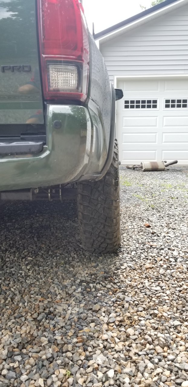

    Here's a pic I just took of mine from the back. I have stock TRD Pro wheels (7", 4.5" BS) with 1.25" spacers, which makes it an effective 3.25" BS. I plan to put 1.5" spacers to make sure my tires don't kiss the shocks, so I'll end up with an effective 3.0" BS

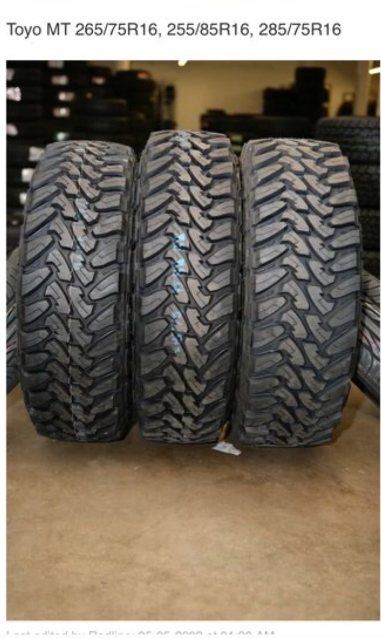

    Have you seen this one?
    I found it on page like 673 of a tire thread the other day lol

    Right!? I found that pic and was like damn that’s it.

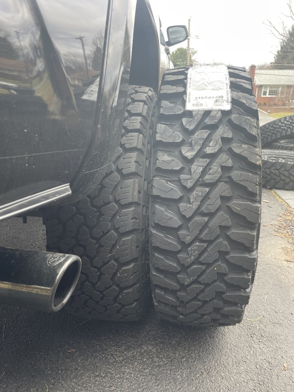

    I just purchased 285/75/16 Yokohama Geolandar g003’s. I currently have 265/75/16 General Grabbers on the truck.
    I thought taking this picture might be helpful to some people:
    Left: 265/75/16 General Grabber ATX
    Right: 285/75/16 Yokohama g003’s

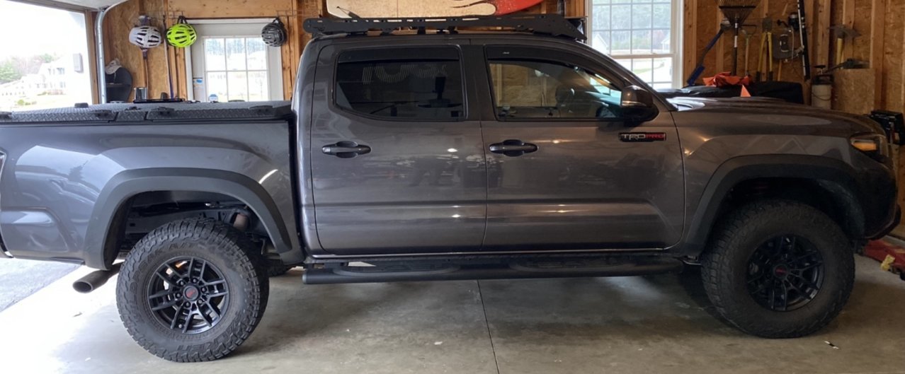

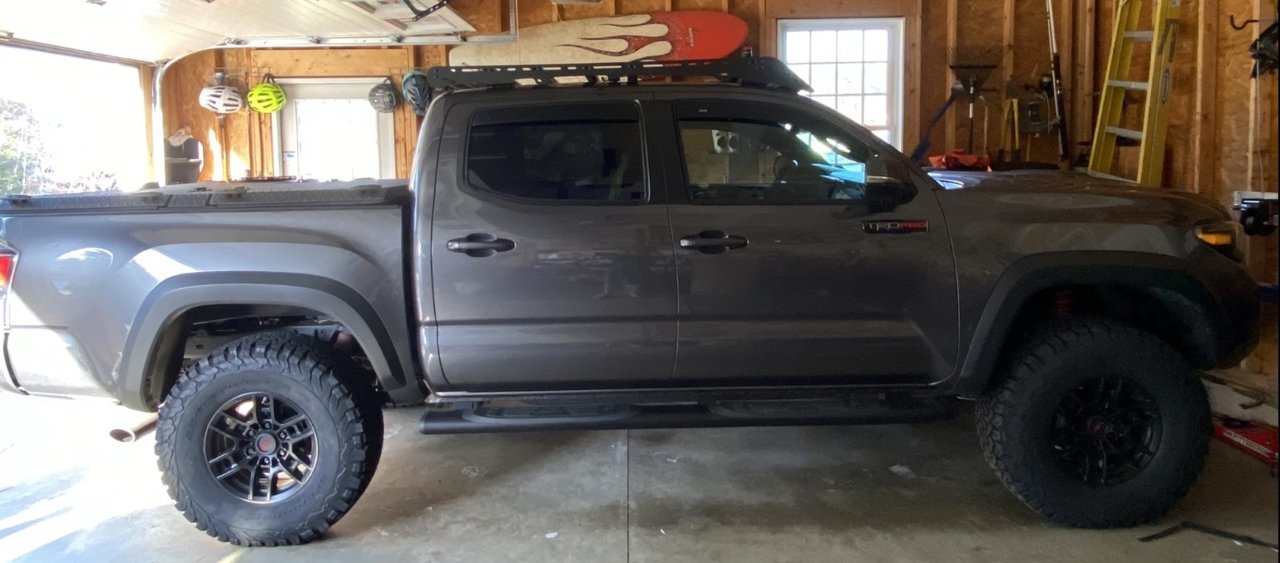

    285/75/16’s are finally mounted. Yokohama Geolandar g003’s.
