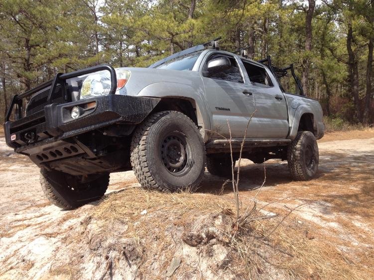

    I am super happy with the Toyo M55 in 255/85r16, considered a commercial traction tire. Somewhere between All Terain and a Mud tire. Great on the highway with rain/snow, strong and capable offroad, wear like iron. Perfectly suited for overland abuse. These are def on the tall side at 33.5inches. This tire size is perfect on a 7in rim 4.5 backspacing. Mine are on a set of tundra 16 hole steel wheels. No rubbing with a 2in lift even when the the trucked fully loaded for adventure.

    More photos please. I have been wondering about this tire.

    They look nice! Glad you made the right choice

    is this your truck? if it is what PSI are you running them @

    Nope, not my truck. I run them at 40psi highway, 28 psi forest gravel roads, 10-18psi sand-trail respectively. They have tough sidewalls and can really handle low pressure.
