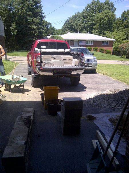

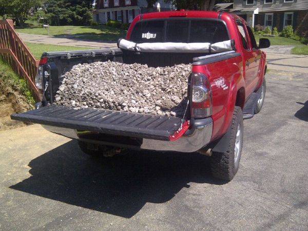

    I run the Cooper S/T 255/85/16 Load range D. Did some landscaping at my parents house in Pittsburgh area. Loaded with 1500 lbs of limestone and the 2000 lbs of block. I have the tow package and the Firestone Ride-Rite airbags with the Daystar cups. Inflated to 58psi as the compound is pretty soft. The plys definitely help when cornering.
