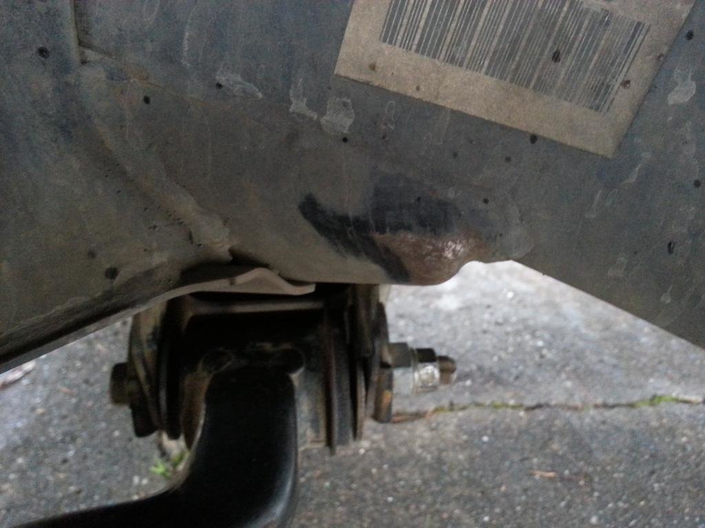

    I can get frame rub at full turn, but a set of 1" spacers takes care of this. Granted my shocks need replacement so I probably have some excessive body roll, but the spacers give a bit nicer breathing room all things considered.
    This is what I'm talking about:
