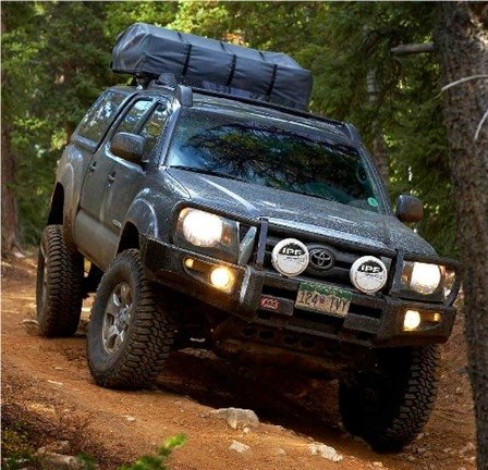

    Are these 255's? I can't really tell so I thought I would ask here.
    Thanks

    I dont think so, but they could be.

    Thats what im goin with in a couple months, what did u give for em?
