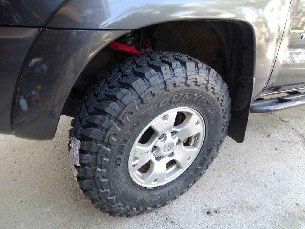

    Later today I will be. I test fit the tire/wheel yesterday.

    Will do. My test yesterday was to turn steering wheel both ways and compress suspension. I only had a curb to flex on, so I could not get full compression but it appears it's going to be okay.
