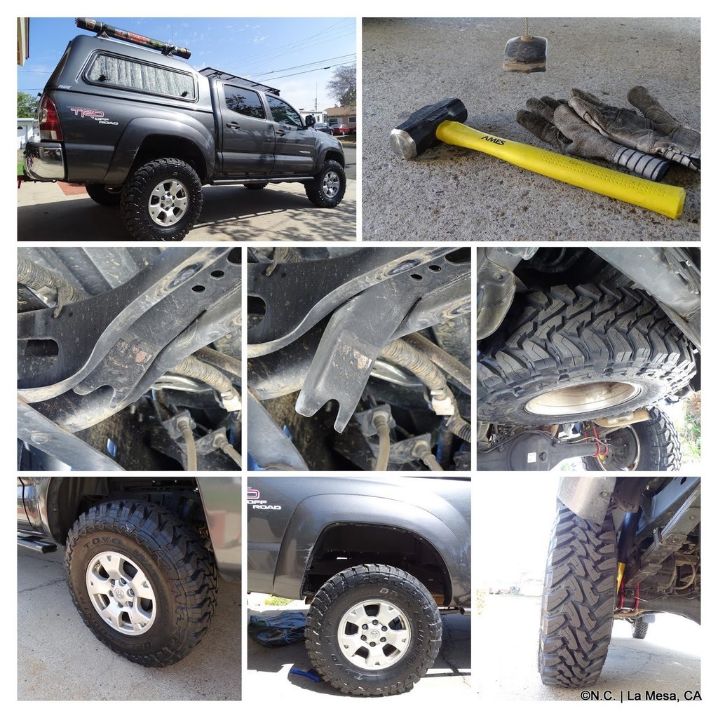

    1. Have any of you stuffed a 255/80/17 in the stock spare location?
    2. I have OME/887 front with tsb rear and 1" block for my lift. Will a 255/80/17 on the stock spare wheel mount on the front without clearance issues, or will I need a wheel with more backspacing. Running iShock UCA's.

    To fit a 33" spare in the stock location, use a 4lb. sledge to make the tabs flat and it will fit perfectly. I got pics in my build thread...
    Edit: added pic.
    YotaDan and 14489 like this.
