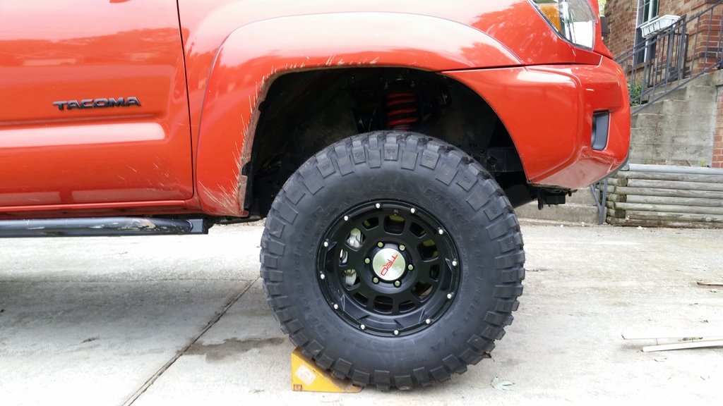

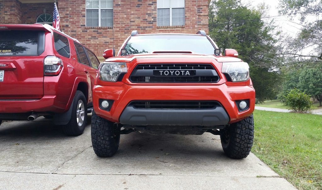

    I've driven 60 miles on these so far, so it will be a week or so before I have any results. Tested on the interstate today, and at 70mph on the speedo I'm actually doing 73. There should be about a 4-5% difference in odometer readings I'll have to figure in to get my adjusted fuel mileage.

    Oh wow not bad, do you feel at all sketchy with the narrow tires? I live in SoCal so a lot guys love the wider style tires but I don't like having to trim everything and then loose mpg. Trying to get a comparison between low and wide and tall and skinny

    Doesn't seem any different than the 265s did as far as tracking and stability go. I was on a pretty deeply grooved interstate today and had no wandering and no movement in the steering wheel.

    Oh wow that's nice to hear, what kinda wheel is it mounted on? You have 255/85/16 right

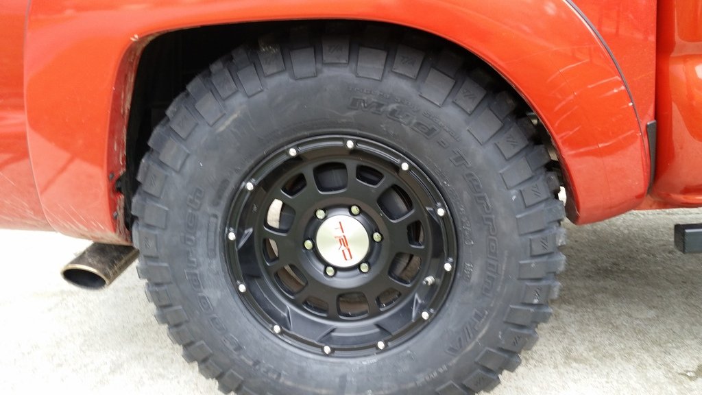

    Yup, 255/85/16 on the TRD Pro simulated beadlocks. I just have the rings removed from the wheels.
