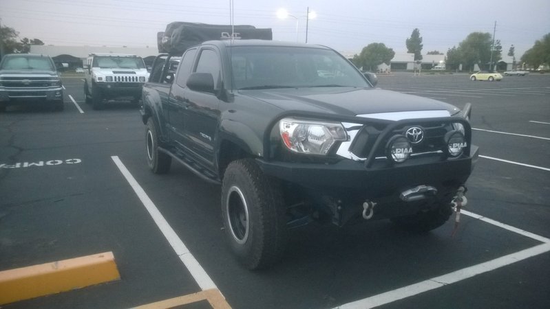

    Cooper S/T 255.85.16 D image.jpg

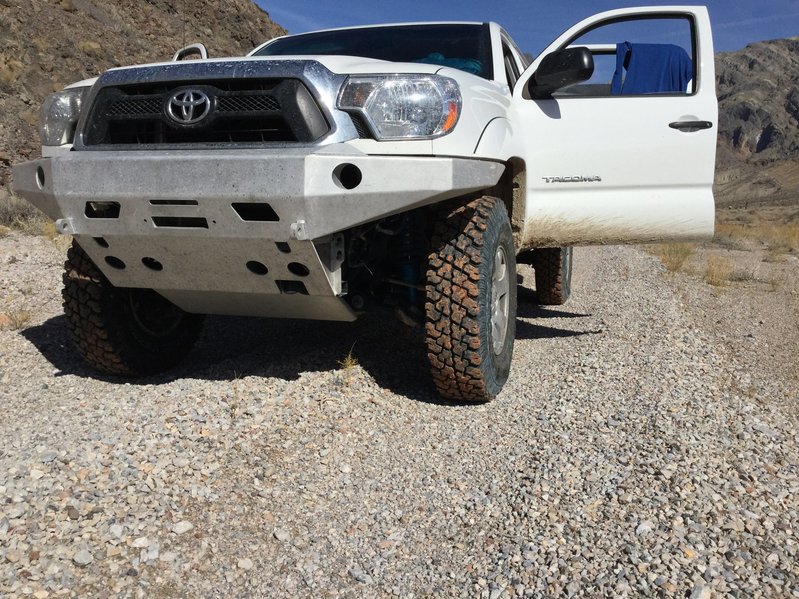

    Cooper ST on 8x16 Method Countersteer wheels, 0 offseSkinnies!.jpg t.

    I have had 255/85 Cooper ST tires for about a year, but have been driving on the 265/75 DuraTrac tires almost exclusively. I like the DuraTracs, great traction but they get chewed up pretty good in the rocks like Rug Road. I suspect they are soft compound.
    My experience with the 255/85 Cooper ST has been mostly on the highway and it is all good, they are quiet, ride smooth and I have had no "squirming around" that some report on 255/85 tires even at 32 PSI inflation. The wheels currenty on the Coopers are 8x16 and not optimum offset so I get some rubbing. I have yet another set of wheels that will be perfect for 255/85's - the first gen alloy wheels but they are getting powder coated this week.
    Back to the 255/85 Cooper ST's: What I did notice with the taller tires was loss of torque, so I swapped to 4.56 gears and it is like gaining 50 HP and 50 ft/lbs of torque. My truck is kinda heavy and not my daily driver so fuel mileage is of little concern to me. My truck has the V6 and auto transmission.
