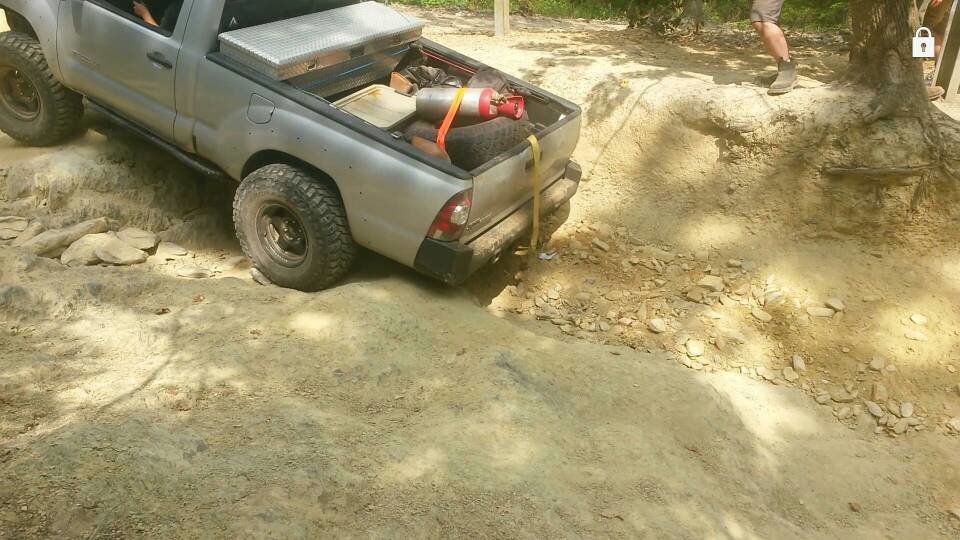

    Low and slow.. chopped up on 35s
    315 STRUGGLE RUB.. YOLO

    The 315/75R16 would be great in sand and being nearly 35" tall gives great roll-over for large obstacles. But you need to cut fenders and flares, pound pinch welds flat, do a cab mount chop, etc. A big mod for one more inch of ground clearance over 255/85. To each his own.

    315s are worth it to me, 255/85s are just real small when actually on the truck being compared to 315s. And mine were way cheaper than my 255s.. annnnd I don't really care about chopping my pile up

    Pretty sure that's the whole point. They're supposed to be smaller. I haven't had to modify my wheel wells at all, just took my mud flaps off.
    I think a lot of people care about not chopping our nice trucks up.
    :stayontopic: This is not a wide tire thread.

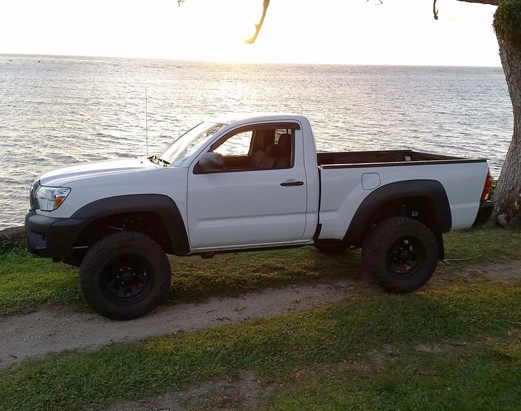

    I have 265's on my truck which I think are 31.8 or close, and wanted a larger diameter like the 255's I believe are 33.2 (I could be wrong). To me, the 265's are a little too small for my liking. The skinny look has grown on me. This pic shows how small 265's look.
    *please correct me if I'm wrong on tire sizes.
